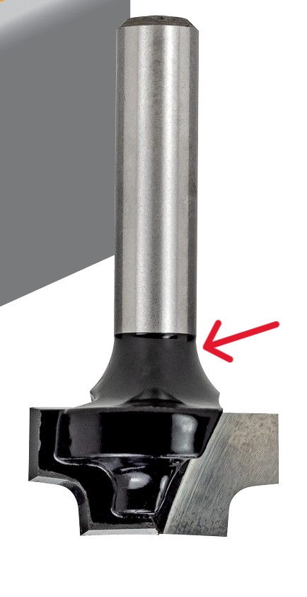

Less of an issue in the CNC world - if using bits that have a smaller shank than cutter diameter, be careful not to pinch the radius where the diameters change in the collet. It will loosen as soon as it starts cutting. Photo not a great example but hopefully clearer than my typing.
