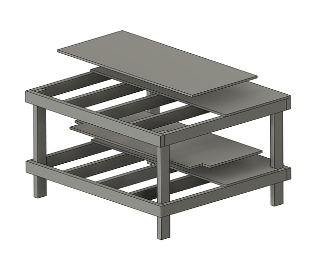

Just been working on the design for my Lowrider table.
I am trying to keep it as simple as possible as I am not great with woodwork and don’t have access to many tools, I’m planning on buying a decent mitre saw for the table assembly. So basically making the frame with 2x4 and topping it with 18mm Ply with the overall size approx 1600mm on Y and 1425mm on X to give a workspace of half a sheet.
As this is the first time I have designed a workbench of any kind I would welcome any suggestions to changes to the design below.

I’m assuming you’re planning on joining the frame with screws through the face of those 2x4s into the legs?
If you don’t have a circular saw (the handheld type) then IMHO, that would be a better investment than a miter or chop saw. You can still cut pretty straight with a simple jig across 3.5" and you will be able to break down large sheets to fit your projects with a circular saw. Here is a construction technique I like and I used it on my LR table:
Comments I would give are:
  1. You will probably want to be able to sand high spots under the spoil board. Or use a hand plane if you have one. If you don’t have a power sander, you’ll want one soon anyway.
  2. The table is going to “rack”. If you imagine looking at one side, it looks like a nice rectangle in CAD, but it will want to turn into a parallelogram in real life. Adding one diagonal stretcher along the back and another along one side will make it much sturdier. Even smaller material, like a 1x3 would do that job fine. It just has to resist getting longer or shorter while the table tries to rack. Alternatively, you can put some corner braces in to make the corners more rigid. Those are a little trickier to make until you have the CNC.
  3. I’m tempted to say you don’t need so many cross braces, but they won’t hurt and they will hopefully be inexpensive. I’m also not sure how thick the spoil board and shelf is going to be, and if it is thin, then it will sag if you don’t have many cross braces.

I’ve built a lot of tables and “benches” with a similar design, although I would add another perpendicular 2x4 to each leg (so that it makes an “L” when viewed from the top"). This will go a long way to mitigate racking and will also give you more meat for your screws to bite into.
I also agree with Jeffe’s advice on adding going with a circular saw over a miter saw in terms of getting a much broader range of use and overall value for your money. I’ll also second the notion of diagonal stretches if you don’t plan on adding perpendicular 2x4’s to the legs. Even considering the strength that will come with screwing the plywood sheets onto the frame, which very well could be enough on its own. But just remember that this is the one step in the building process that you only want to do once.

I would add one caution:
If those are 2X4s in your diagram, the ones on the end being vertical might make the table a bit too thick for the LR. The build instructions state that the table should be a maximum of 4" thick. A 2X4 is 89mm wide, plus your 18mm plywood makes 107mm, which is greater than 4" (101.6mm) You may end up with clearance issues for the LR2 lower Z supports. I have seen a couple of people have issues using 2X4 structure like you show there.
Ryan stated that he made his table with 2X3s, so that is one answer. Putting the 2X4s flat for the table surface is another. Also, a bottom skin on the table will make for a FAR more rigid structure, even if it’s 1/4" plywood.
Excellent catch, I did know about the 4" max thickness but totally forgot about it when i started drawing up this design.
Now to head back to the drawing board with everybody’s suggestions.
Thanks.
I’ve added some angles pieces to the back and side to give it some extra support and doubled up on the legs.
I have also reduced the width of the table slightly so I could add some separate runners to the sides for the Y assembly’s as I may be doing some mods that would require the runners to be below the spoil board surface.
Pricing up the frame would cost just over £100 which doesn’t seem to bad for a sturdy workbench that I can use for general purpose work as well when the Lowrider is parked up one end.
Any other thoughts, suggestions or mistakes you have spotted?
Thanks.
