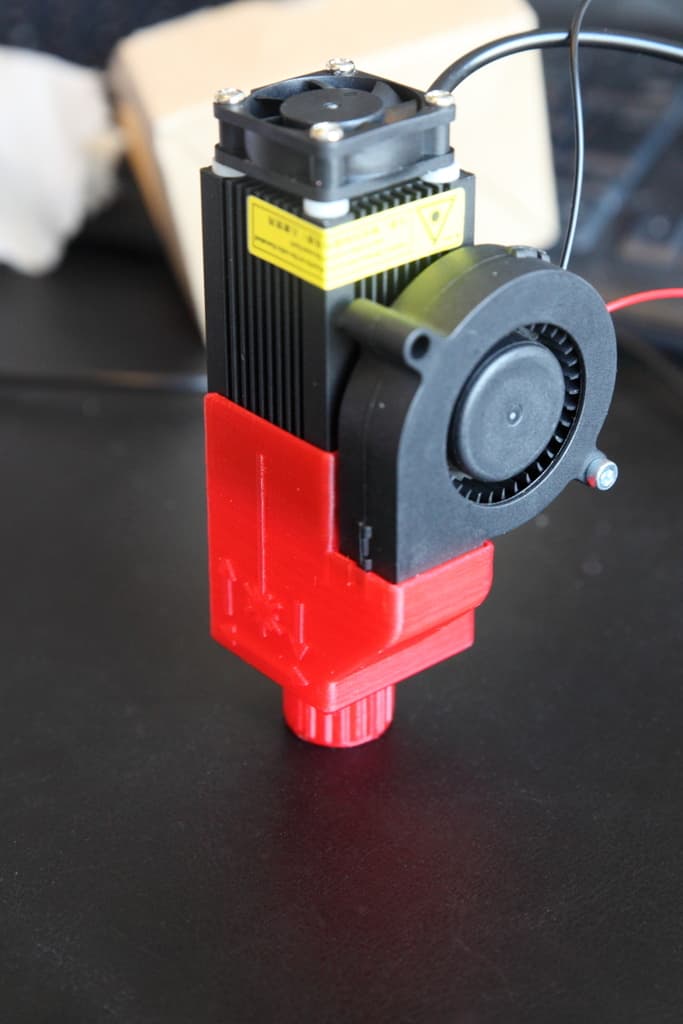

I just got one of these…
https://amzn.to/3FV1Xbm
Still getting it mounted up. Will try and let everyone know how it goes. Hoping this will be a stop gap until we can build the CO2 laser lol

If you just wanted to put a laser module on your LR3, then I’d consider the NEJE modules. They now have a 24W module.

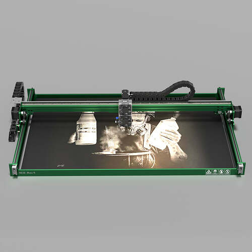

@bitingmidge , my NEJE has been pretty good so far. The NEJE Max 4 looks really interesting.
Has a motorized Z, 20W laser (the E80 MakerJim references above), pretty good size area (with the option to increase it I believe) and pen/drag knife attachment.

I am completely confused. Currently Black Friday has the Max 4 at $864 plus $60.00 shipping. as soon as I add a Air Assist ($69.99 and Honeycomb Grille $109 but goes to $149 at checkout) the shipping goes to $200.00!!
Now the 920 for the machine and shipping seems OK at first, but landed and taxes paid it will come in around $1800 AUD! Or three hundred more than the sculpfun which has air assist included.
So - is it worth that much more for a movable z axis, a pen and a cutter?? Maybe not, but I do like it a lot.

The price is almost identical to the xtool pro 20w and I do believe that the Neje laser bits are nicer as is the moving Z.
