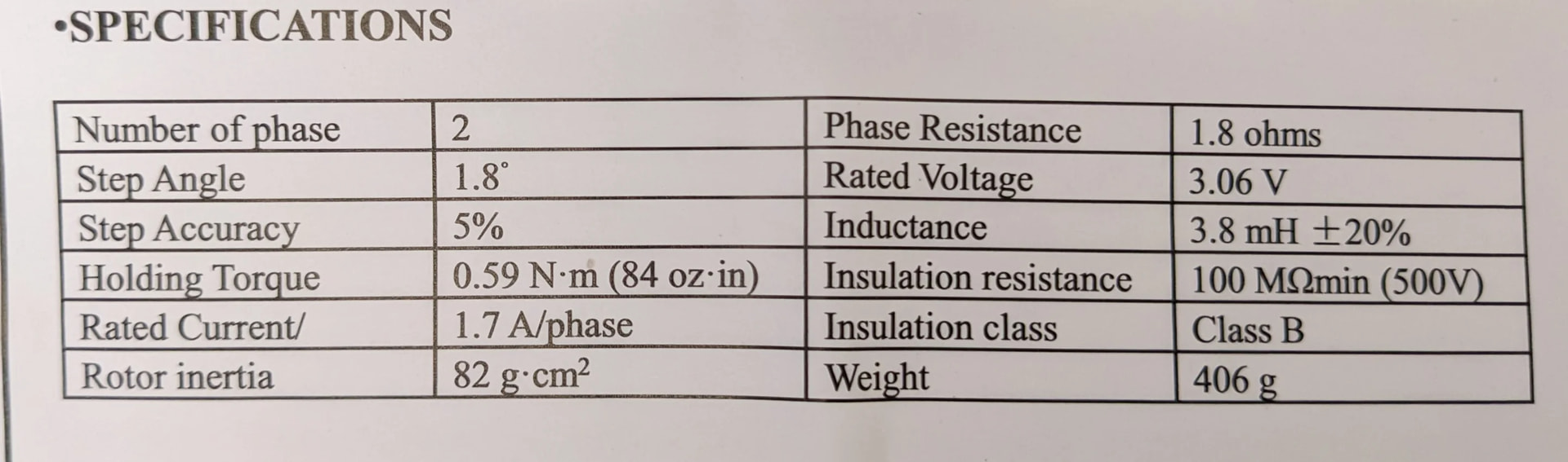

That motor is quoted as a 55N-cm Holding Torque, drawing 2.5A max, which isn’t as good a match for our controller electronics as the one from the V1 shop.
The motor from the V1 shop is a 59N-cm Holding Torque.

I failed to find decent torque curve datasheet for those LDO steppers. So curious to see how they compare to the V1E shop’s Zyltech’s, and/or, how much headroom is gained from increased voltage/current. Then looking at cost/ROI, etc…
