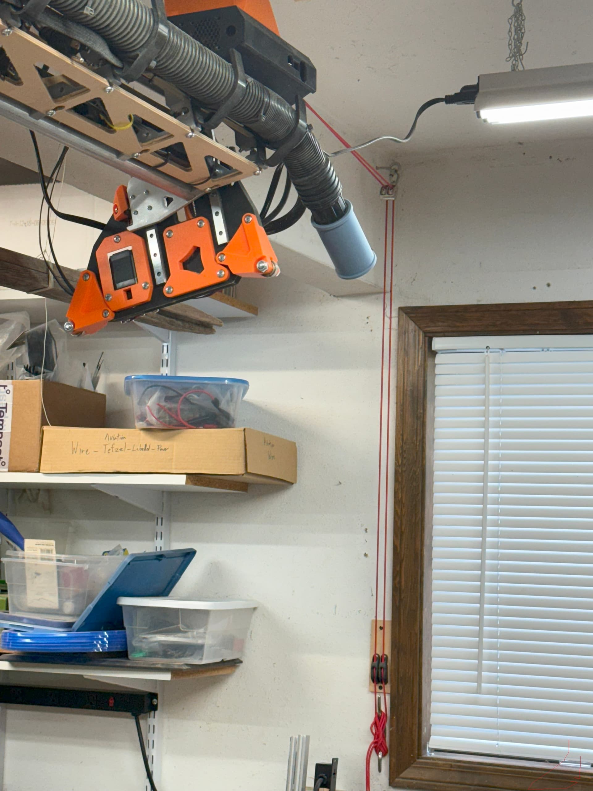

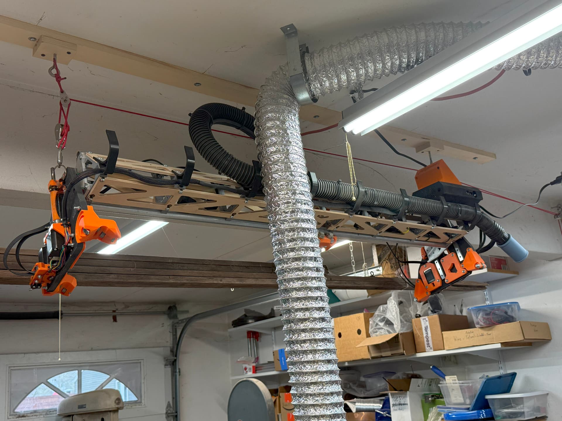

I have my LR3 hoisted up to the ceiling in my garage. I have no problems with re-calibration when I put it back on the work surface.
You can see from the pictures that I added a board, attached to the ceiling studs, to allow me to position the lift point exactly over the ends of the LR3. The first iteration of this setup didn’t have that and it prohibited getting the system lifted high enough.
I also used two sets of pulleys per side and I needed the block and tackle approach to let me lift the whole assembly by myself. It still takes a lot of pulling to get it lifted and is always easier with another person.
Here are two pictures of the system.
