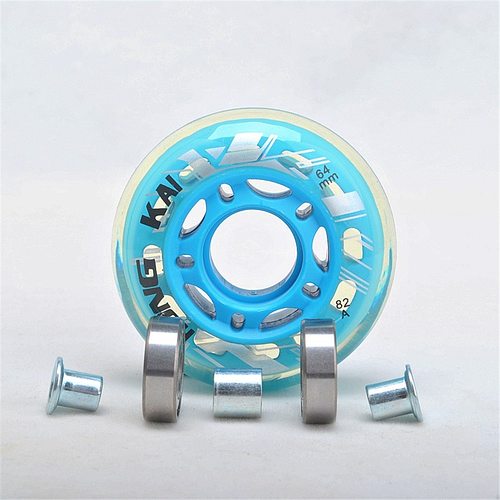

Wheel spacers sometimes come with the wheels kit… I bought the 64mm from AliExpress…
For the board and screen I went for the SKR Pro 1.2 and a TFT 35…I bought this through internet on 3D printers shop to avoid the excessive import taxes either from USA or China…but whatever you order make sure it will work with V1’s precompiled firmware…so go for the components Ryan sells…unless you’re a technology nutter :rofl:

Thx @AlexBondCat,
your wheels look good, I will select these wheels also.

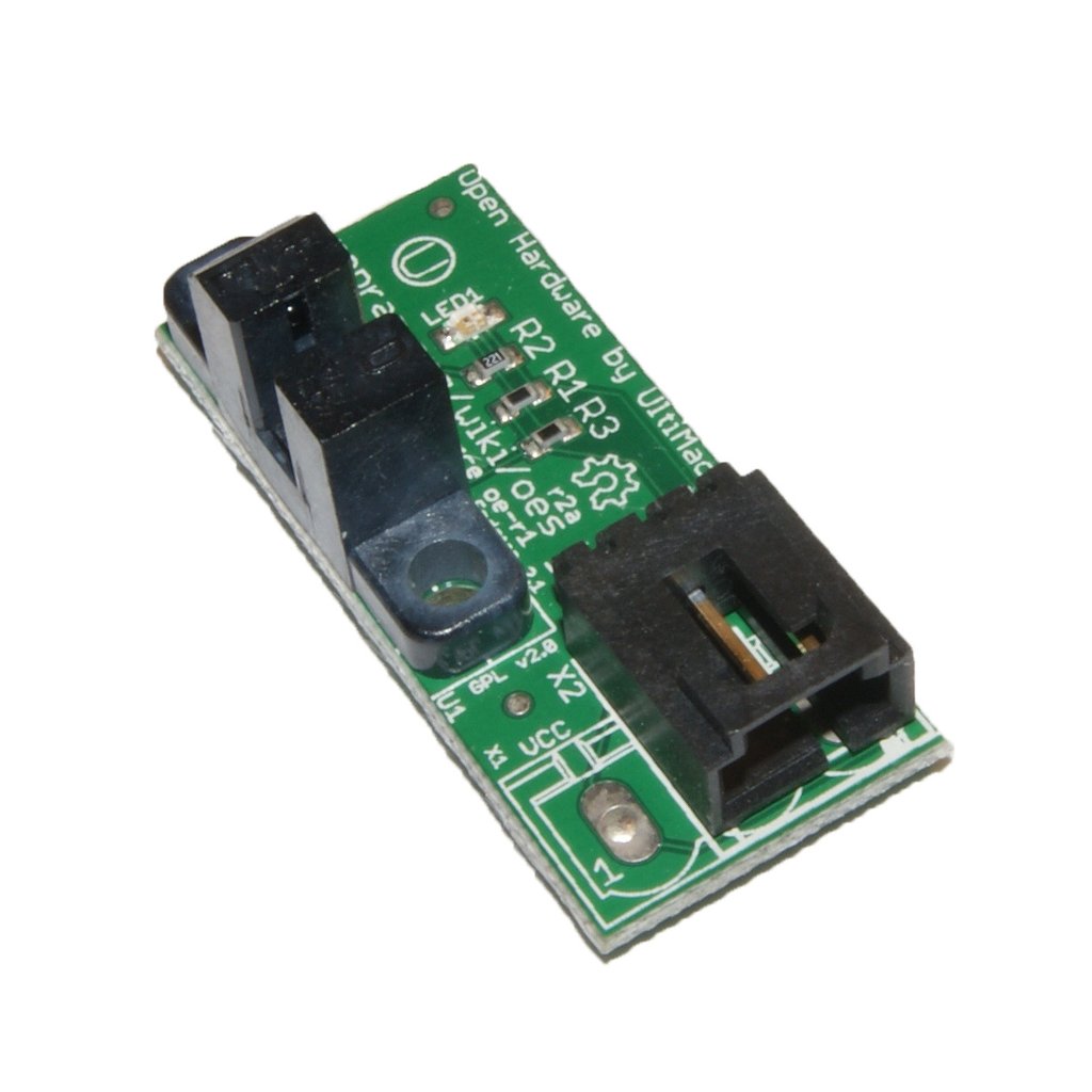

Will Archim 2.0 work for the lowrider2 ? And can we put optical endstop instead of mechanical ones ? Do you recommend it ? Does not seem very reliable but i’m still curious…
P.S. we are making a tutorial on how to build a lowrider2 for beginners. It’s in french but we can translate it later. We are making a shopping list with all the links. Of course we will not forget to tip V1 for the design.
The hardware on the archim 2 is great. The software just keeps getting broken. At least in Marlin.
