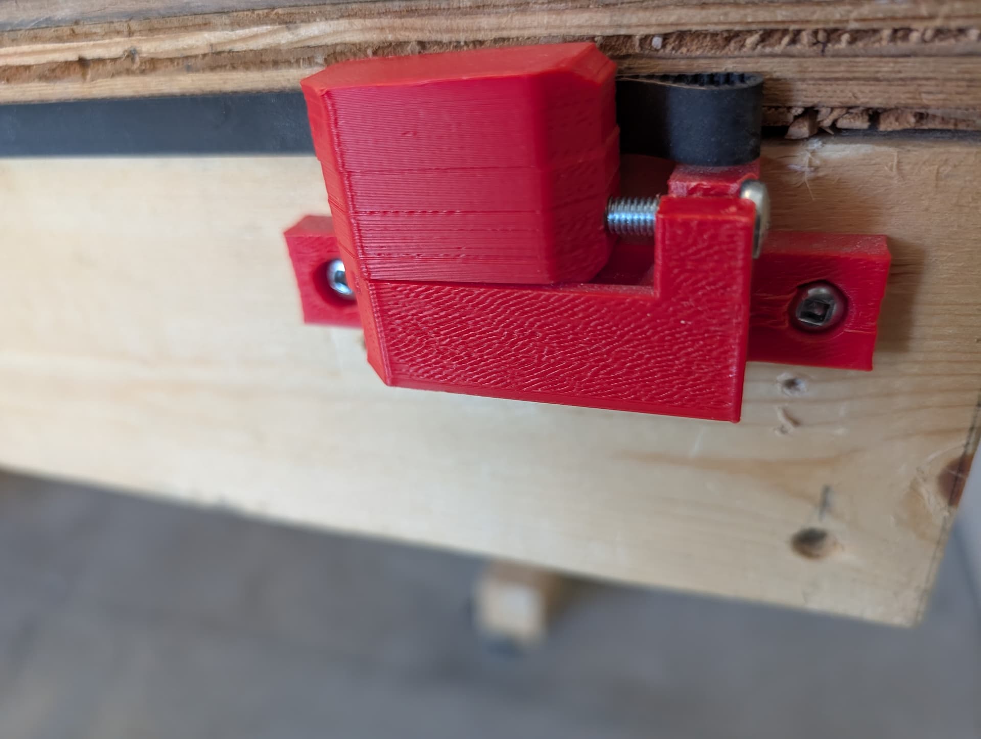

I am (re-)calibrating my LR3, and the initial measurements showed that on a 2700mm move (Y axis) I was actually moving 2698.25 on the non-rail side and 2697.75 on the rail side. On the X axis a 1760mm move was actually moving 1759.5mm.
Because there were different correction factors on each belt, I started to think that it wasn’t actually the belt tooth spacing at issue (at least on my build), but rather minor variations of tension on the different belts was causing the overall differences.

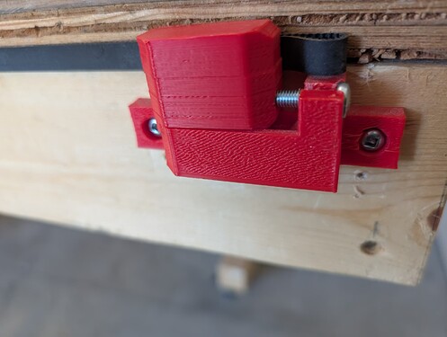

Because the pitch on the belt tensioning screws is 0.5mm/thread, I adjusted the X belt 1 full turn tighter, the non-rail side Y belt by 3.5 full turns tighter, and the rail side Y belt 4.5 full turns tighter. I checked the belts and they don’t seem to be overtensioned, and after re-measuring the travel, all three distances are exactly the same as the move command (within <0.25mm).
Just thought that I would post this info, so that others trying to calibrate their machines can hopefully dial in their distances without resorting to modifying their steps/mm.
