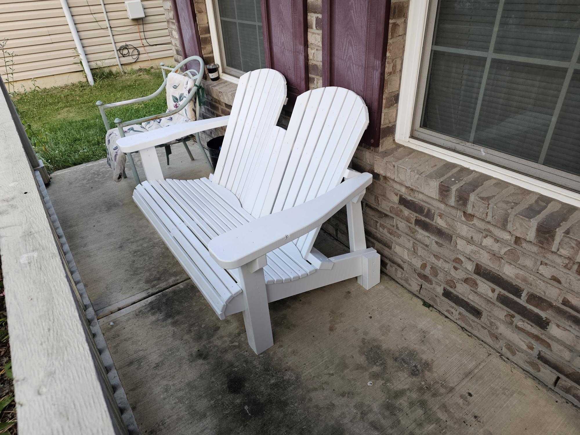

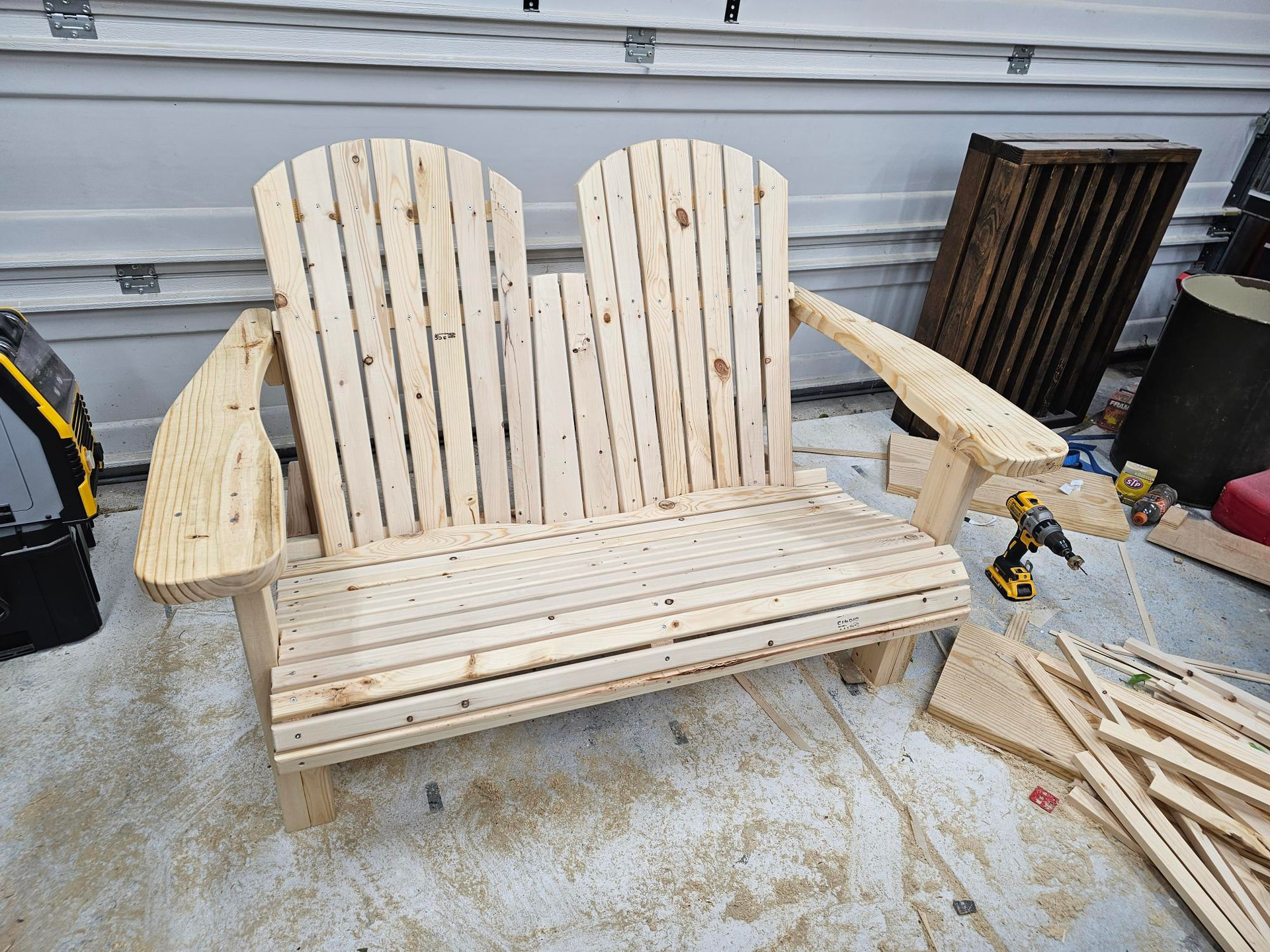

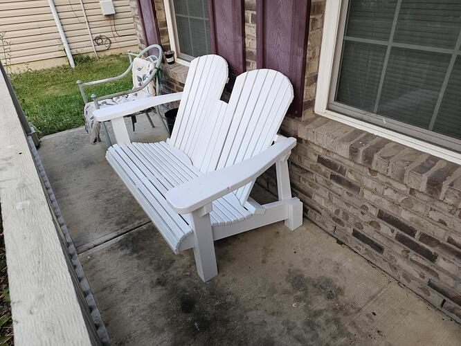

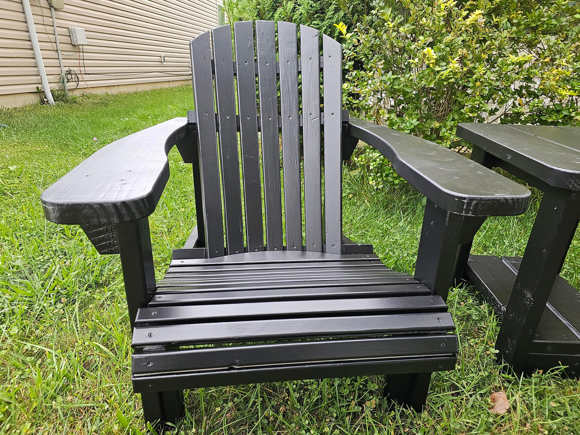

Just curious what the final product looks like.
Oh, sure. Here are some pics. I also included the bench I make.
Very nice. Did you come up with the design yourself or were these purchased plans?
These are on my list of things to attempt. Not really to sell, but we have a community firepit that I think could benefit from a few sets. Probably not worth the time or money I would have to put into making them, but that would describe most of my projects.
I bought the plans and templates from Rockler. I then took the time to re-create them digitally. I don’t sell a lot of these because they aren’t cheap. But then again, you get what you pay for. It’s just most people don’t want to pay what something is worth.

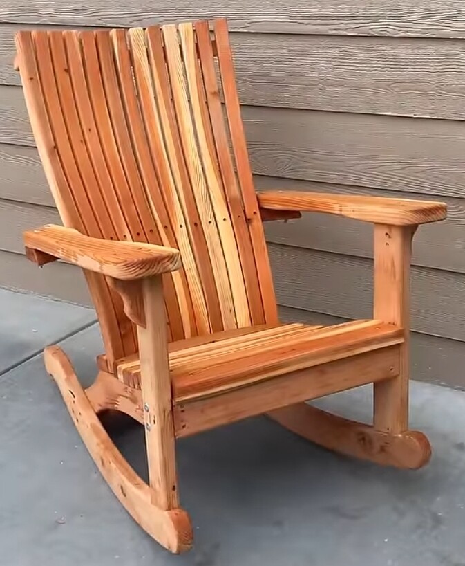

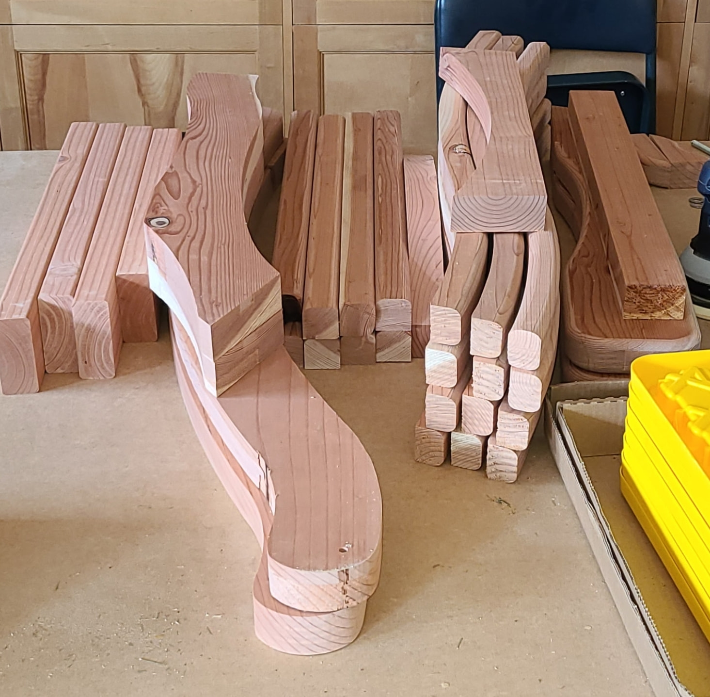

It’s getting very close… pieces are all cut and ready for sanding, finishing and assembly. There were some surprises cutting this 1.5" thick redwood, but for the most part it went as expected.
This is the Adirondack Rocking Chair from Kings Fine Woodworking:
