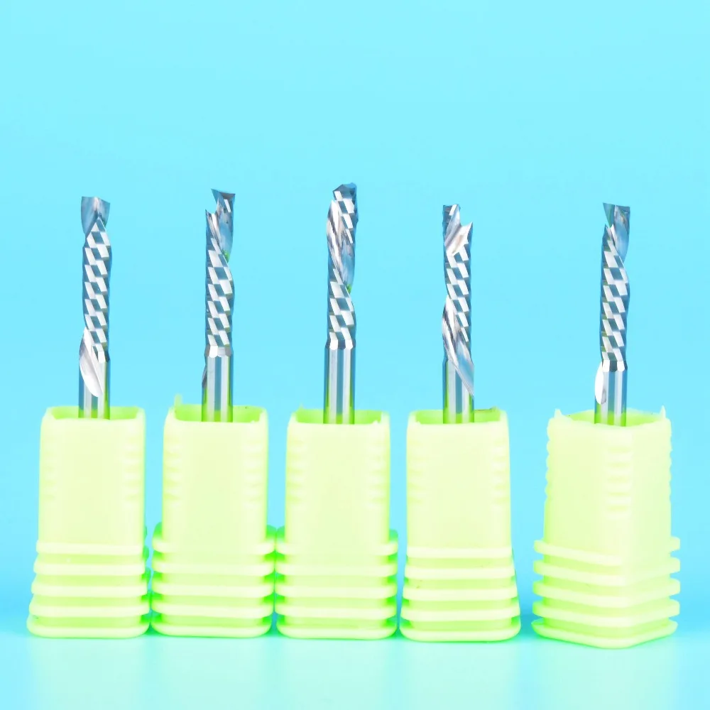

I bought a 1/8" up/down single flute compression bit and I’m going to do another chair tomorrow. The plan is a 9.5mm DOC at 600mm/sec at 22775 RPM (4.5 on the dial) The G-Wizard calc give me all green lights with these settings.
Most of my projects get a roundover and/or sanded etc. so I haven’t worried about the fuzzies, but I’ll give one of these a try.

This up/down bit is great! In the picture, the top piece was cut wit a down cut bit. The piece underneath was cut with the up/down bit. Practiced a little and it slots well with a 6.3mm DOC at 700mm/min. 3 passes and a spring pass. The curfew leads up with chips a little too much though. Hmmm, I wonder if I can come up with something that directs the spindle’s exhaust to do this.
