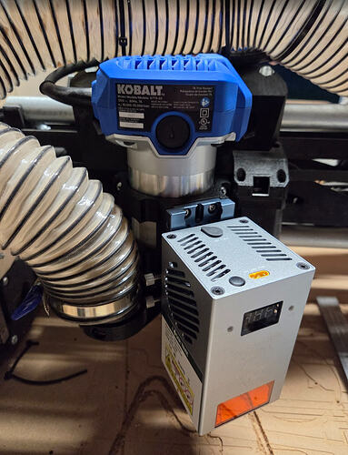

I’ve had my LR3 for over 2 years now and decided it was time to add a laser.

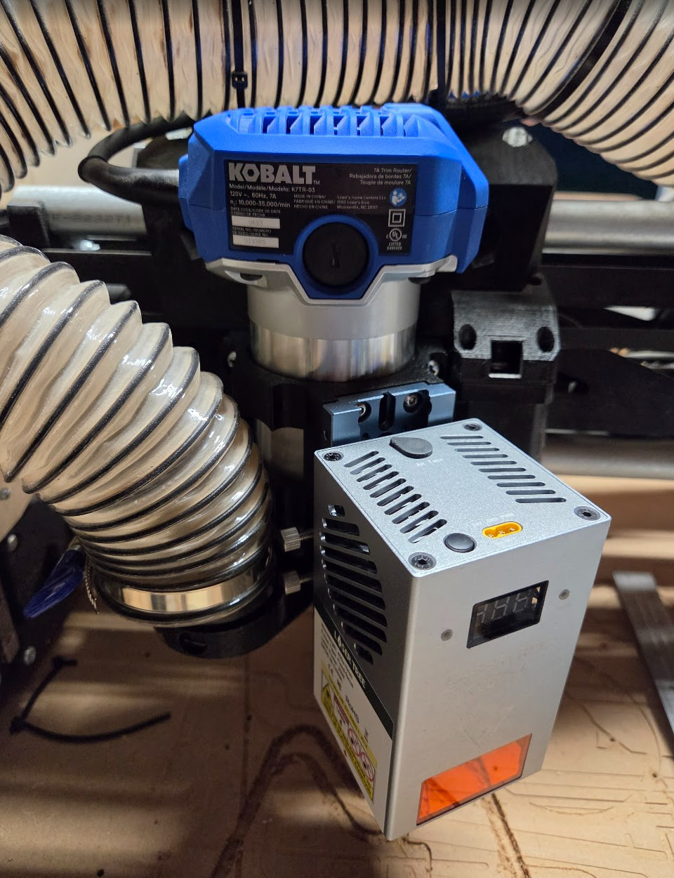

Step 1 was trying to figure out what to get. I eventually settled on a Lasertree K20 Pro. It’s a 20 watt diode laser. It seemed around the right price to performance ratio. I plan on doing some engraving and don’t see myself cutting through anything more than 1/4 inch, if that. I also got some laser glasses and an air assist pump.
Step 2 was figuring out how to mount the thing. It comes with a nice mounting bracket. After a few failed attempts, my CAD work was successful.
I’m using a Jackpot 1 and the board the laser came with. I have the config.yaml updated. I started a Lightburn trial and am figuring that out. The laser board is connected to pin 27 and ground on the Jackpot. The air assist pump is also plugged into that board as well as the power connector. There’s a 3 pin cable with 24v, ground, and PWM coming out of that board and going to the laser.
My wiring isn’t very pretty, but basically all the mods I’m doing are helping me make decisions for building an LR4. I got my LR3 originally setup based on the yellow brick road, have made some mods, and figure I know enough now to know how far I can detour for the LR4.

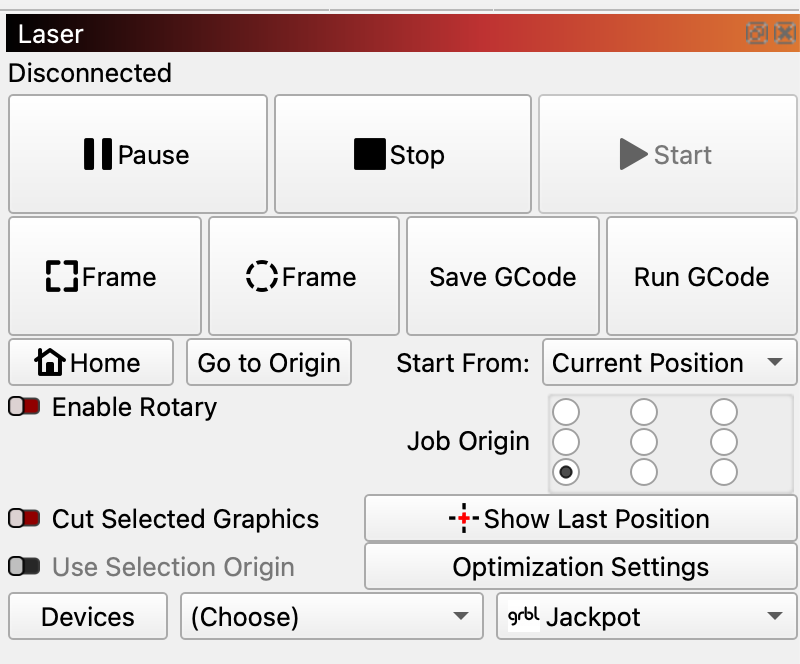

  1. How do I make Lightburn so I can zero at the starting position? It seems to want to use absolute coordinates. I’m so used to zeroing at the project origin. I am exporting gcode and running it that way. I’d rather not need a computer for running a job.

Think of Origin as lightburn’s zero point. You set whether to use absolute points or relative to origin in the laser window on the right:
Setting origin to the lower left worked for me when I made my custom CNC/laser gcode.

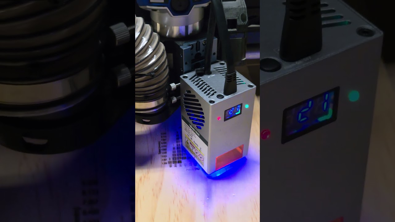

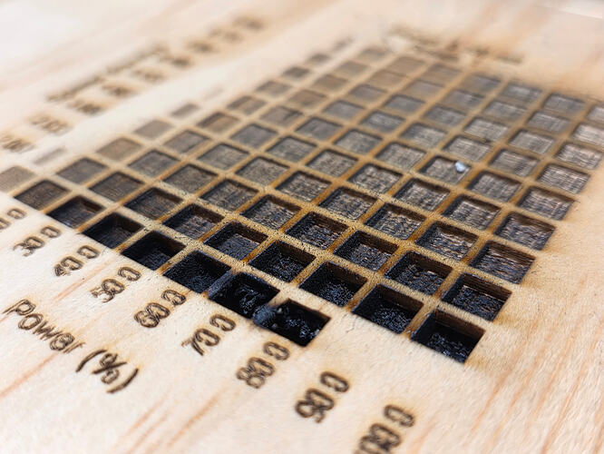

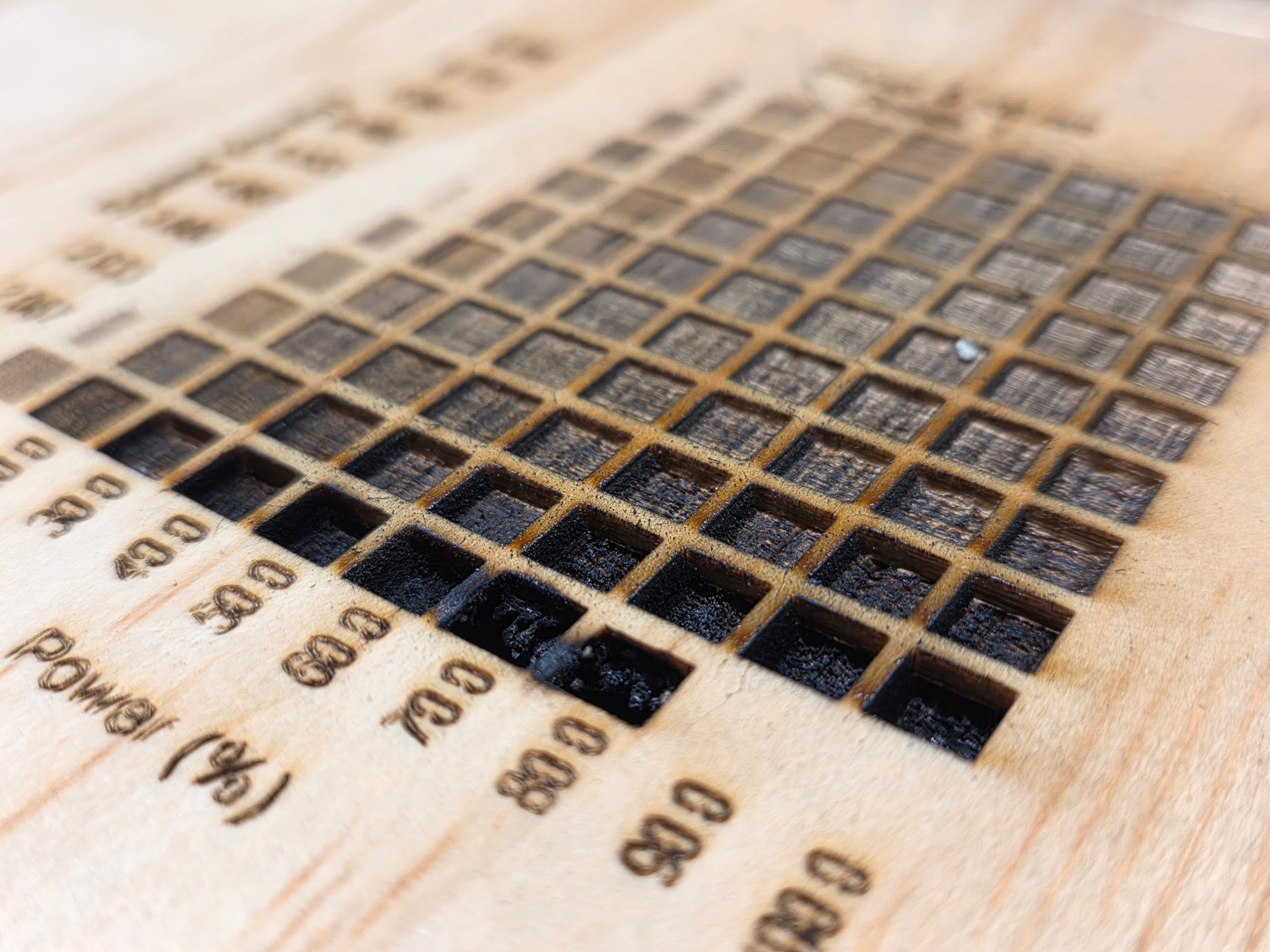

Did an engraving test and killed it at the end because it was going through my 3/16 inch plywood. I’m guessing I should turn the air assist up a bit higher too.
But wow this is exciting!
Well done! I just threw a random offcut of 1/2” when I did mine so it made it to the end, but the last hole was pretty deep and a little ashy - and was only at 20W. Have lots to learn!
Also, did you happen to notice on yours if you can read the numbers on the laser while wearing the safety glasses? On mine the letters are blue, and the glasses are pretty darn effective at eliminating any blue so it’s totally invisible :roll_eyes:
I can read the numbers but not super clearly.
It’s interesting with the glasses on, you don’t see the blue glow at all.
Yeah I noticed that too, it’s pretty amazing. I got the goggles option from your Amazon link and I like them a lot, and it’s already come in handy to have a second pair when one of my family members comes around.
This is what I use with Lightburn. Go to the Laser Tab and choose Start From “Current Position”
I also connect to my Jackpot with either USB or Wifi. I’ve used gcode on the SD card, but I alway like to frame my project before I run it. My laser is on an MPCNC.

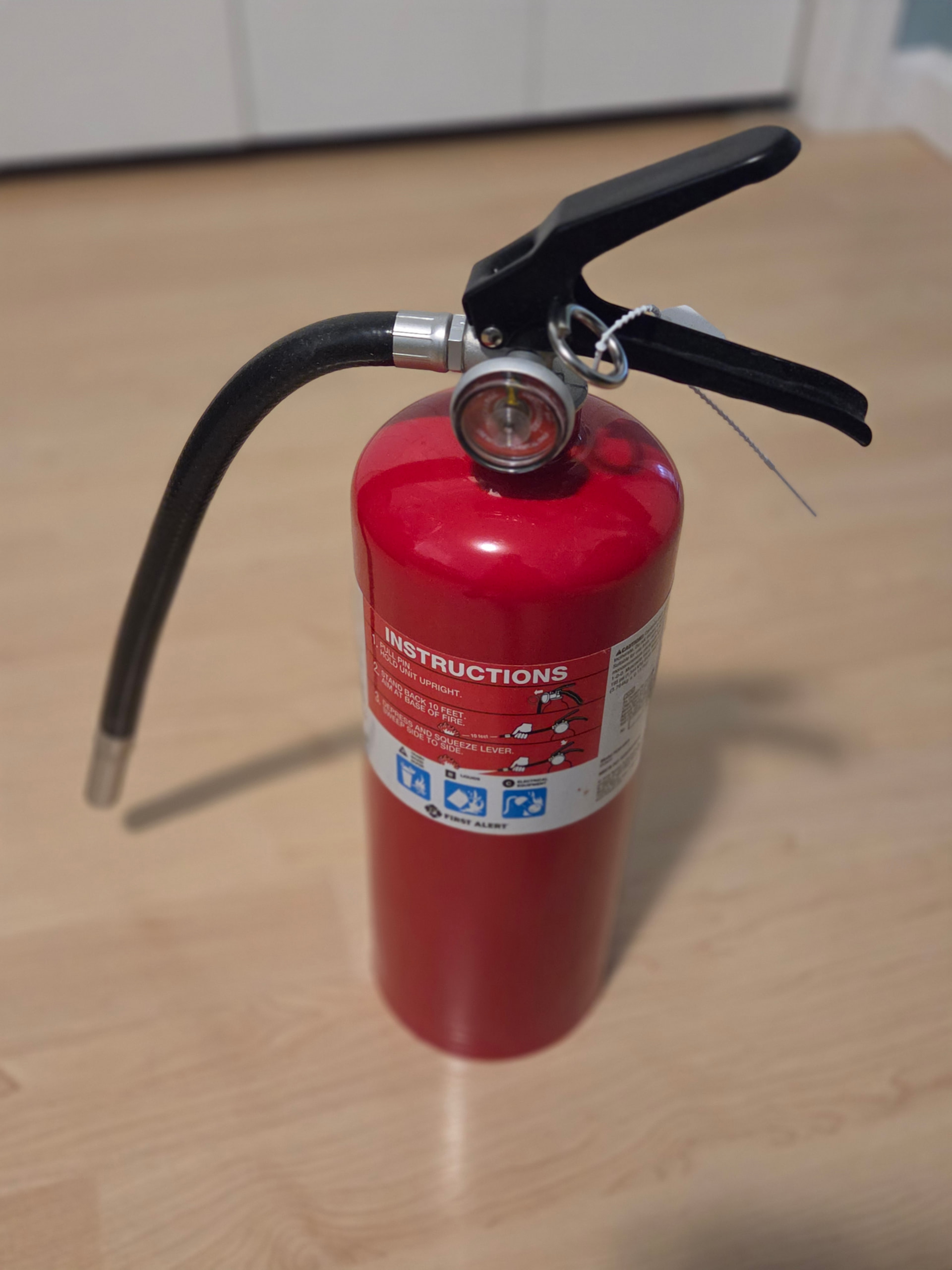

Got one of these today too. Should have had one in my new shop right away but getting a laser brought it back to my attention.
A hundred percent. Have one in the barn already, but I still have one my shopping list to mount right by the door near the laser.

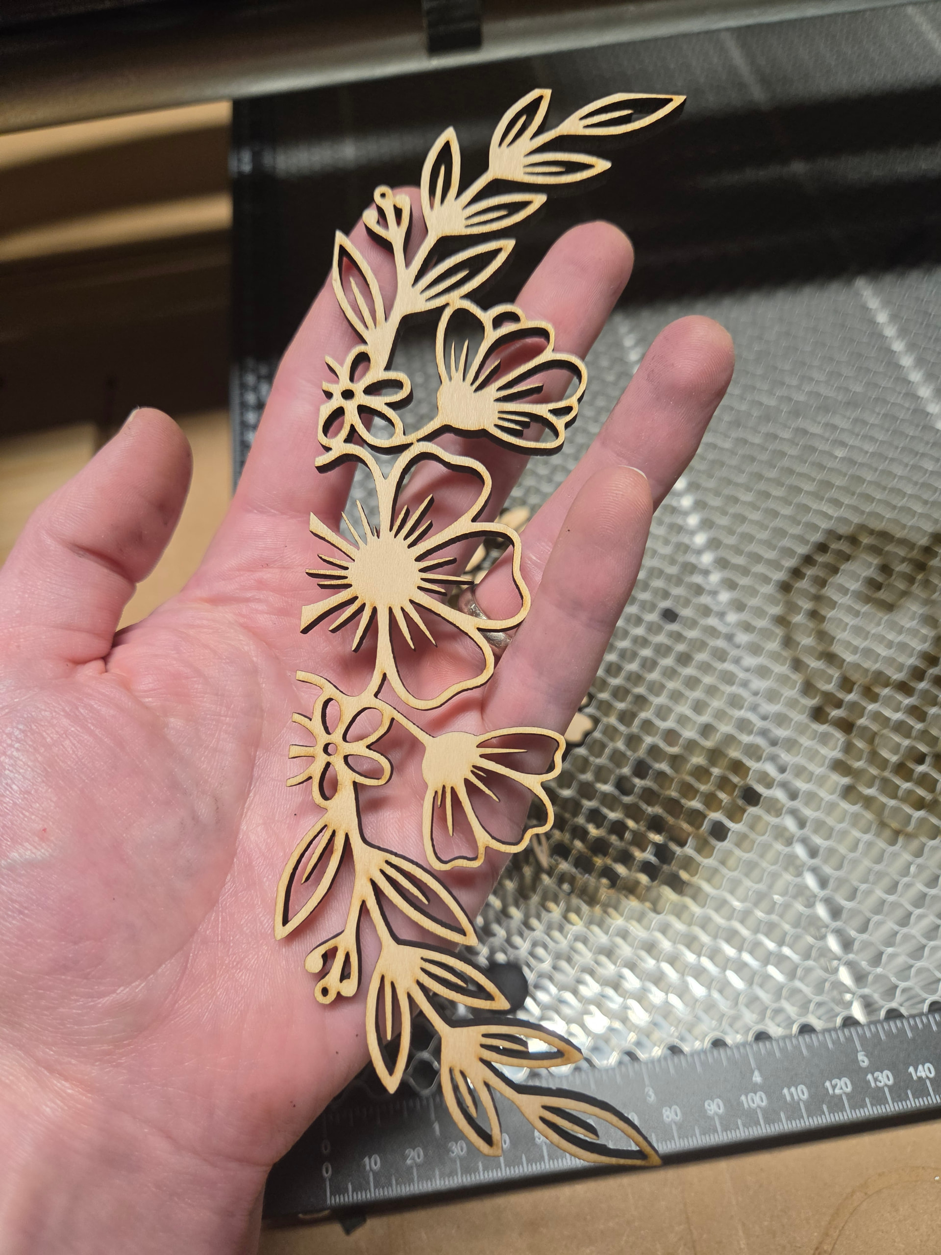

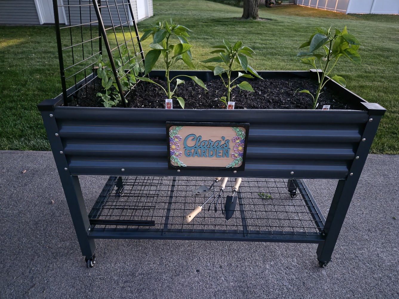

Can’t do that with an endmill…
NOPE. That came out really nice.
These look fantastic!
Looks great, Jason.

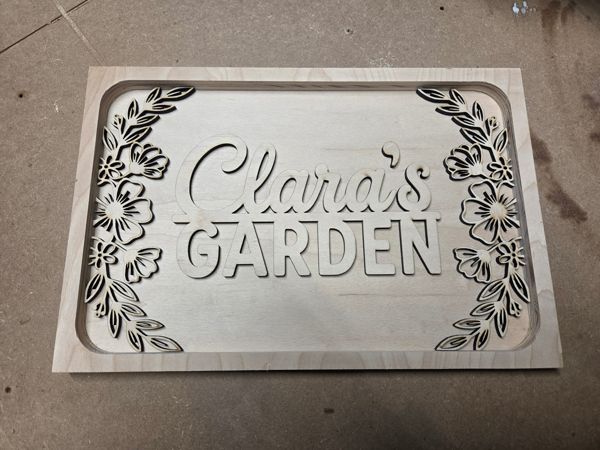

Since you have enough power to get pockets that are a few mm deep and can receive a mating piece…
you might also find it fun to start playing with lasered Easy Inlays using Lightburn.
Wow, I’m going to have to try that. My Lightburn trial is almost over but I was going to buy it anyway. Thanks for sharing.

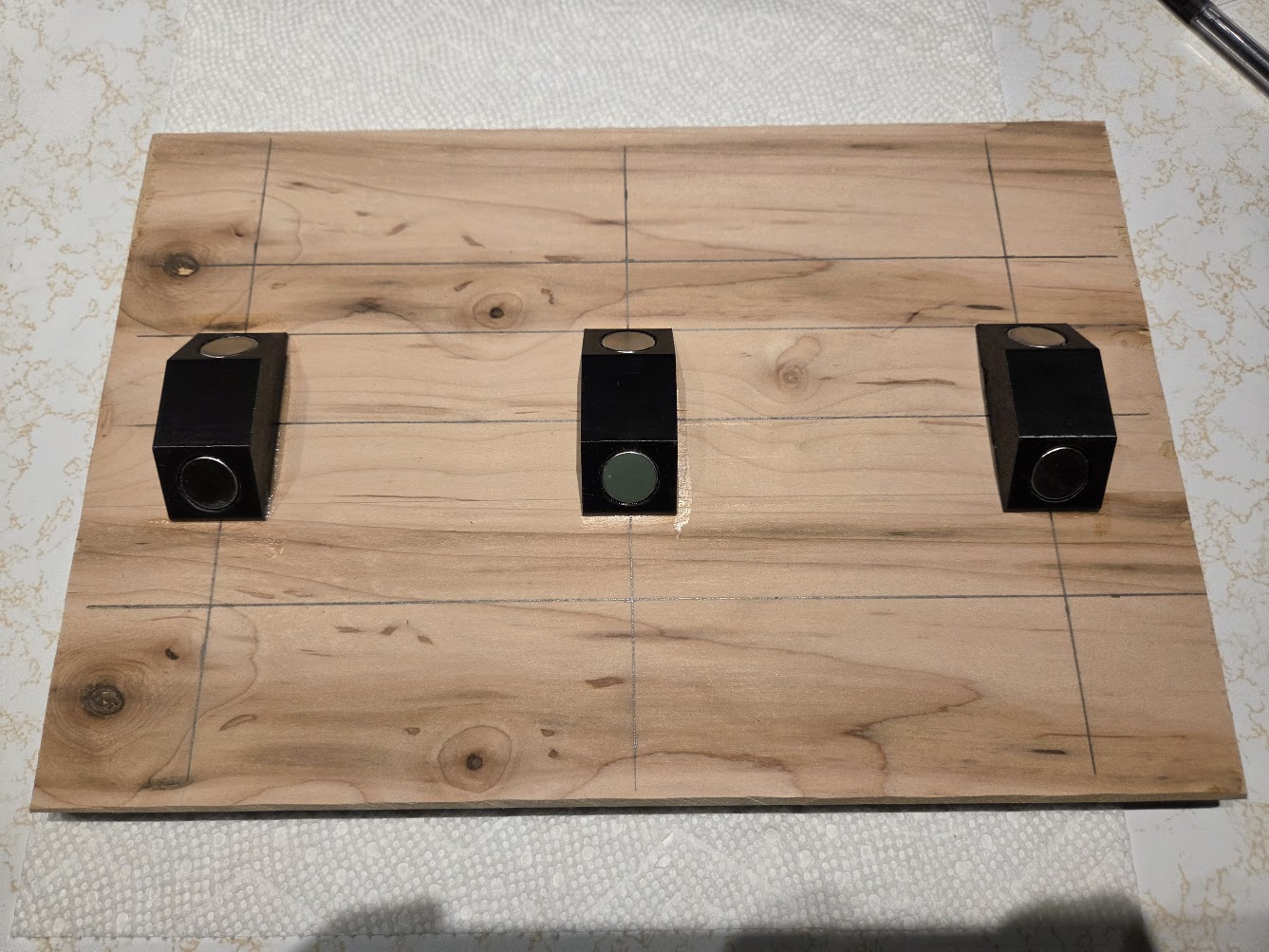

Still need to finish the back but it looks good.
I’ll probably use that same magnet bracket to label some plants.
That is a cleaver little mag bracket…sneaky.
