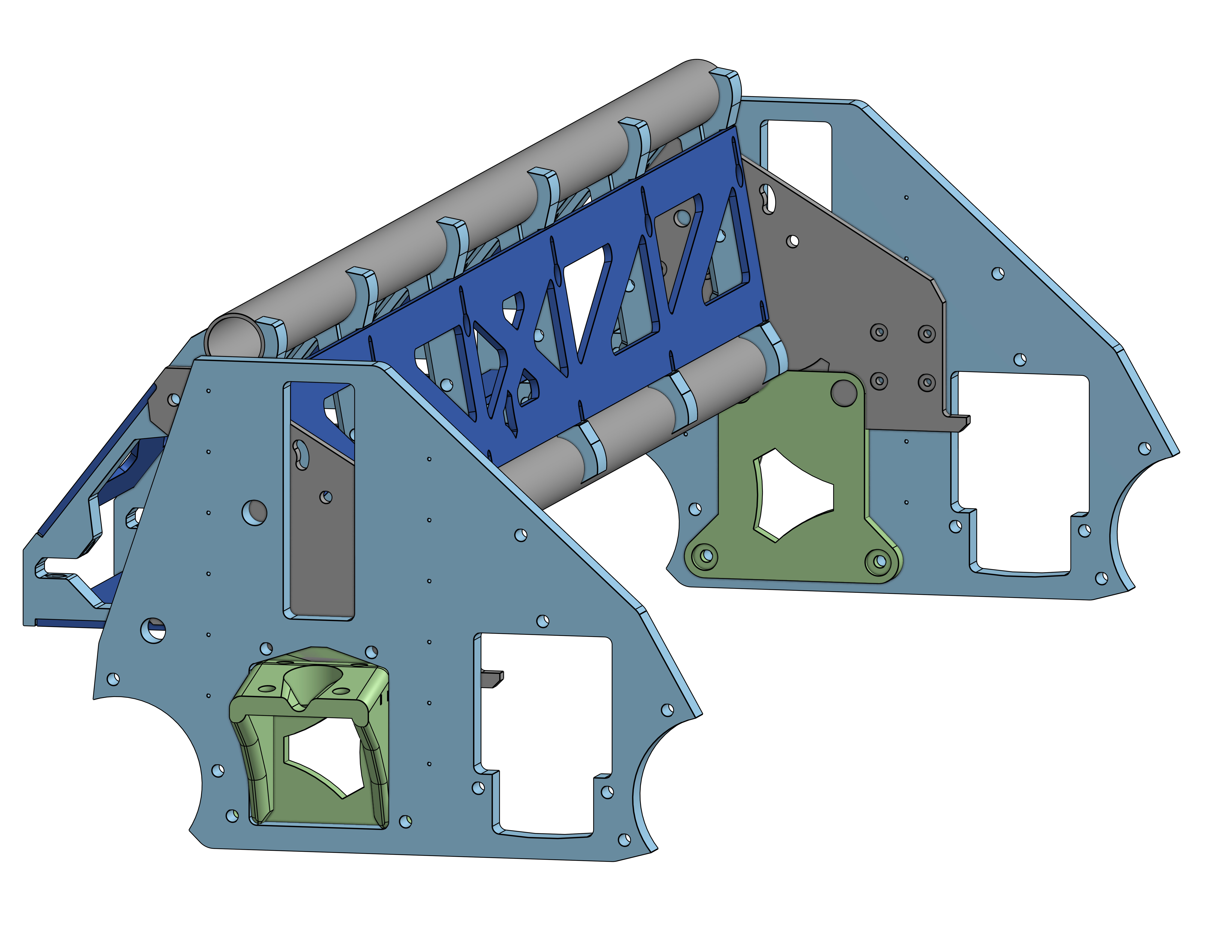

Hey was just wondering if anyone has a model of the lowrider v3? I want to build it an enclosure in fusion 360, so a 3d model would be very helpful
There are no official complete set of CAD files for the LowRider. You can download the model files for 3D printing to assemble something.
https://docs.v1e.com/lowrider/#files
If you are just looking to model an enclosure around, you can use the DXFs as sketches and extrude them, then use 3mfs to complete the assembly as necessary.
Which is what I did here.
