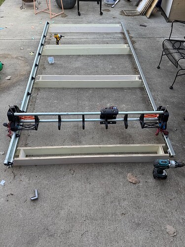

Just starting and hoping to actually follow through. XZ plates and parts ordered. Plan a smaller build to run on top of my table saw footprint.
Core printed in ASA-CF

Large printed parts done. 1" EMT purchased and idling where I can trip over it.

Sanding with 1-2-3 block
Don’t mind the hammer…
PTFE tape under belt. Amazon.com. Realize now the belt path is wrong.
Spindle
Glad you caught that!
Lol. Took me a moment to see the problem there, but I was more looking at the tape and wondering why…
There should be a lot less friction there when the belt is suppirted by the idler bearings…
Laser cut cardboard templates for strut plates. Plan to use 1/8 aluminum flat stock. Might just laser cut 1/4 ply.
Jackpot functional, vfd control… work in progress…
its_alive
laser cut 1/4" plywood. Finish LR4. Use LR4 to cut aluminum struts!!!
How it started…
How its going…
