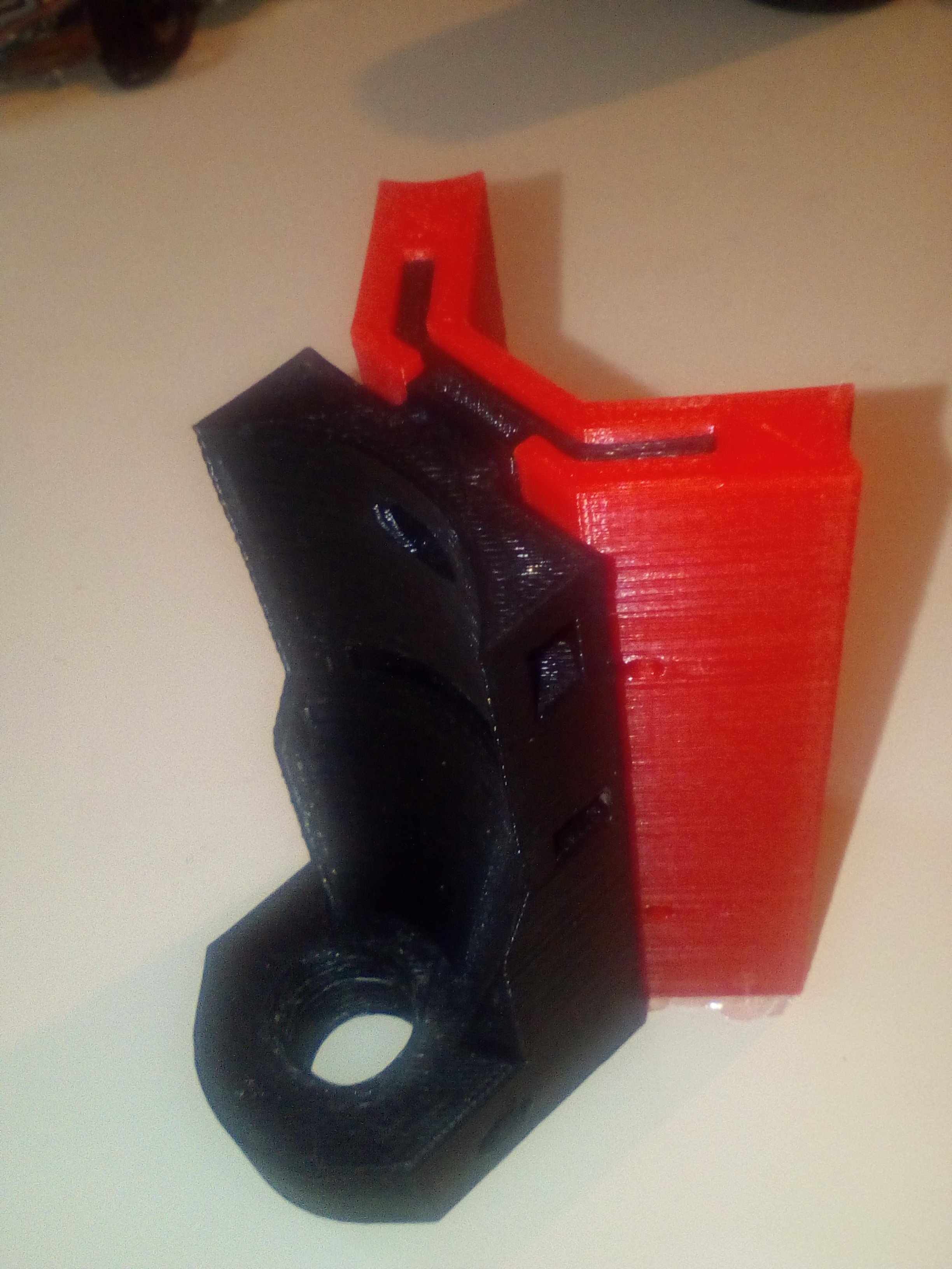

Already busy printing a 25,4 J version for a while.
Had some wrong parts because of a small problem with the files but nothing major.
The reason i chose the 1 inch version is because i have a whole lot of 1 inch stainless tubing.

Fits perfectly and without any play.

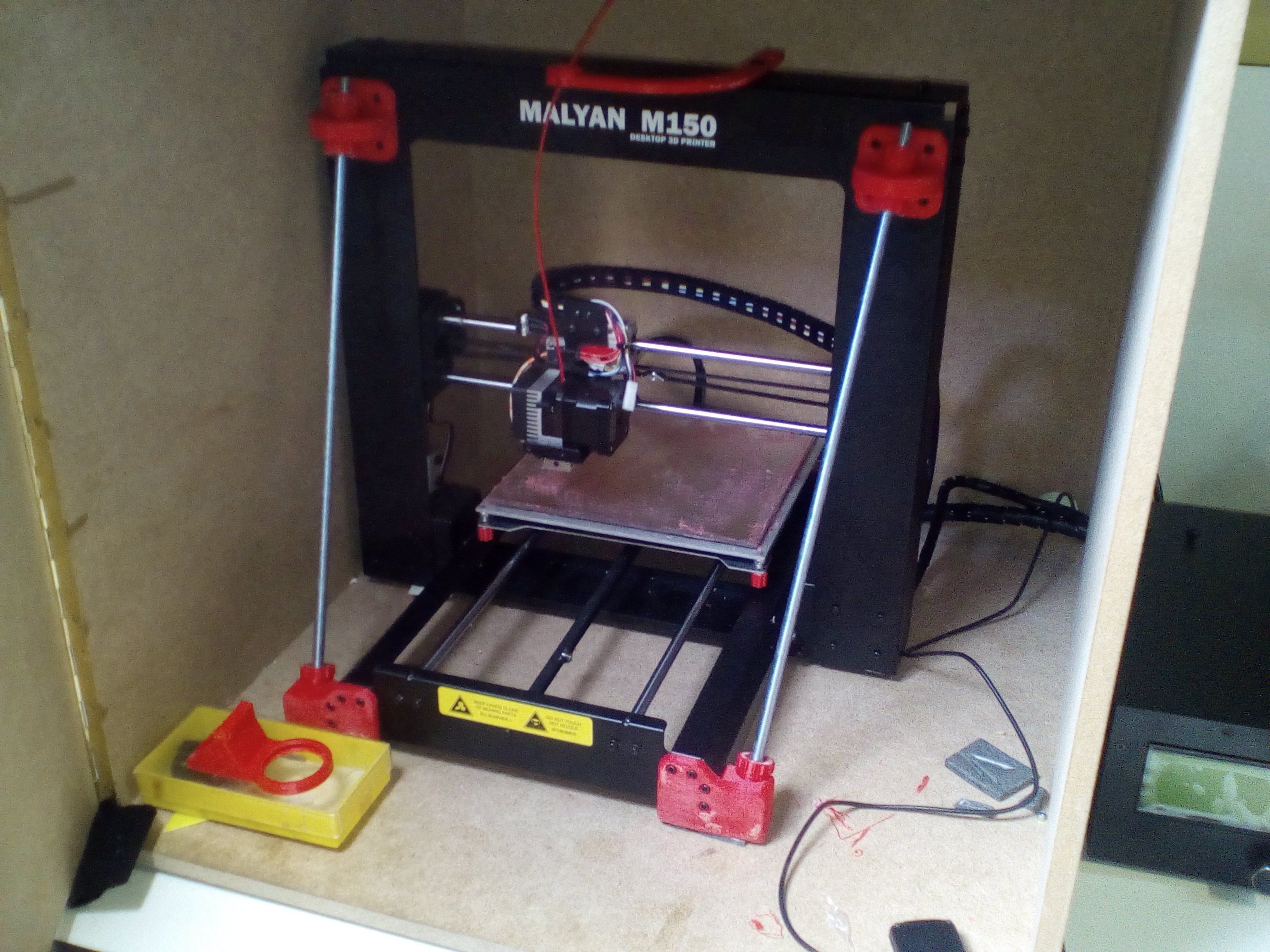

Printer settings.
Extruder 240 degrees.
Bed temp 100 degrees.
1.75mm hobbyking abs fillament.
40mm/s printspeed.
0.2mm layer.
0.4mm nozzle.
Glas bed with abs juice and the printer is sitting inside a enclosure.

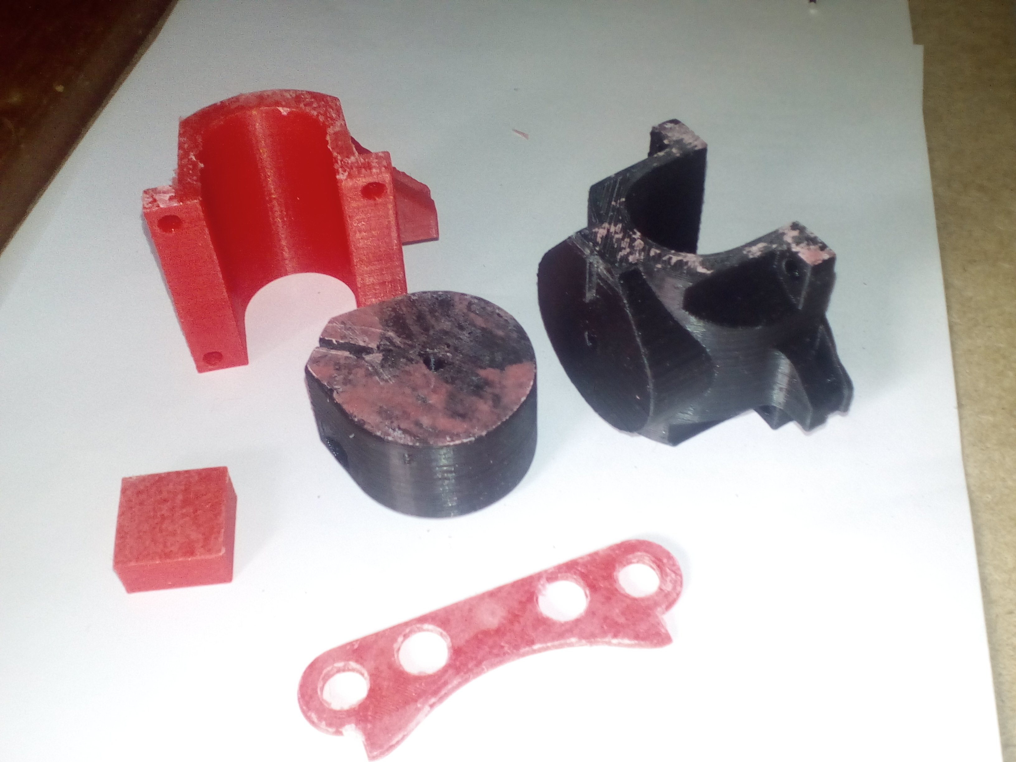

In my experience ABS parts really do hold up better.
Although - I did just break my glass bed the day before yesterday - no glue, no hairspray, no adhesive of any kind, open air printer, E3D BigBox - just plain ABS on a clean glass bed - and it FUSED itself to my glass bed. Took out a big chunk of the glass (which is now permanently embedded in the still usable MPCNC part), and made a big crack across the glass. Never seen PLA stick that hard. Probably didn’t help that ambient room temperature has been varying between 90-97, and probably even hotter near printer because of the heat a 3D printer puts out.

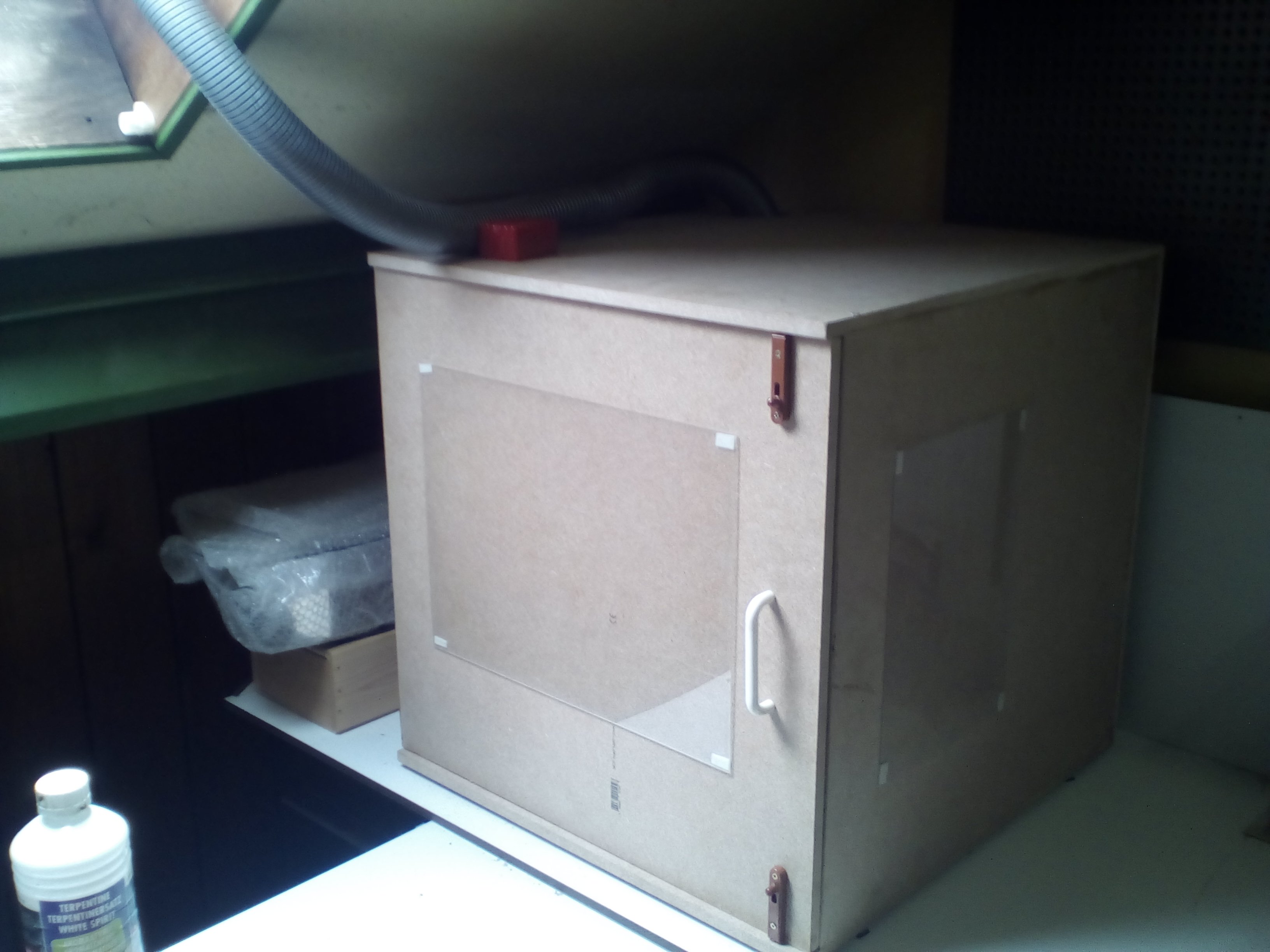

The ambient temp inside my enclosure is between 50 and 60 degrees Celsius.
Really need that when printing ABS to overcome any warping, also need to preheat the glass bed for at least 30 minutes before starting the print.
When done printing the part just pops loose when its slowly cooling down.

How do you heat your chamber?
Do you have pics of the chamber?
The printer heats up the chamber in the half an hour pre heating.
I have a 60x60mm fan running 5 volt sucking out the fumes through a old vacuumhose out of the window.
I am planning on using a arduino to control the fan so the temperature gets a bit more stable.
Box is made out of 12mm MDF and 55x55x55 cm inside measurement.
Filament holder sits on top of the box.
Still need to cut out the holes for the acrylic, have been printing to much and no time to do it :wink:

No issues with the motors over heating on long prints I assume… I think its time I do that for mine… Can cut the box on my MPCNC lol
The extruder motor does get a little warm but nothing extreme.
The malyan drivers haven’t got pots to set it and it is set very conservative.

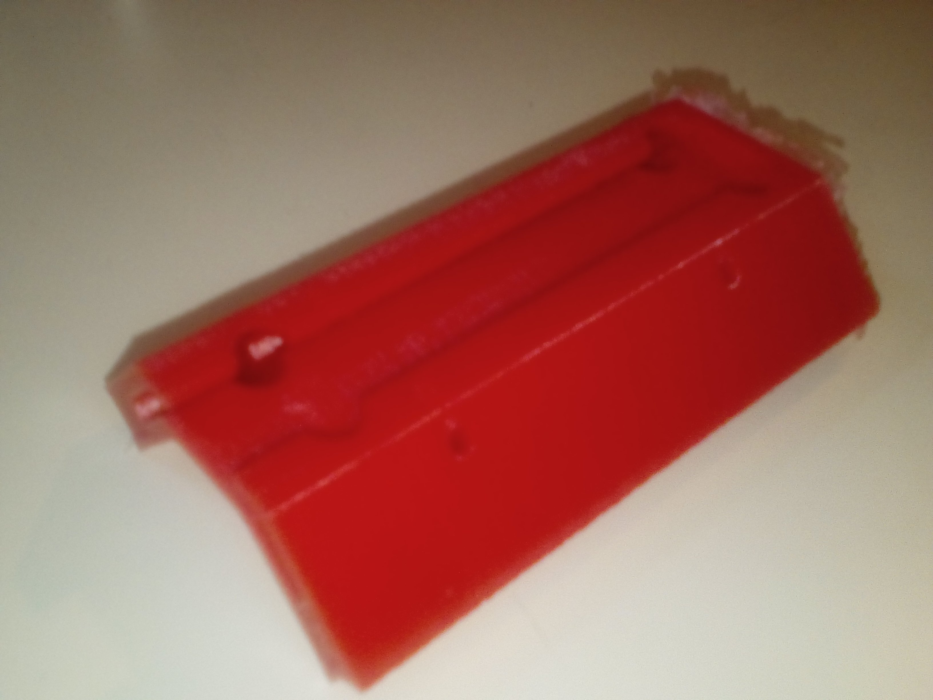

My last roller I am still printing is probably failed, I can see a crack on the webcam image.
Can’t open the door because on higher prints the abs is most certainly going to crack and warp.
Hoping it’s only a small one and its still fixable with some acetone.

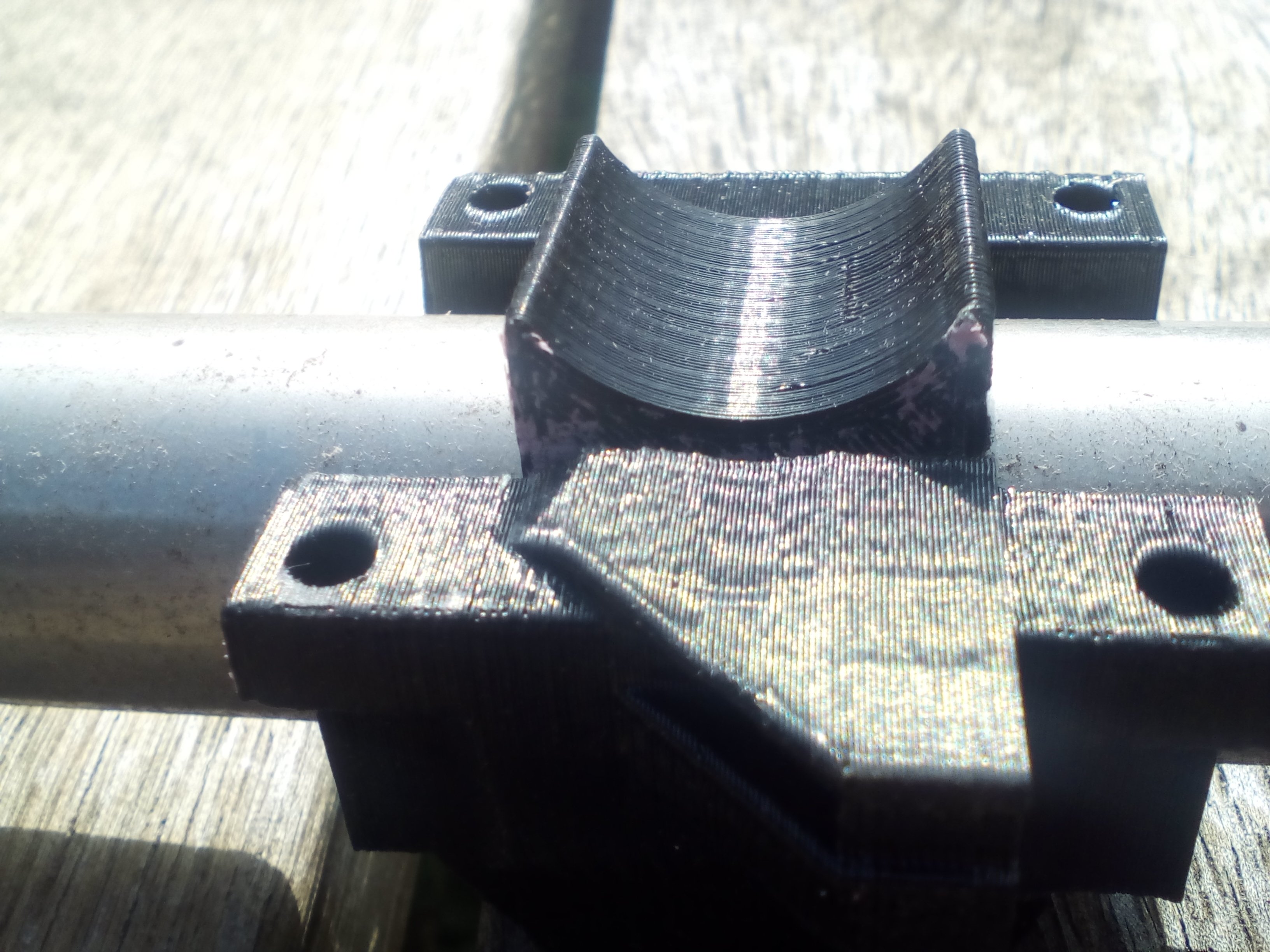

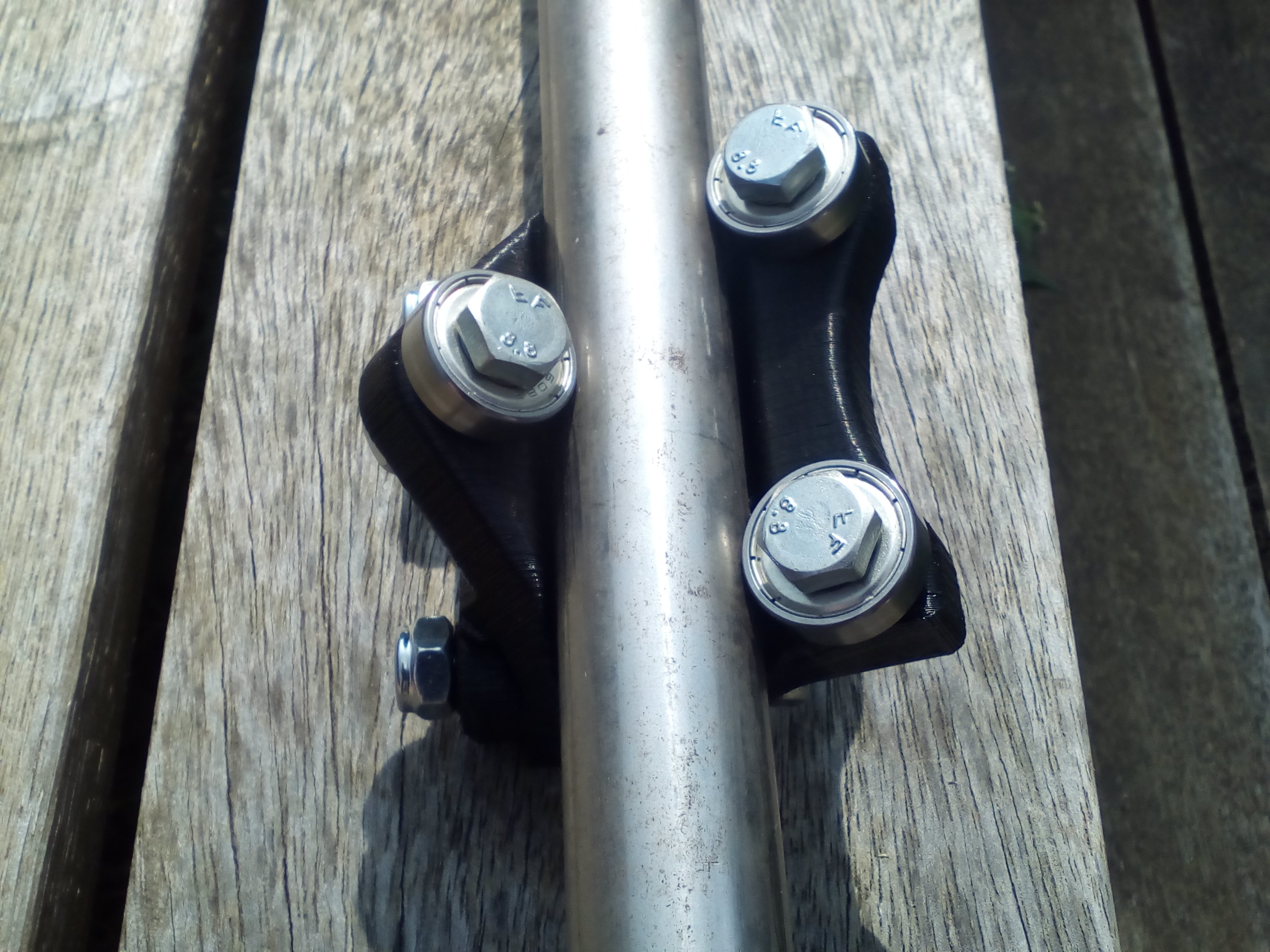

Is this gap going to pose a problem?
Top part is printed as J (correct) bottom as F (wrong but fits) and middle part as F (wrong but fits)

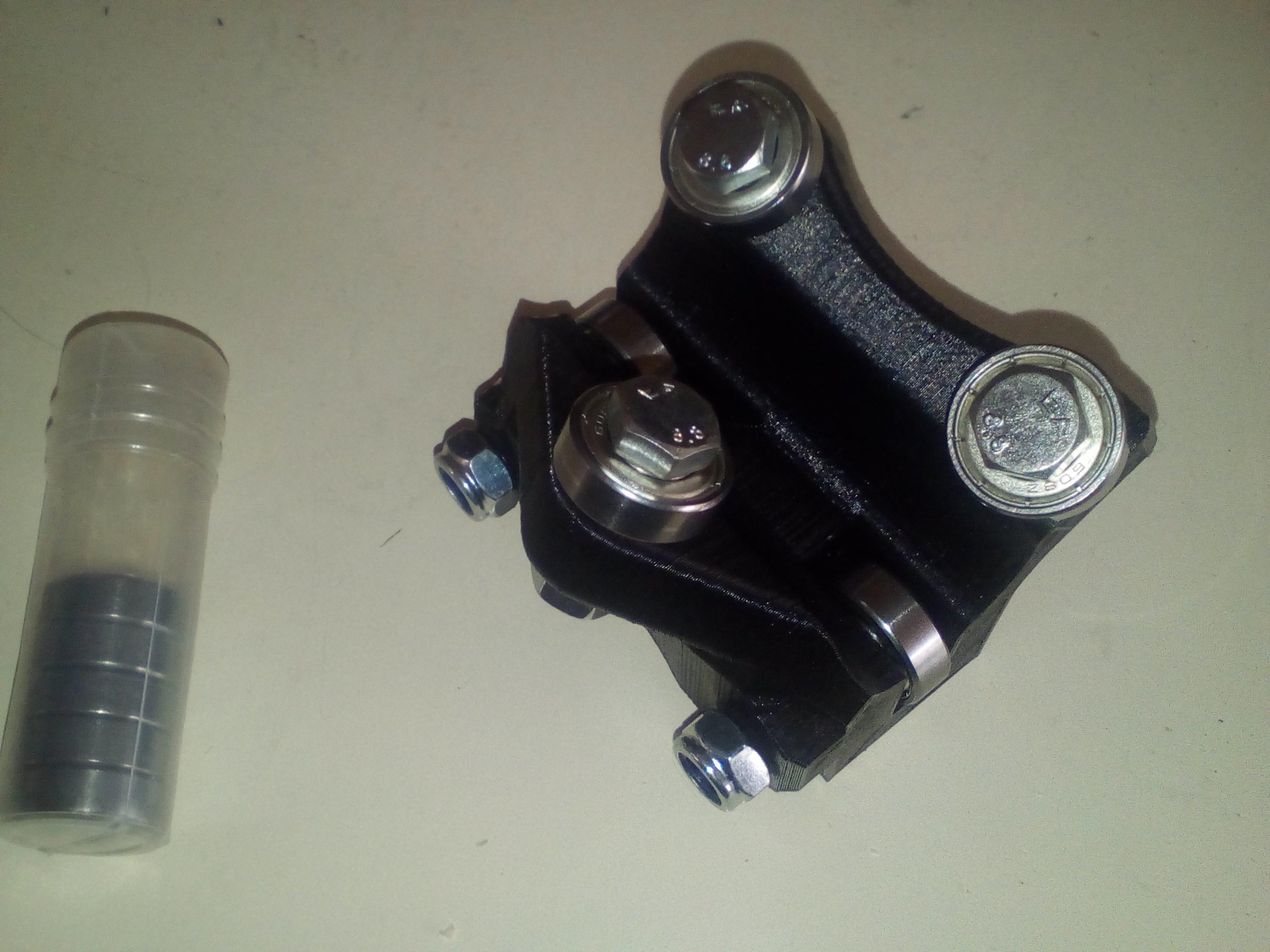

Roller fits great, rolls smooth but hard to turn the roller around the pipe.
I doubt the gap is a problem. Just make sure you can hook up the timing chain to it…

Can’t believe how good the pineapple coupler grips the stepper shaft, I was very sceptical but there was no need for that.

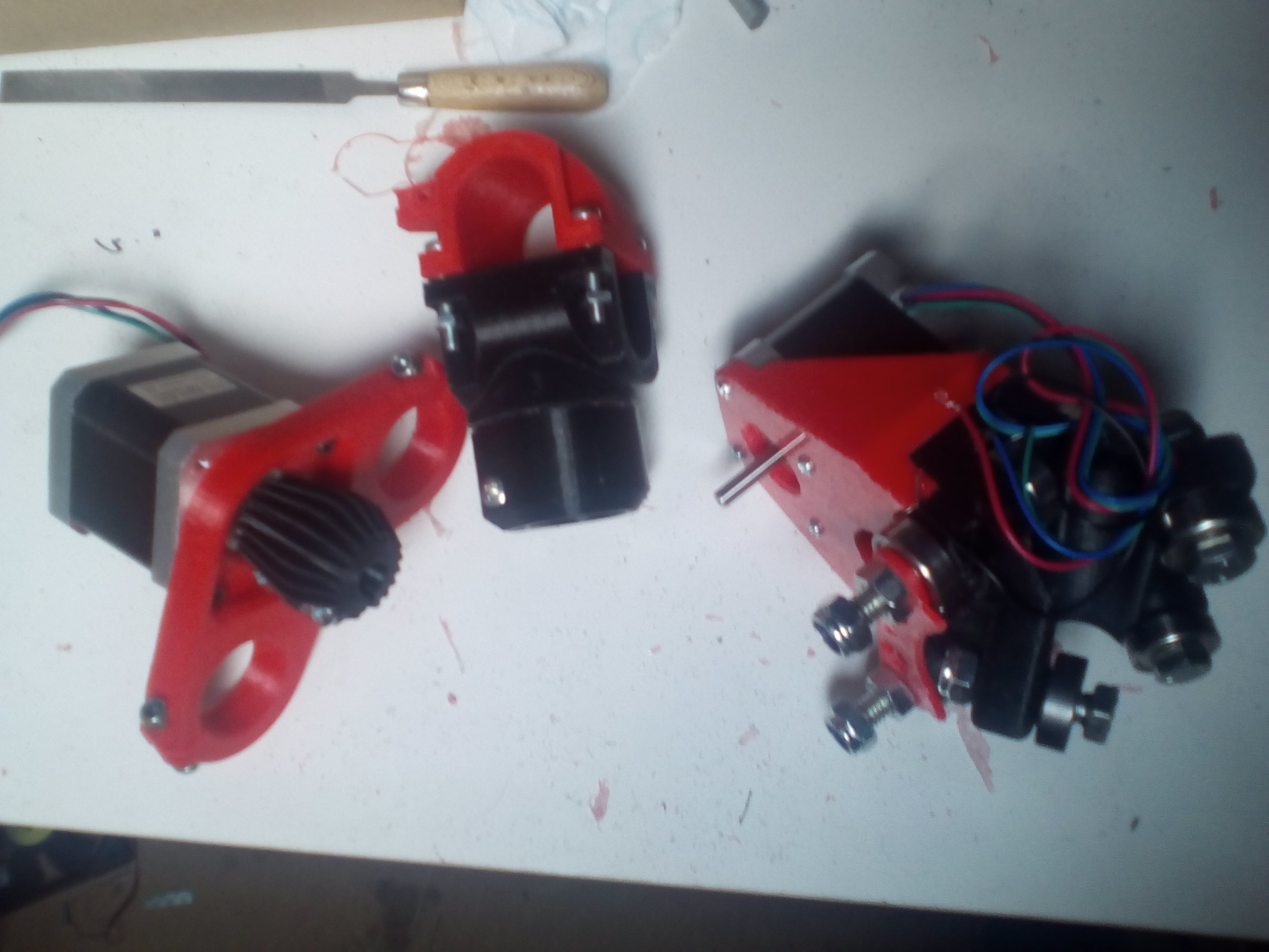

Still need to print both XYZ’s and the hicwic mount.
Mount for the dremel is done and fits like a glove.

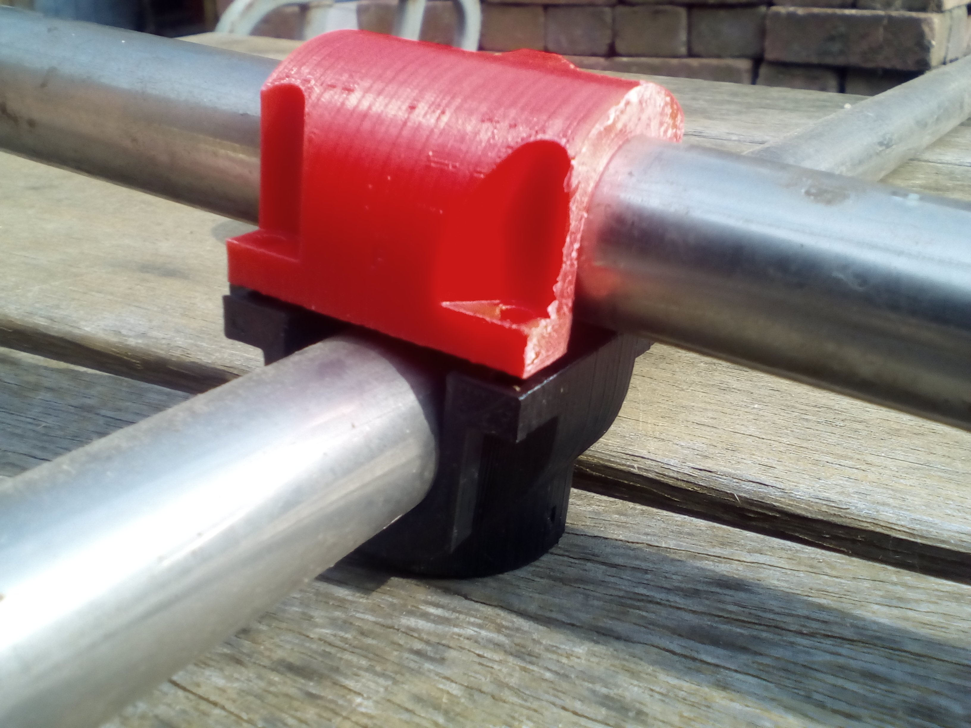

Finally done printing, took a while but I do have a good result.
No warpage, perfect fit around the tubes, bolt holes where aligned like it should.

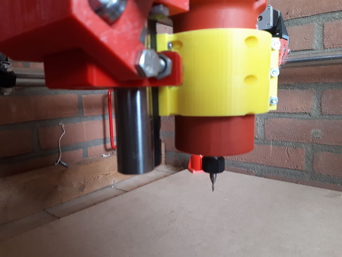

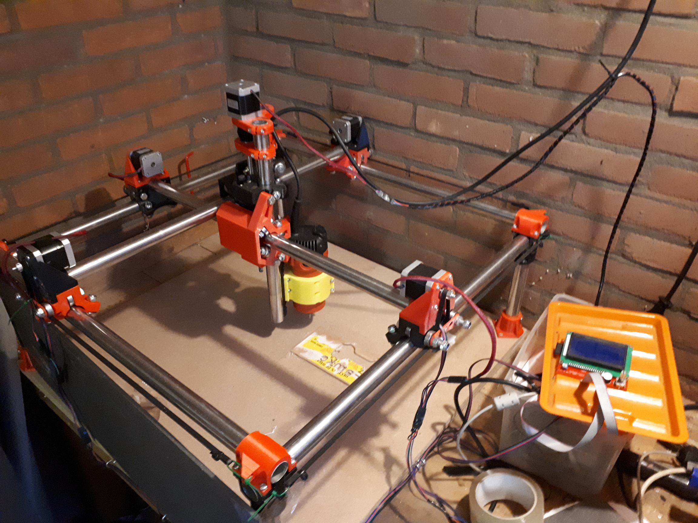

It has been a long while but finaly my build is working.
For now its tall because of a project but going to drop it down to its minimum for aluminium soon
Using a makita m3700 as a spindle and it works like a charm.
Still learning the basics with fusion cam but getting there.

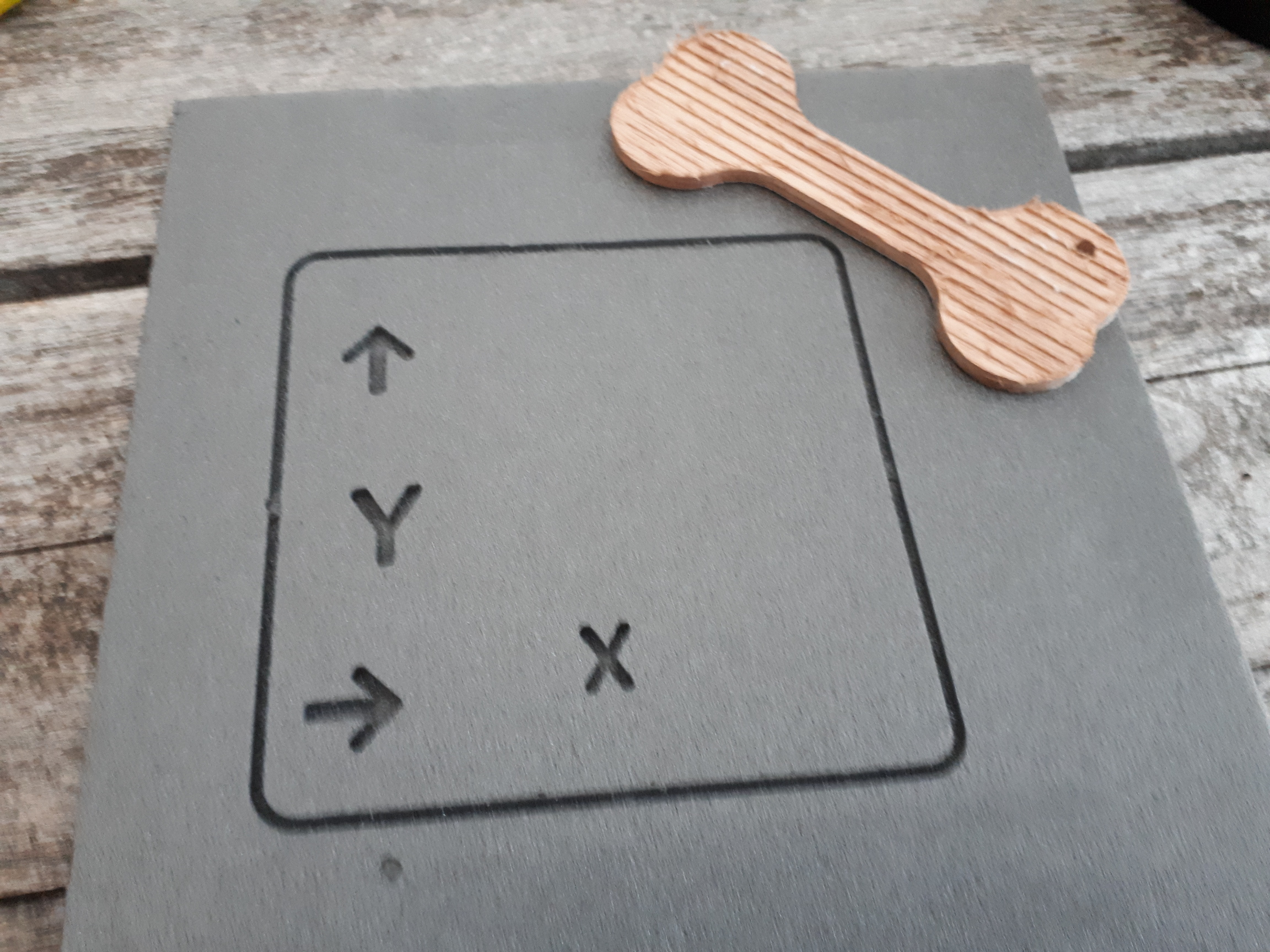

First parts, XY size/squarness/axis check and a facing and boring test.
Facing of the “bone” is rough, not completely sure why but fusion might give a bit to much stepover.
Size is spot on.
Using a 2mm endmill currently.
Need to source some longer 2 and 3mm endmills with 6mm shank because these are only 3mm long but rigid.
Bunch of 1 and 2 flute endmills ordered to play with, regular high speed steel and carbide.

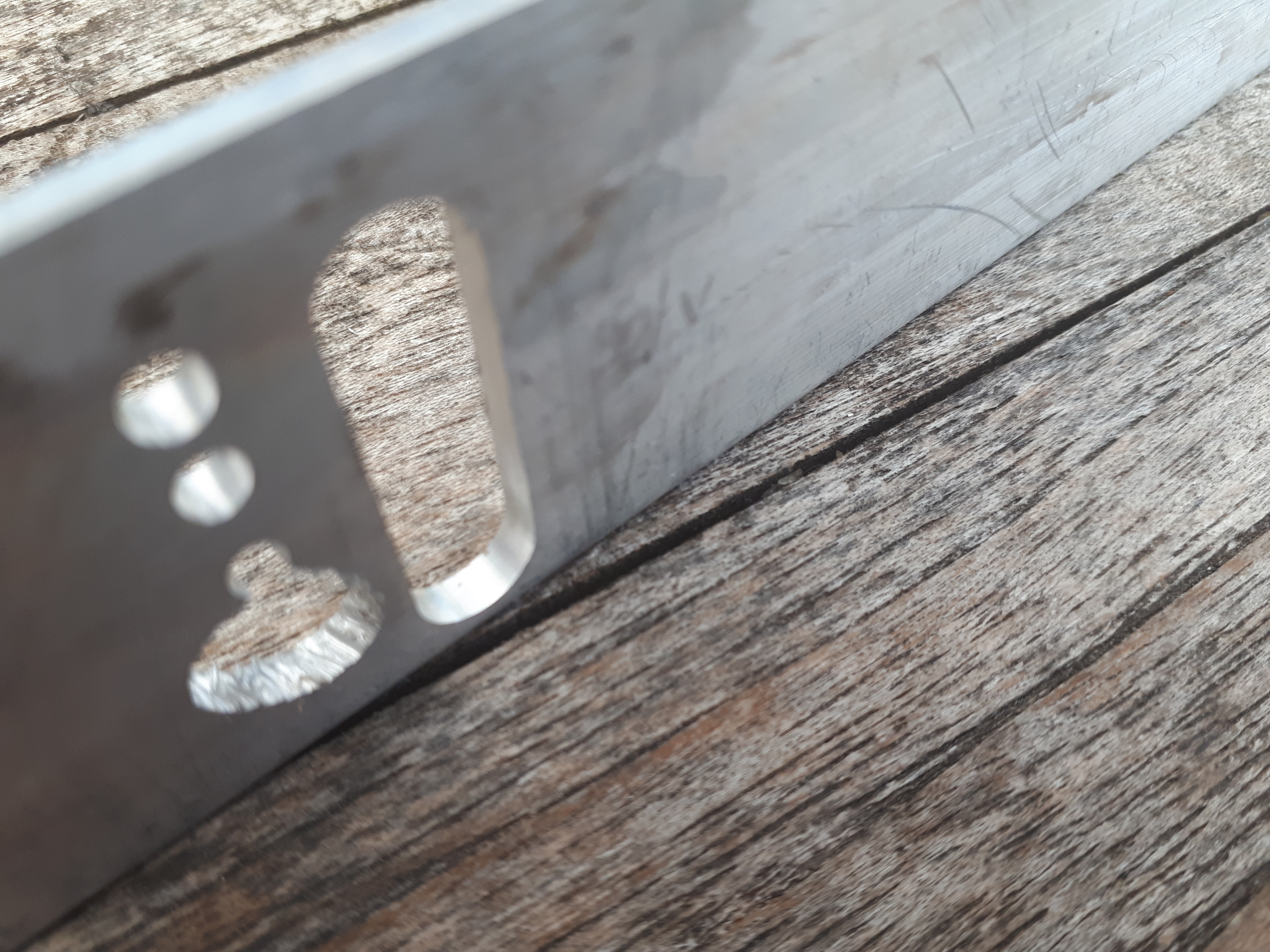

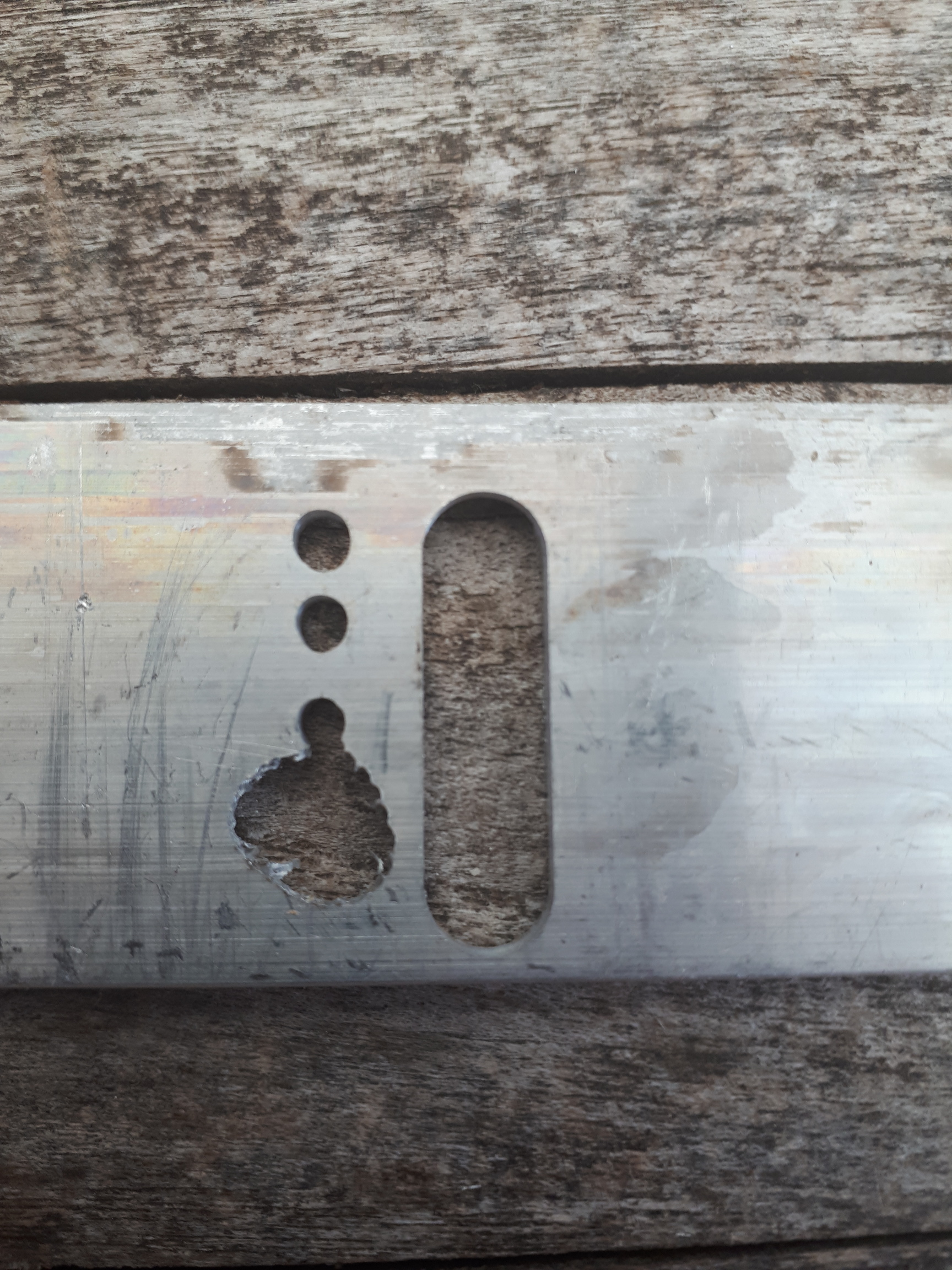

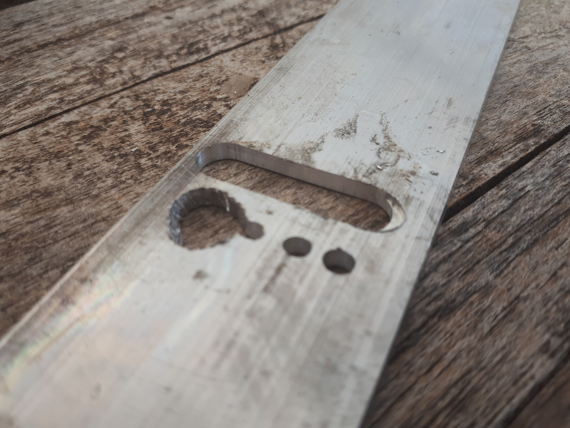

Tried my had at aluminum today.
After some issues with the first attempt with aluminum welding to the endmill it went pretty good until I started a boring operation.
Need to ramp way slower and also need more rigidity.
Slot was done with adaptive clearing (in 2 goes)
350mm/m, 1mm doc 2 finish passes followed by a spring pass.
2mm hss 2 flute endmill.
For the holes I used the settings fusion gave me but they need to be much slower due to the lack of rigidity.

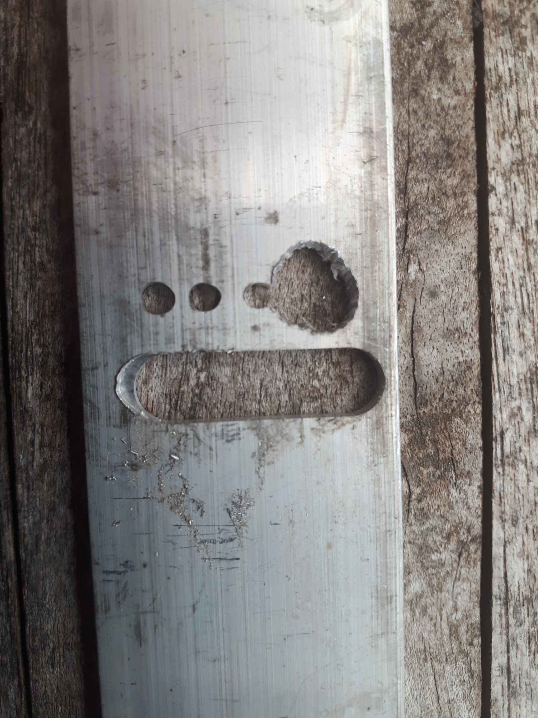

That big old hole was the result of the to aggressive boring operation.
The other 2 holes are also not round as can be seen in the picture
I am however very happy with the result of the finish of the slot
As can be seen from the other side it did produce a good and dimensionally accurate slot
