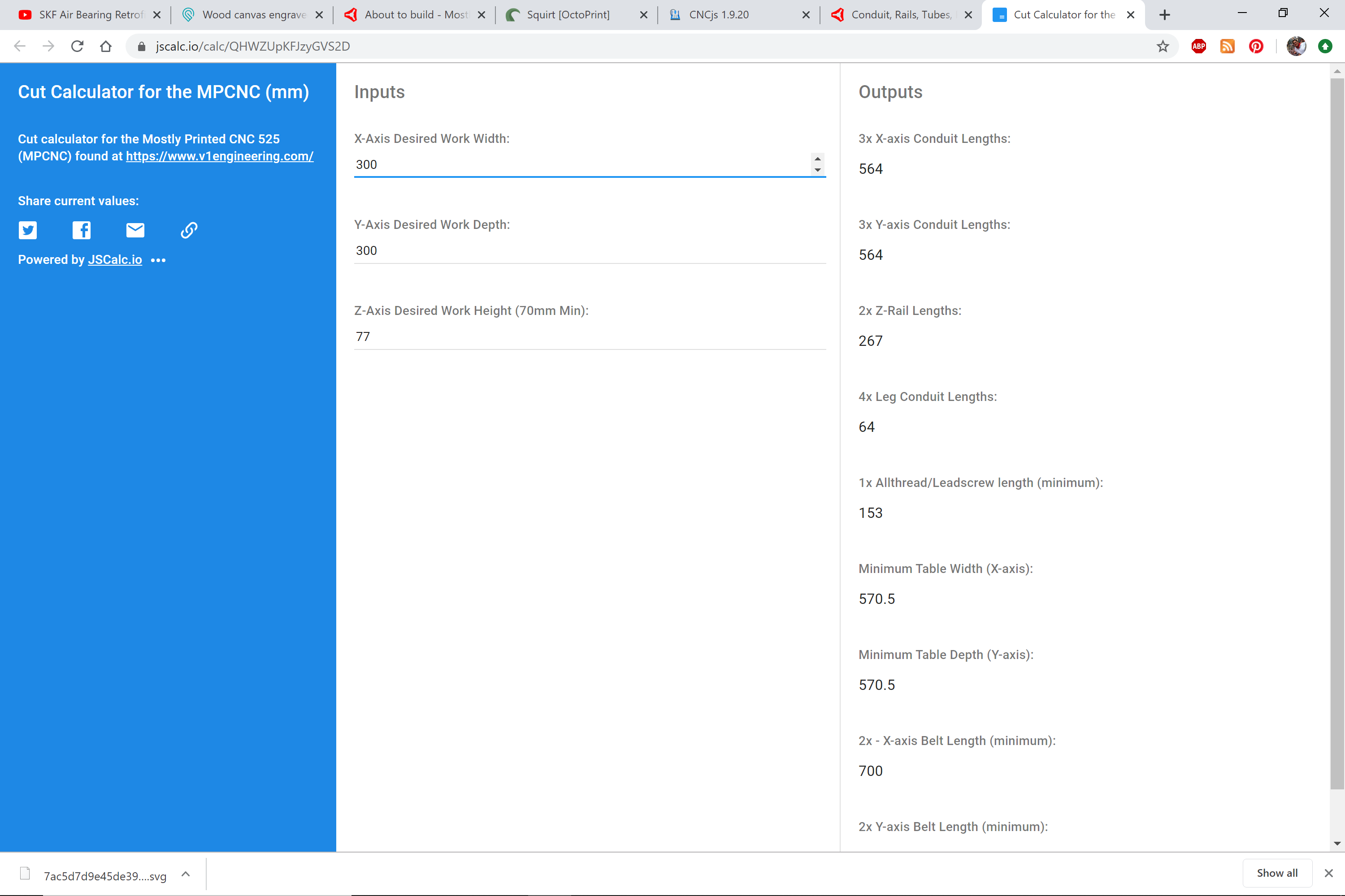

Have you checked out the cut calculator?
That would require a 570.5mm by 570.5mm table dimension with 564mm x 564mm perimeter conduits.

I did try that calculator before I posted and I got lost as all get out so ran off to here.

Btw, the calculator tells me I need at least four 10 foot EMT pieces which blew me away so I must have been using that calc wrong.
Yeah, I’m seeing one 10’ and one 5’, and that’s rounding up to the nearest 1/4"
10’ : 4@22.25" + 2@11.25" + 3@2.75"
5’ : 2@22.25" + 1@2.75"
6@ 22.25" for X and Y axis
2@ 11.25" for Z axis
4@ 2.75" for legs.
That should get you a 300mm x 300mm x 77mm work area.
edit: I did cheat… https://www.optimalprograms.com/
