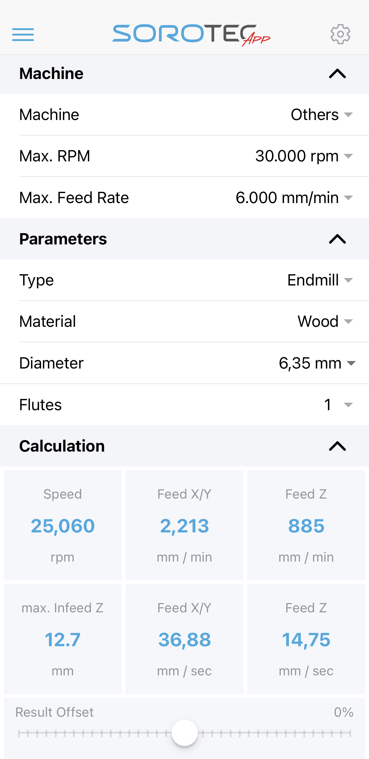

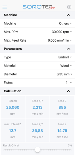

I am using bits from Sorotec, a german company for cnc stuff. They have a great calculator app for their bits. For a 1-flute 1/4in (6.35mm) bit I get 2200 mm/min @25k rpm for normal wood.

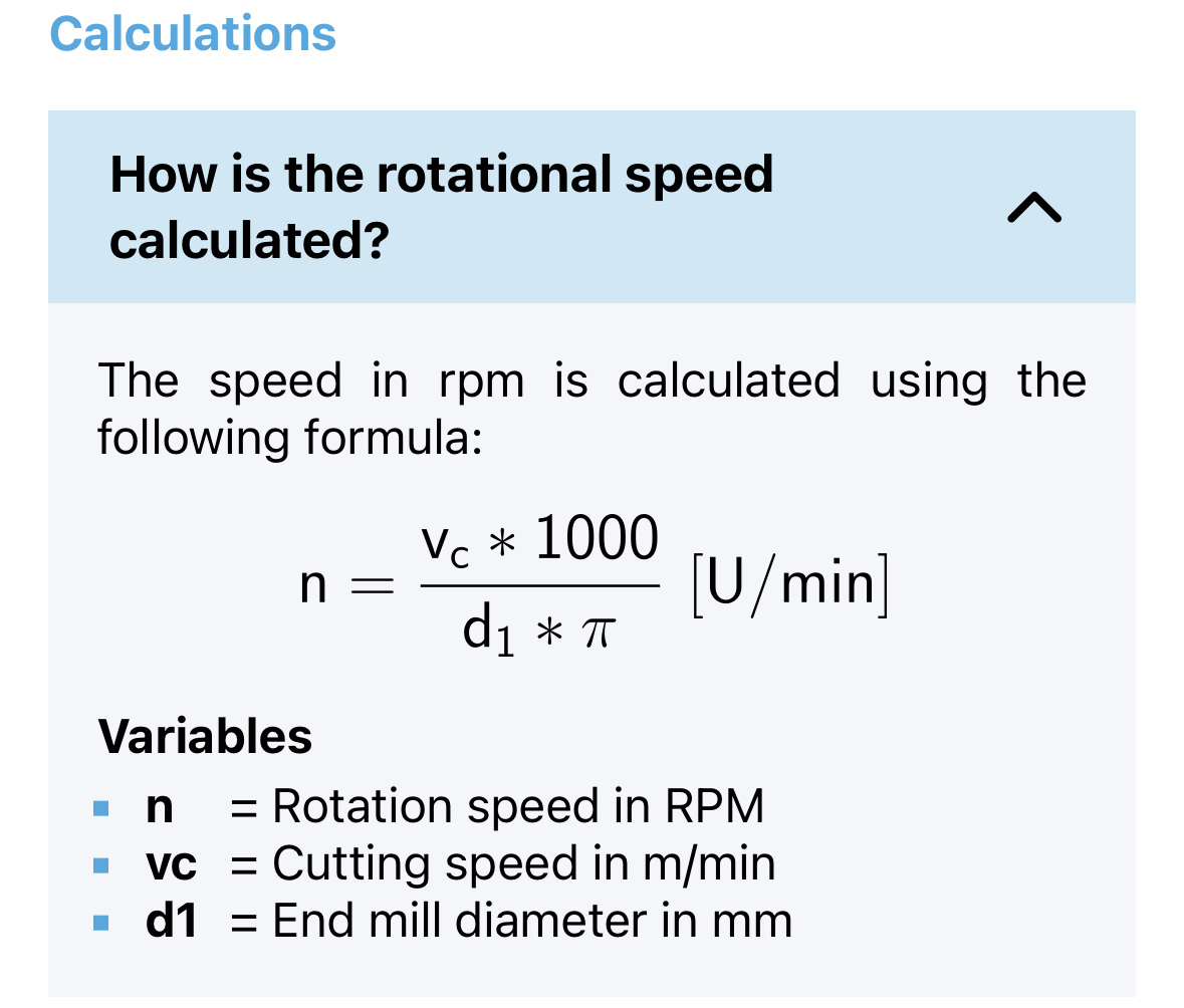

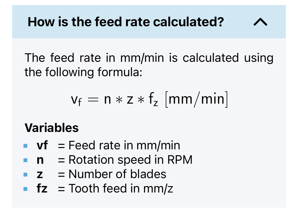

Basis for wood and that bit is a cutting speed of 500 m/min and a tooth feed of 0.0883 mm/tooth
The values for cutting speed and tooth feed are the ones that are dependent of the material. If you are lucky, the bit manufacturer has some values for those to start with and tune them to your material.
For me the feeds and speeds of the calculator app are working almost on first try.
Screenshot of the result.

There is. You can also see that in soft wood the doc is diameter X2, but it’s a little slow then.
