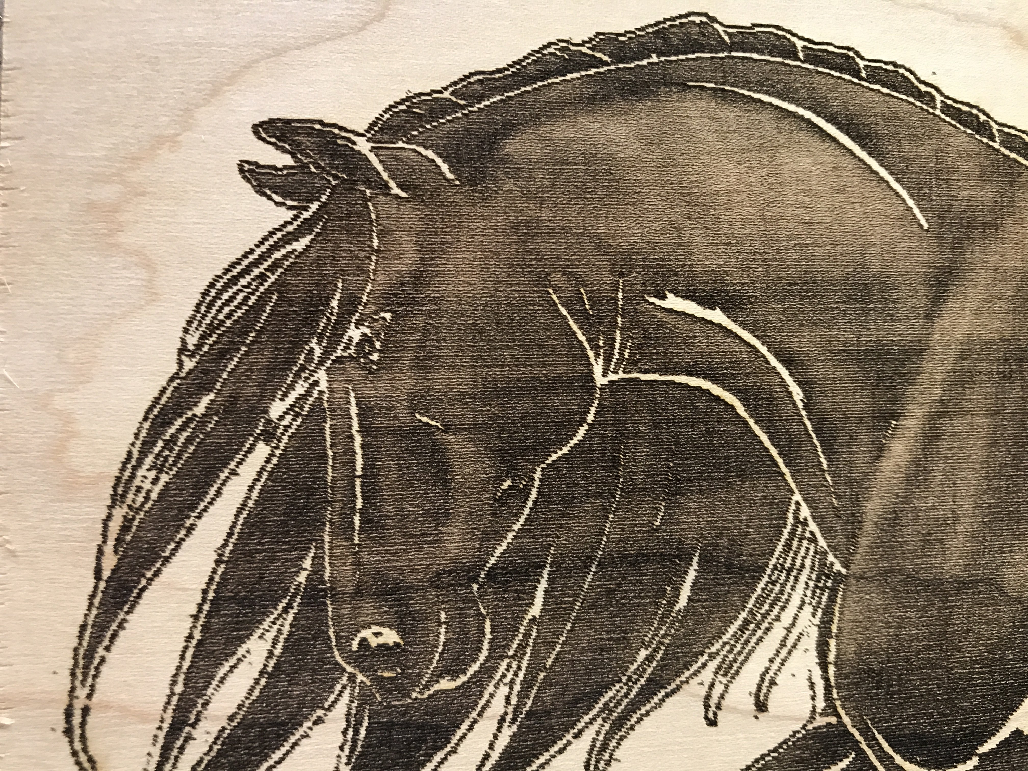

So… I am making something for my girls 8th birthday. She loves horses! Since I have the laser attached I decided to try my hand at a laser engraving using Image 2 GCode for the MPCNC. Cool program. But I realized I didn’t have a clue what speed to use with my laser on the wood I had chosen. So I made a cool Gcode file that will allow me to test the effect of a laser engraver on different materials at different power levels and different speeds. I will be posting that file on Thingiverse in the near future if anyone wants a copy. Anyway. Here are the results.
This is the results of a version 1 of the test file.
[attachment file=83309]
[attachment file=83310]
I decided to use the 10mm/s line in the Image2Gcode app. I should have gone with the 12 mm/s. But still it looks good enough. She will love it.
[attachment file=83311]
[attachment file=83312]
[attachment file=83313]
Here is the original png. The light grey is lighter than my engraving so like I said I am sure my speed was too slow.
I Also noticed that the really black spots under the belly turned out to be blank. ??? Oh well. Maybe it was the image file.
Shoot that is something to do with certain versions or settings in the program. I need to try to figure that out before I add it to the laser page. It was an issue but I am almost certain it was fixed.
Hmmm. I downloaded it from Github. https://github.com/villamany/3dpBurner-Image2Gcode When I open the copy I have the help about mentions it is v.6 modified 2/20/2016. If that information helps in any way.
Can you try this one out? I can’t play with my laser today.
https://www.v1engineering.com/forum/topic/image2gcode-free-raster-image-laser-engraving-software-modified-for-mpcnc/page/10/#post-60811
Yeah! I’ll try it out. The problem (confusion) is there appears to be several different versions. I got confused when I read that thread last week and wasn’t sure what version to use. So I just reread the entire thread.
Github - Vilmany URL . (Version 1.0 Says it is 4 years old.) This is even the one listed in the Help about and the first version that comes up on google. This is the one I had with the dark bug on horizontal.
Then in the thread you just linked me to… The first post says this one it the most current version…
Github - Uthayne URL. (Version 1.0 says it is 3 years old) According to users this one also has the Dark spot bug.
But then I see your edit note in that first post that links to a direct download post later on page 8 in the thread. This one appears to be a v1.1 even though the help about still says V0.6. Reading along the middle of page 10 it seems that this version 1.1 has an issue where it uses commas instead of decimal points. It also suffers from the dark spot bug. (Looking at Gcode it produced.)
Then there is another version that Josef made and posted on page 10 that fixed the dark black bug. So it looks like this is the best version. (Just by looking at the gcode they produced. I can see the difference.) I’ll test a burn later tonight.
But it looks like that first post should be edited to point to this 4th version. I am calling it 1.x.
I knew it was a mess but didn’t think it was that bad. Let me know what seems to work and I will link it on the laser page. Then hopefully we will get more people trying/confirming it.
Well bad news. The black spot bug is in the first three versions I mentioned.
The fourth version doesn’t but it has a different bug. With Png files it makes anything that is transparent black. So it works with bmp and jpg.
All four versions ignore the speed that the user enters.
So it looks like we need someone to get in and fix some bugs. Otherwise this is what we would need to say. Use the fourth version. Don’t use png files with transparent pixels. After the gcode file is created move the Fxxxx command to one of the G1 lines. If nobody volunteers I might be able to clone the branch and see what I can do next week.
