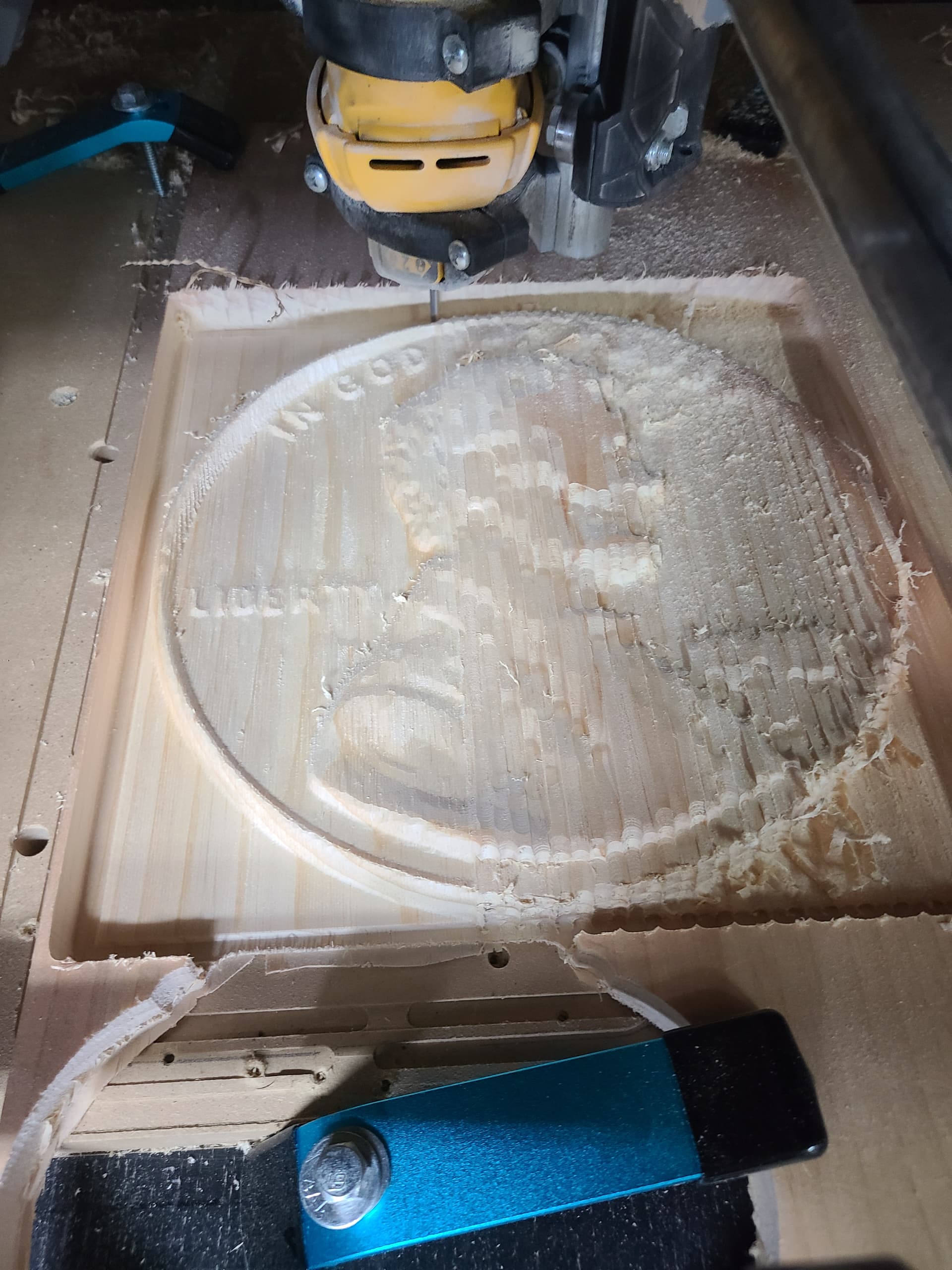

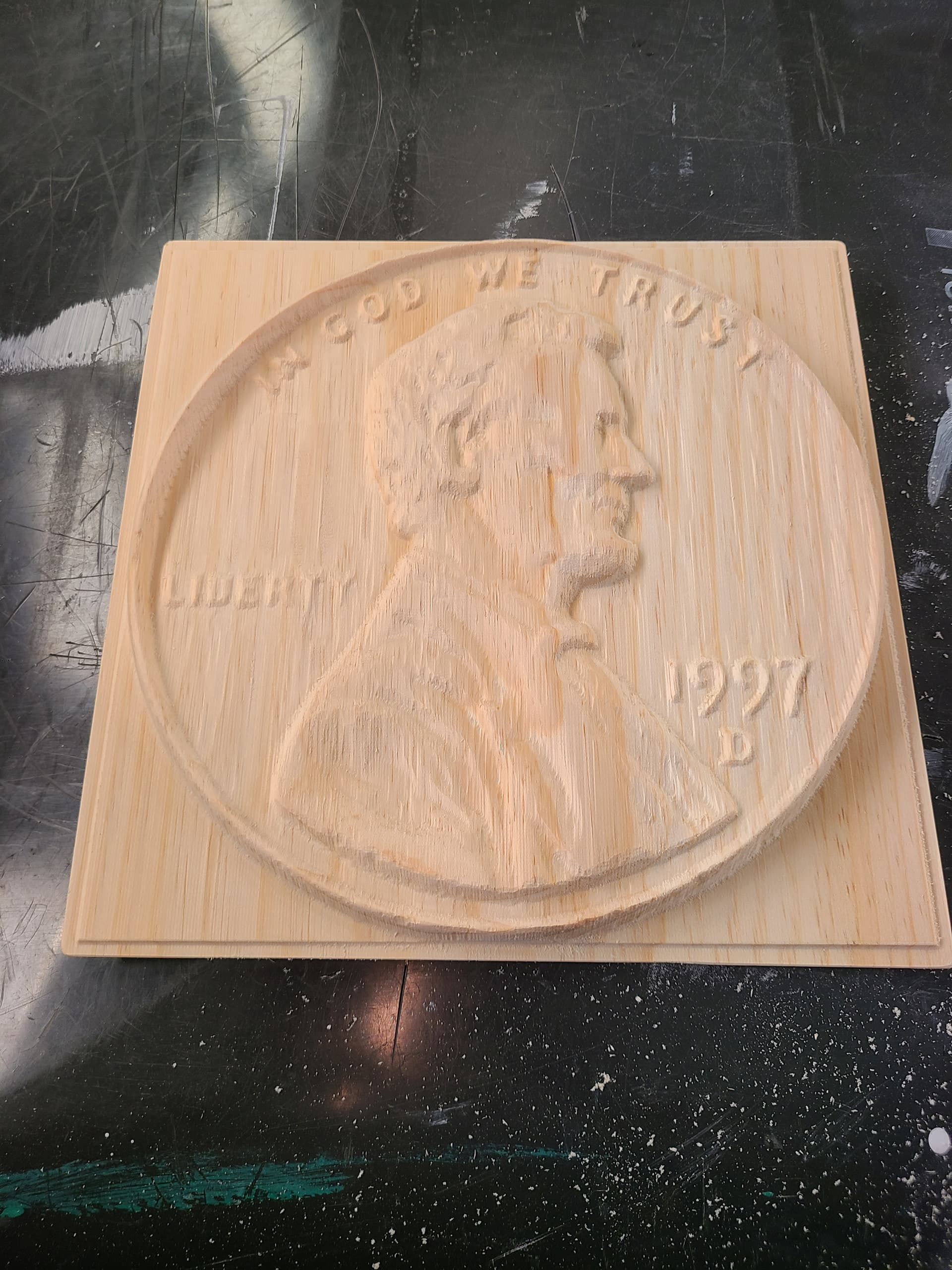

Here’s a little test project that I did today and had low expectations, but turned out really well.

What settings were those and would you change any of them?
Used a 1/8" ballnose 24mm/s at 15% stepover for the finishing pass. 1/4" 2flute 4mm doc for roughing. Might reduce the stepover from 15 to 10 or 8%. Maybe a smaller diameter ballnose.
Took a little over 2.5 hours.
