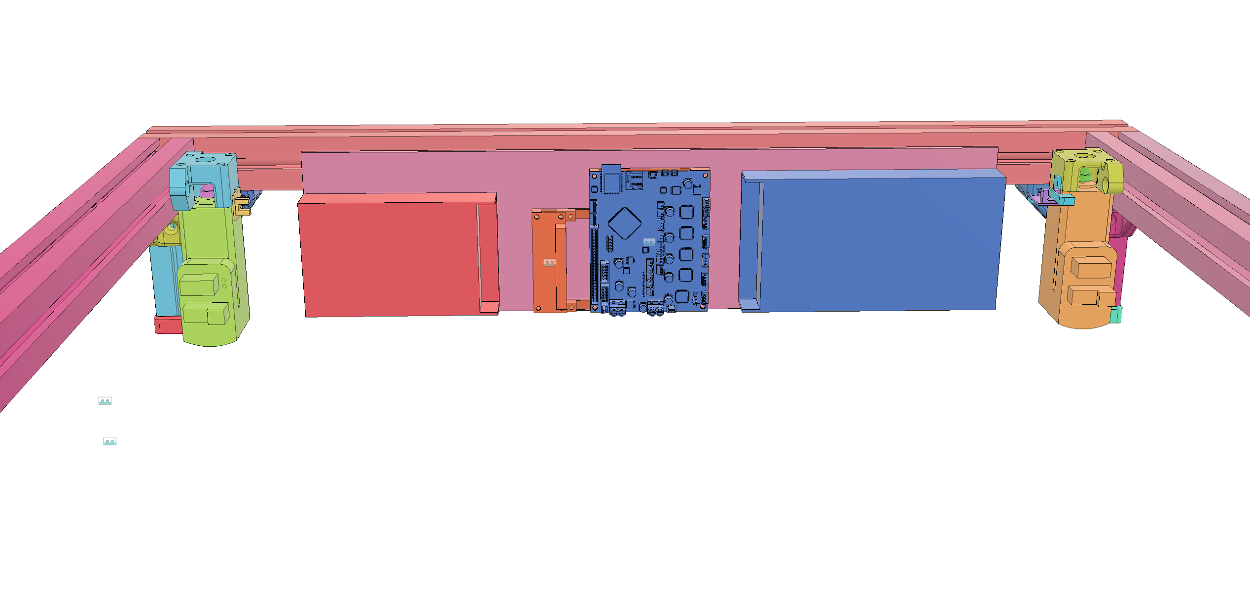

I have built the top cover and XY frame, and mounted the electronics. I am in the process of remaking the cables to the motors (MUCH shorter now) and redesigning the Y axis bearing/pulley blocks to be similar but a little less fragile than the previous generation. I printed one of them and will print the other tonight. The new bearing block is printed in two pieces without support material and clamps down on the 16 mm square tube X axis. I hope to have the mechanism up and running by this weekend, and then I’ll start on the new sandbox design.

In my design, no local control panel is needed, so the electronics stays under the sandbox, out of sight. I use a Duet wifi enabled controller running as an access point so I can connect to it via my laptop or phone. I can even have it load a macro that calls pattern files on power-up, so if I take it to a public showing, I just set it down and power it up and it will start running patterns.

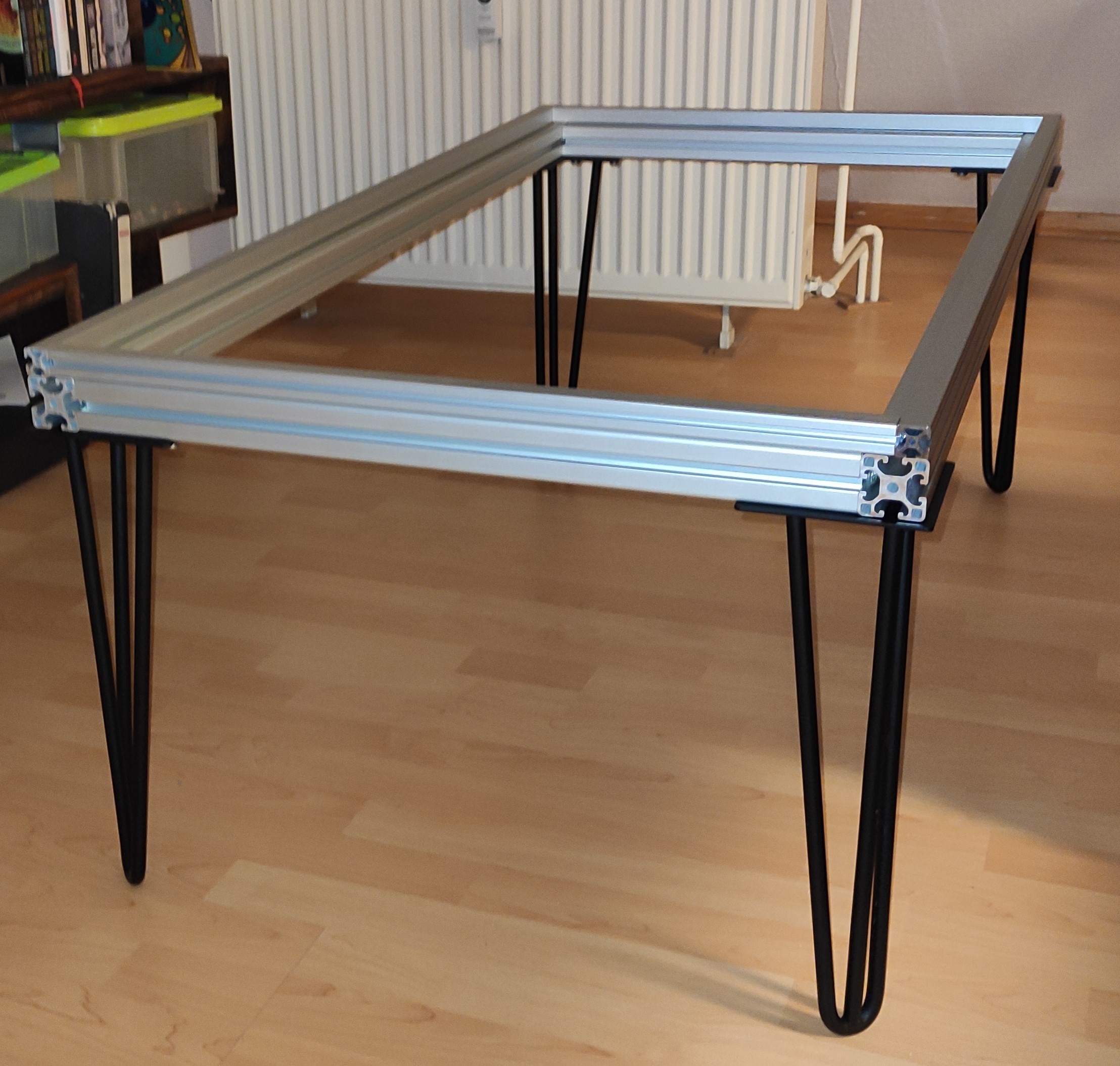

I recently started working on a Sandtable similar to yours, although I’m using 4040 extrusions:
( I don’t know yet if i will keep the hairpin legs, but for now they will work.)
Next step would be the design of motor mounts and pulley blocks etc. Since you wanted to publish your files, I would like to use these as a basis. Do you have a preliminary version of those files I could work with?
