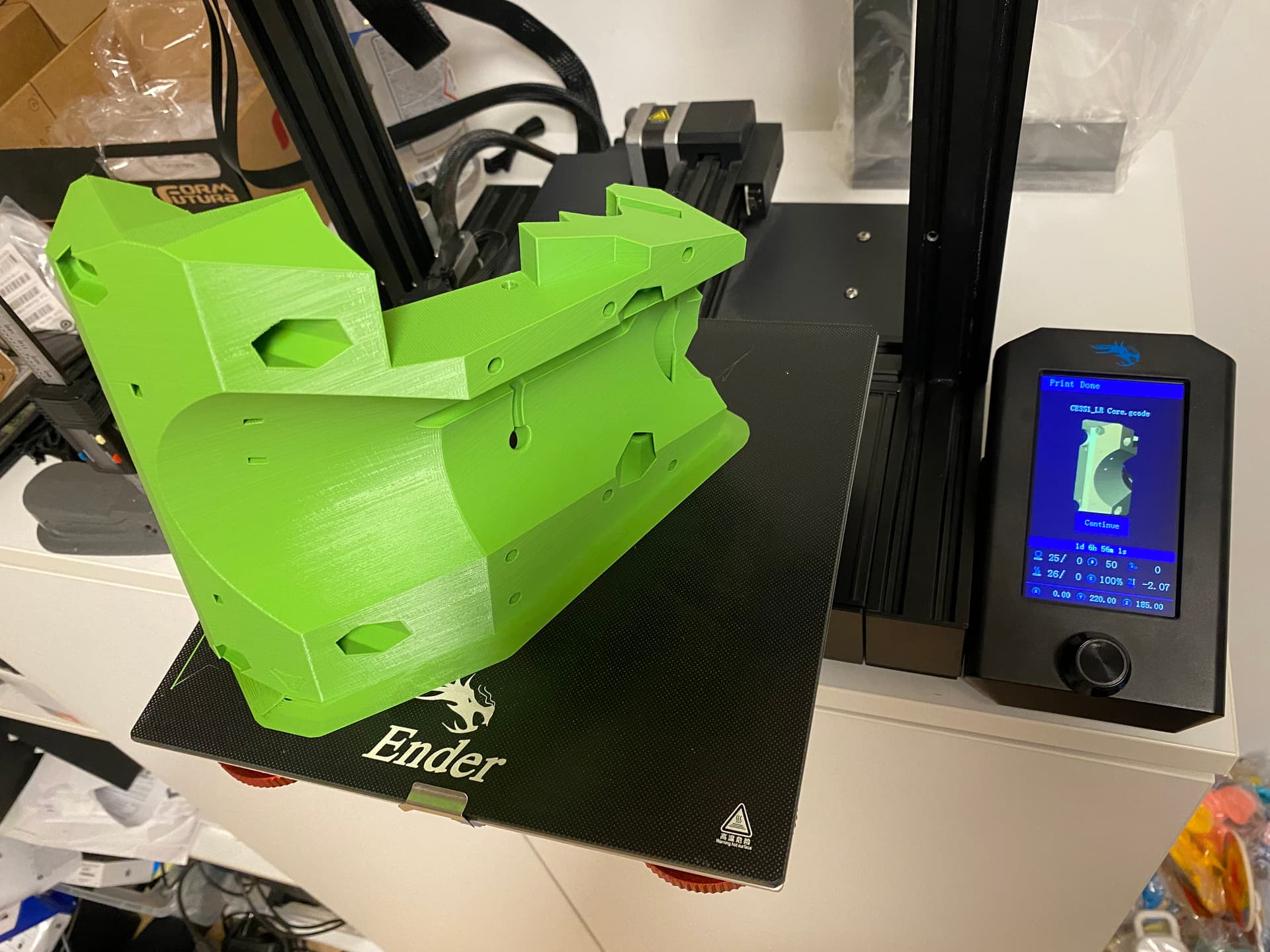

My Ender 3v2 has been sitting idle for some time and I wanted to attempt a DIY CNC build for years but never had the space, time and means to do so. Fast forward to July 2023 – me going down the youtube rabbit hole of DIY CNC and trying to figure out which build I would pick - I stumble on Doug Joseph’s and How-to-Homemade‘s videos on the LR3 on Youtube and the plan starts to form in my head to finally go ahead with a lowrider vs other alternatives.
Not sure if my printer would manage it I start printing the core on 04. August with 0.2mm layer height and a print time of 32 hours. After a night with very light sleep and some more anxious hours I come back to a finished print – that even looks decent in my eye. This is the point where I decide to commit to this.

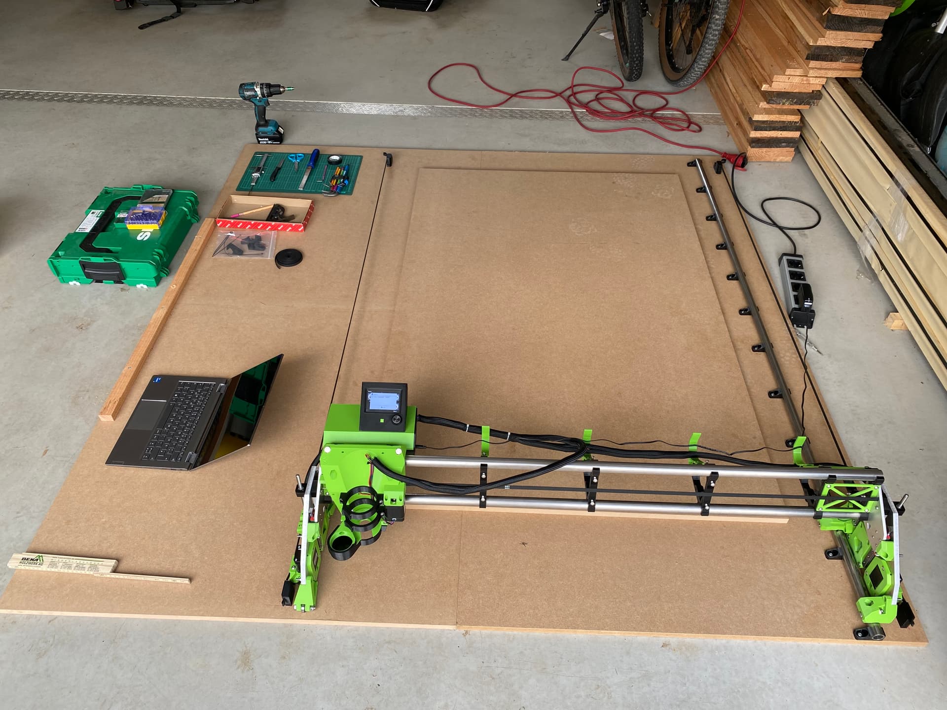

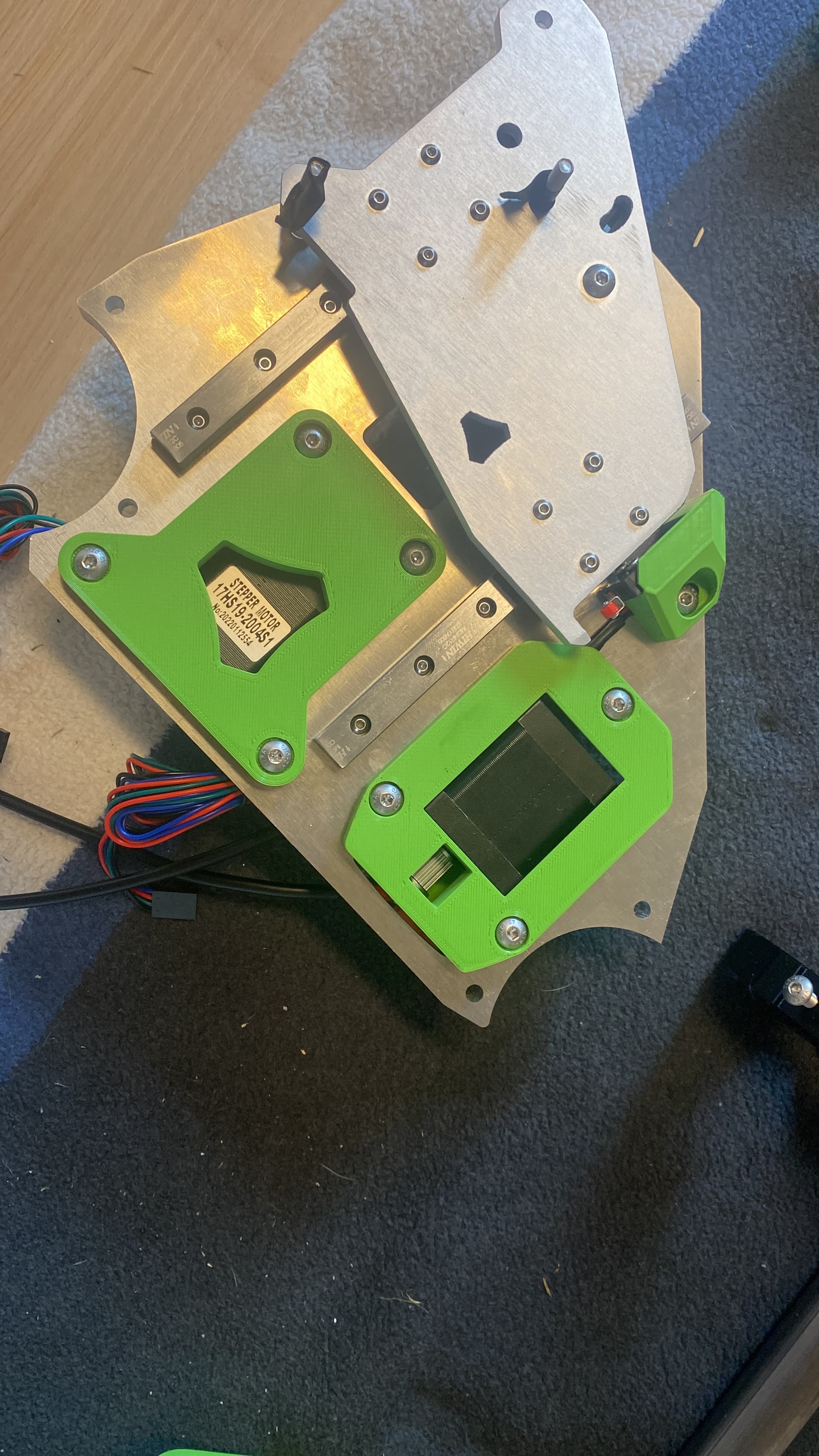

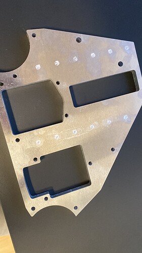

I got the 25mm Rails in Stainless Steel with 3mm wall thickness and decided to order both the yz and xz plates from an on-demand laser cutting shop in 10mm and 6mm Aluminum as I had no other way to get milled parts and well… If I already custom order them I can get them made out of Metal and after 20 working days they finally arrived.
One Problem: I did not think through how I would attach the Linear rails to the Aluminum – Wood Screws wont work… At least the laser already marked the spot to drill from the provided DXF.
Well let’s order a set of Taps, graduate the „How to tap Holes“-YoutubeAcademy™ and manually tap 24 M3 Holes– New skill unlocked. It worked! On to further assembly.

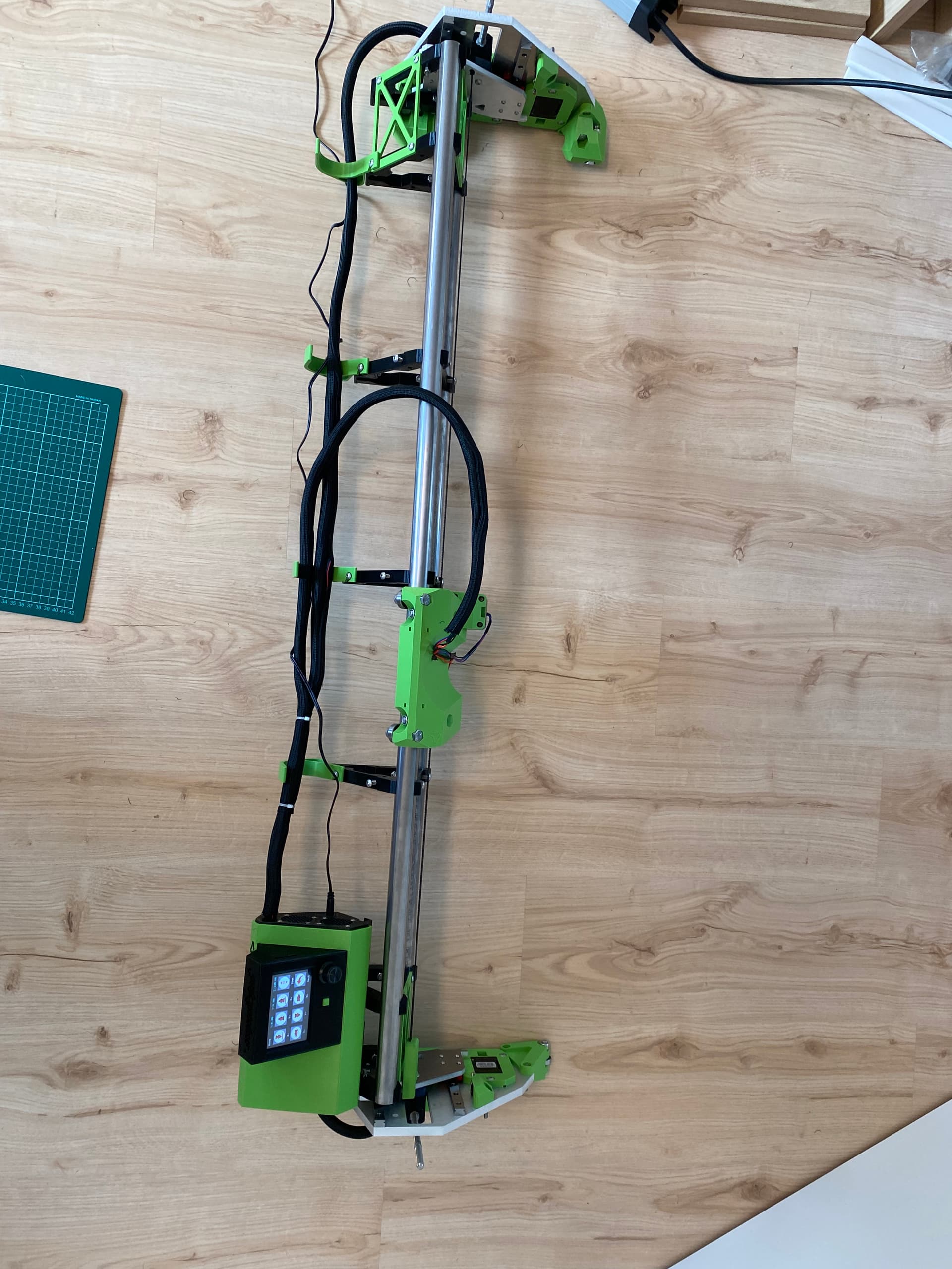

This week I was able to make the most progress thanks to some days off. A challenging part was the wiring as I never crimped a Dupont Connector before in my life that i needed for the wire extenders I had to make myself.
Testing the connections and X-Axis:

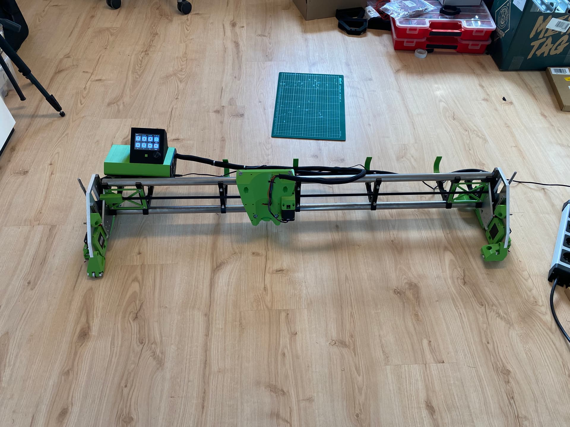

And today: IT LIVES on X&Z
In its final form it will have roughly a cutting capacity of 1000x1600mm due to practical reasons as I can not transport material wider than roughly 1 meter with my car. I intend to build the torsion box shared by Doug that I have already modified to my dimensions after learning the basics in Fusion 360.
Two issues I have currently:

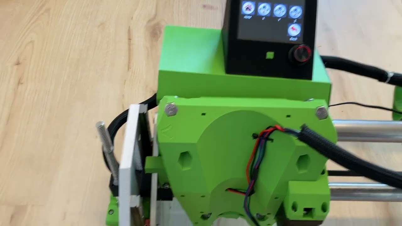

  • The Z-Axis is lightly Squealing only when driving down. I have seen another post already with someone having the same issue but The fix to add Lube did not really help. I think it is the flexible couplers that produce the noise. The noise is only present under the load of the main beam.
  • The TFT35 display returns unkown command M420 after homing but I think its solved by a firmware update from BTT if I remember reading correctly on the forum.
Today I picked up some 19mm MDF sheets from my local supplier and will try to get the first test cuts done on the weekend if I can manage time wise.
Until Here I can only thank Ryan and the Community that got me to the current state of progress through sharing knowledge here and on youtube. I learned a ton of stuff so far and really enjoy where its going.

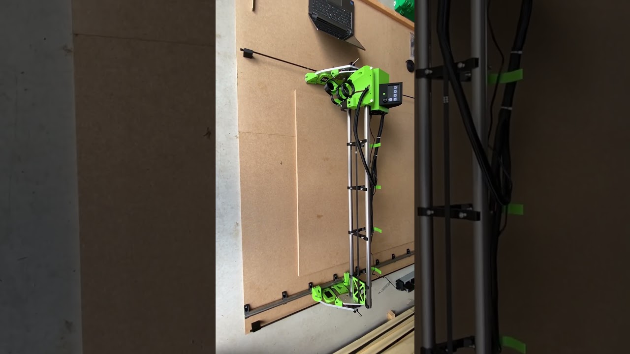

I started setting up shop in the garage on the weekend and just layed down 4 pieces of the MDF Sheets on the flattest floor that is available to me as a temporary table until I will have been able to build the table for the Lowrider - with the Lowrider. I guess it will be good enough for through cuts only.
The Y-Axis is working, I did not mess up any wiring :slight_smile:

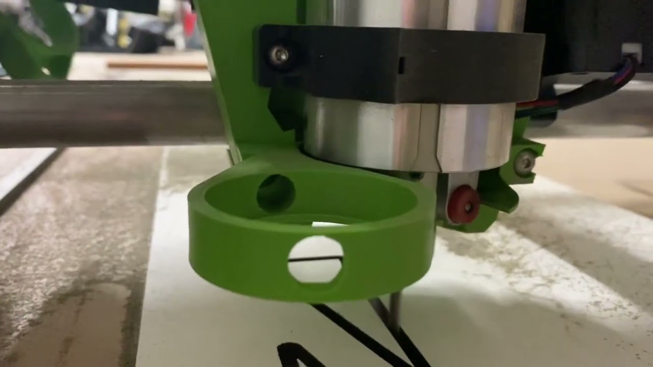

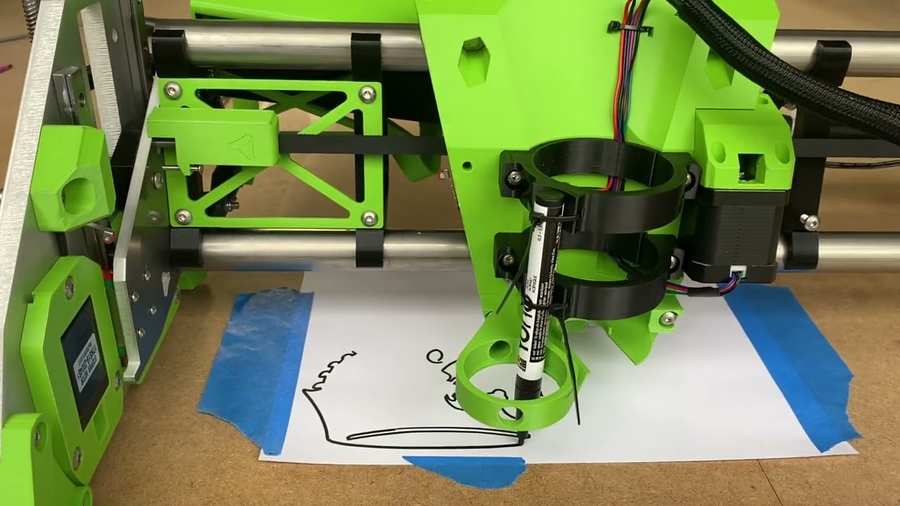

On to some squaring which I got to about 1mm difference on the diagonals, good enough for now, I still need to print a better pen holder to eliminate the potential failures for accurate measurements. I removed the pen used for the Square tests and decided its time to run the first crown. Using a very wobbly pen and way to much Z-Pressure its obviously not perfect but good enough for a half-finished machine. A Proper crown will follow later:
(Squeaking warning - One pen was harmed in the making of this video)

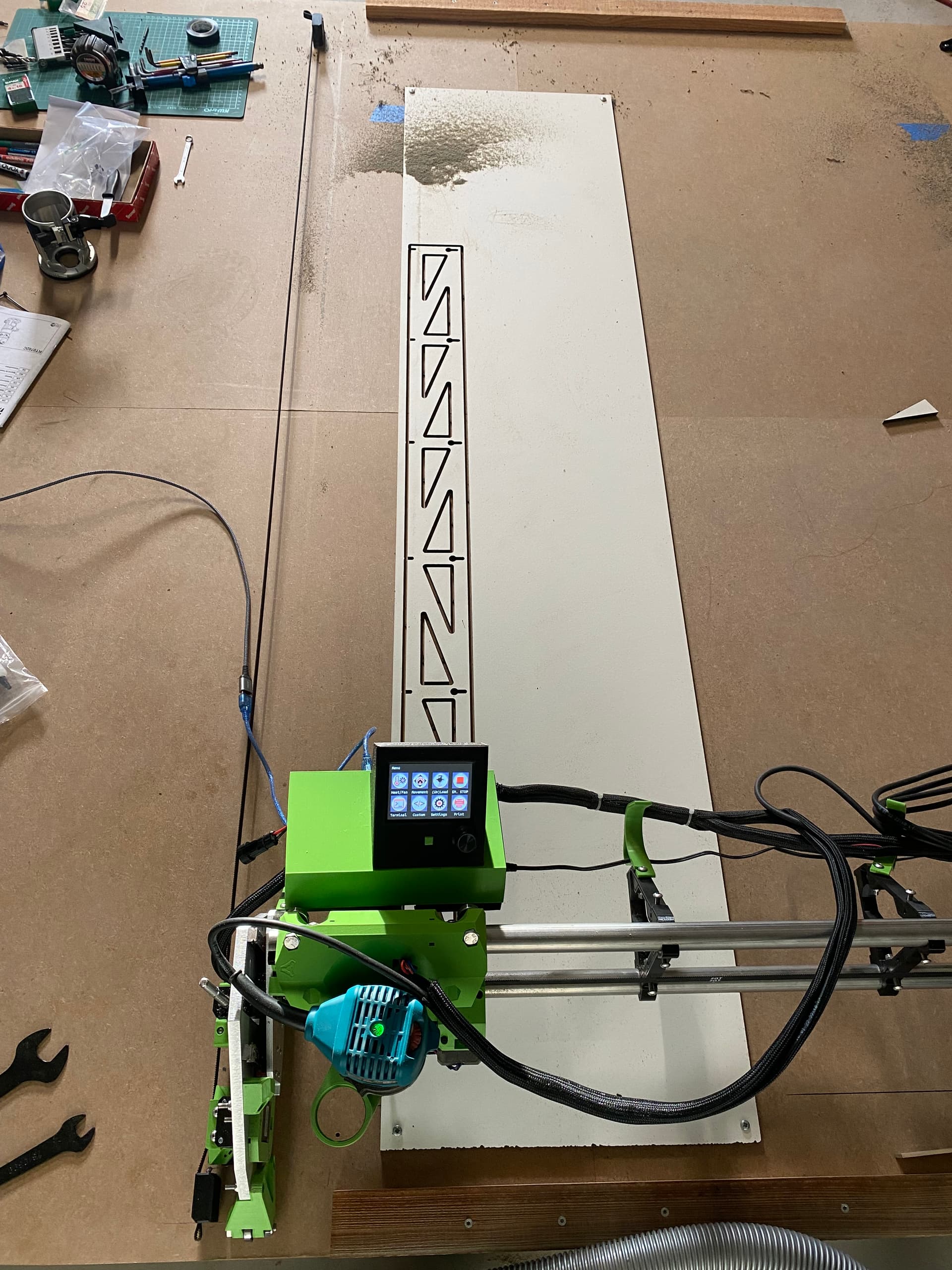

Fast forward to yesterday, its time for the first cuts…
Building a CNC machine is a learning experience as exemplified by this picture

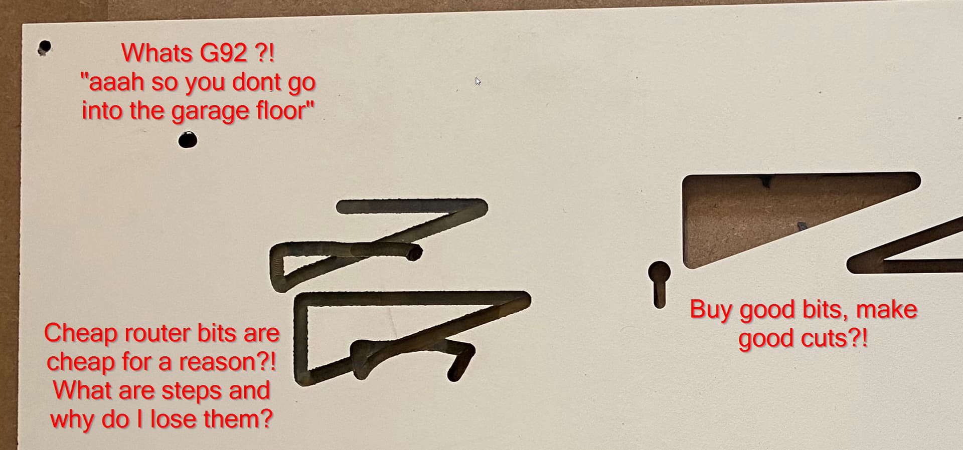

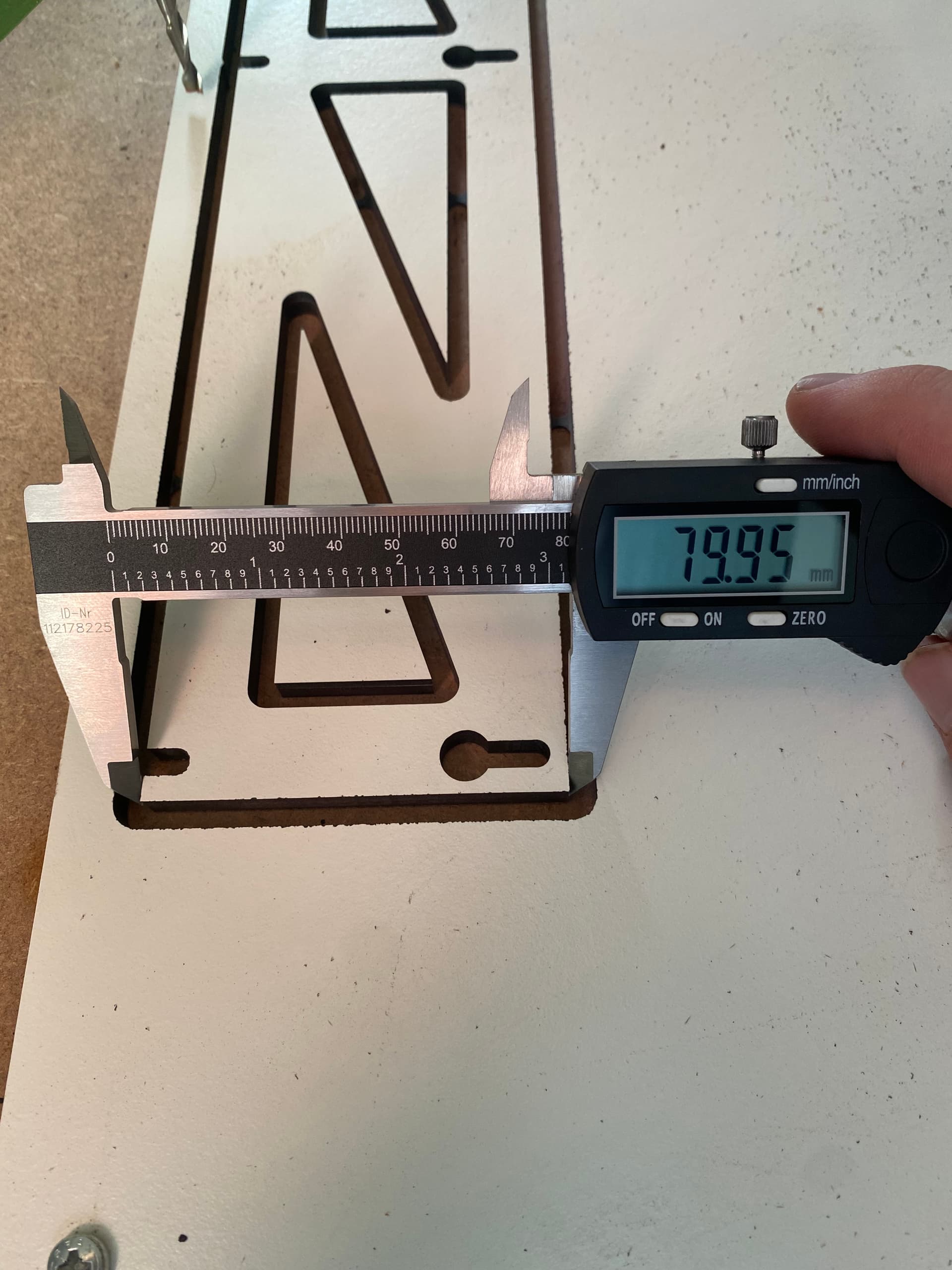

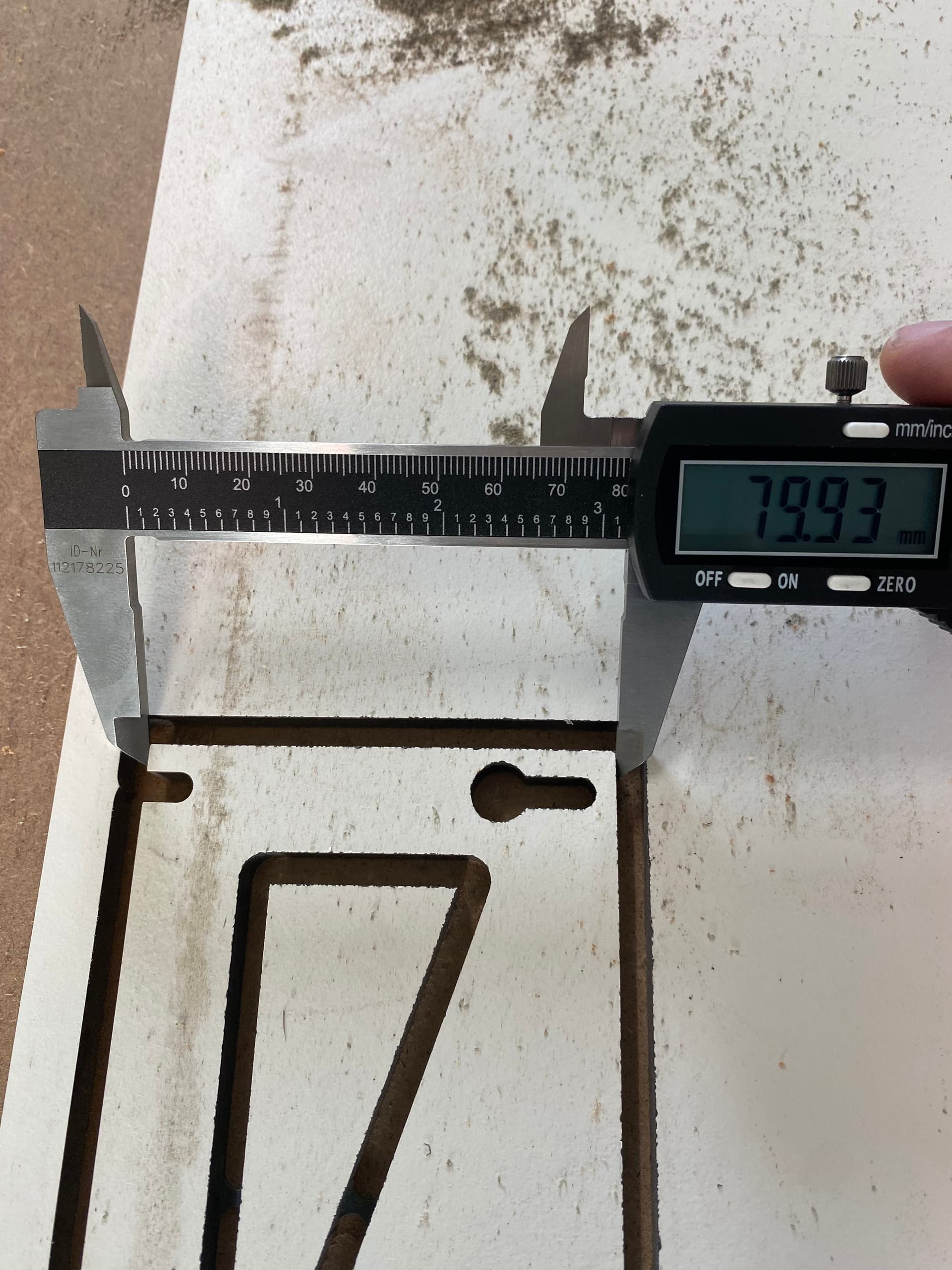

I have some 8mm HPL material lying around from a previous project and decided to make my life hard by cutting the struts out of those sheets. HPL is a very hard but also very rigid material so it should be a good fit. After some lessons learned the first cut is complete. Since today evening I now have two of the struts cut and im pretty impressed by the accuracy for a temporary machine setup. (Maybe I got lucky, I dont expect that this is repeatable)
Cutting Video:
One more strut left to cut then its disassembly time and probably on the weekend or next week starting with the torsion box table.
Hold onto something, I am going to tell you a secret: If you built the machine right, it is repeatable as often as you like! There is a tiny computer driving that thing that knows exactly where to go! Craaaazy, I tell you, man! :smiley:
