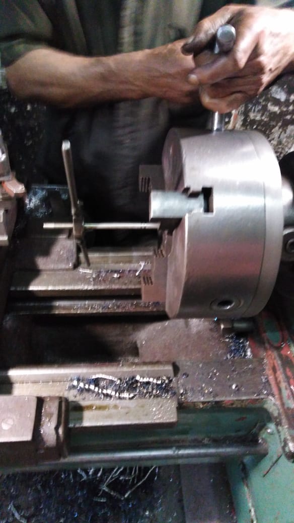

Sourcing locally the tubing was a challenge, ended up with clothes rack railing in 25mm OD, chrome plated, might not be the best, I expect some wear and peel up, but for a total cost of 15$ (for 10 meters…), I will have a go with it!

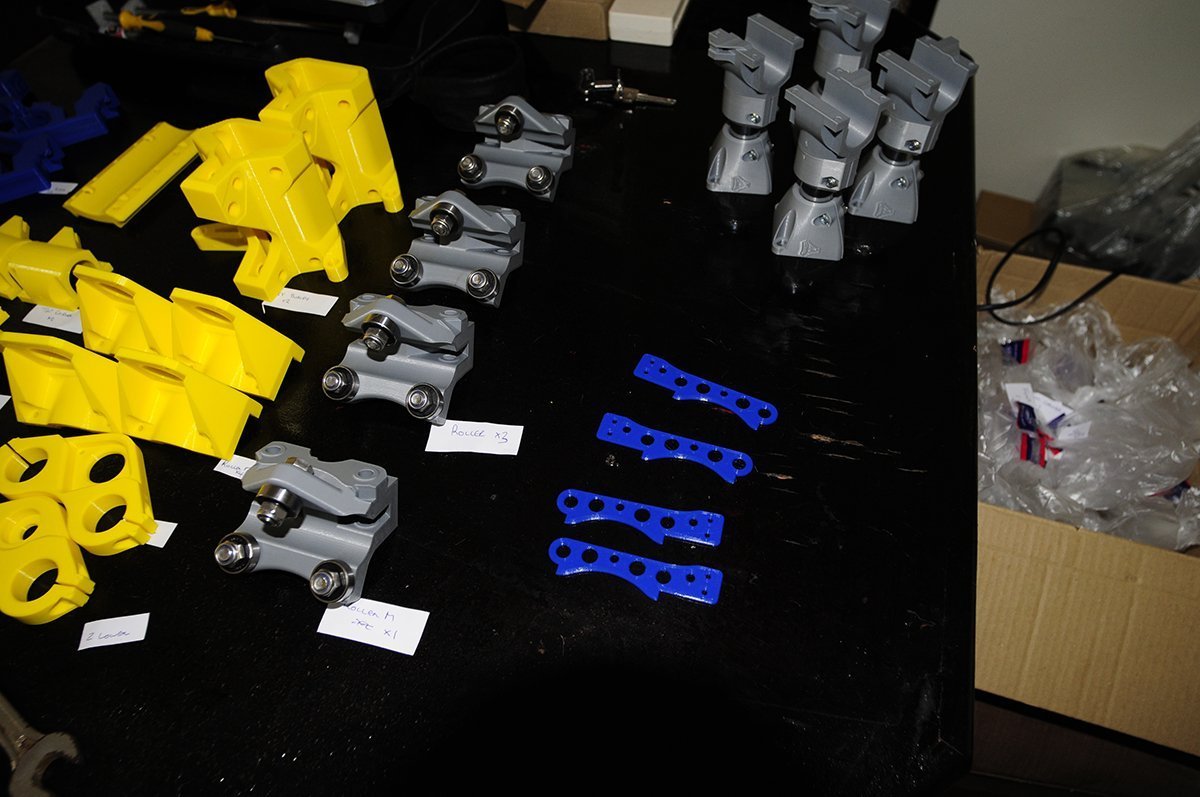

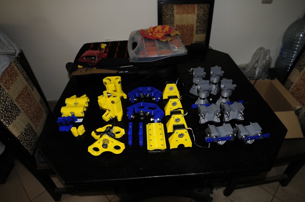

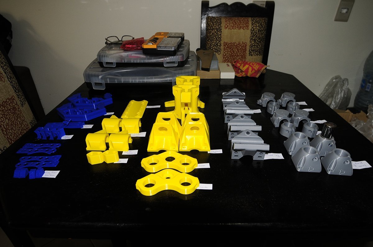

Yesterday, Mr D. delivered the printed parts for the core, all well done, labelled, etc…very professional!
So, here we go, today is the beginning of the assembly!

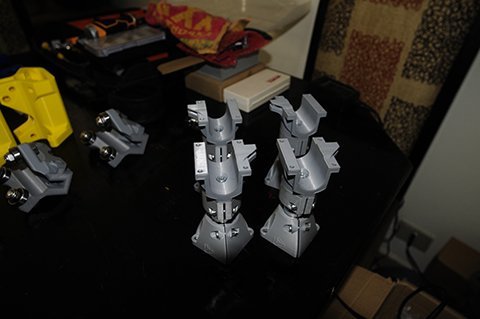

Feet assembly, done.
Roller assembly, almost done…(first question of a long to be expected list!): I decided to go for a dual end stop mod, and now I am stuck on which way to assemble the plates…
Thanks for your advice, and thanks to Ryan for making all this to happen!
Just figured out the plate mounting by looking carefully at the parts! pictures to come soon!

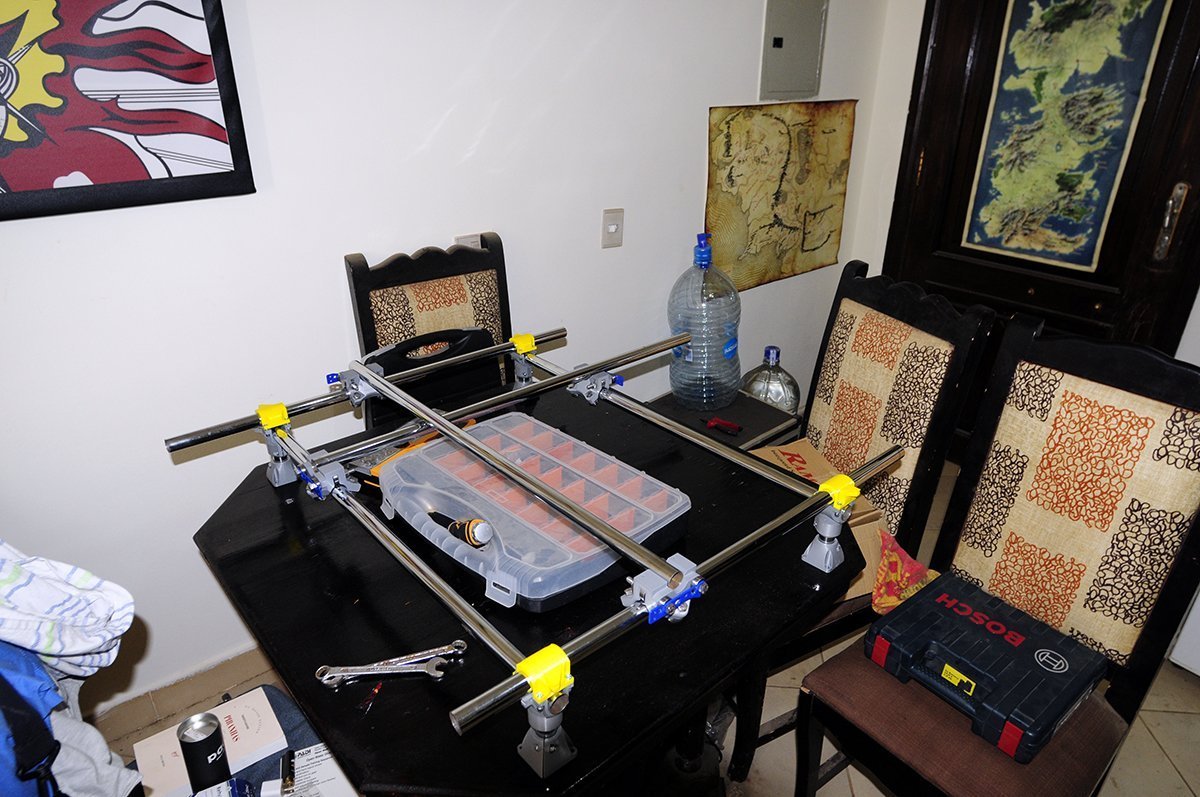

Getting there slowly, slowly…

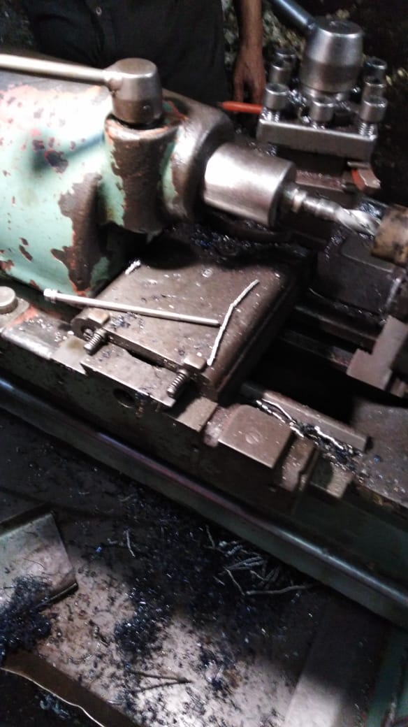

Couldn’t find a M8 x 130mm around here in Sharm, a phone call in Alexandria to an Egyptian mate, and here we go!
It’s coming together time!

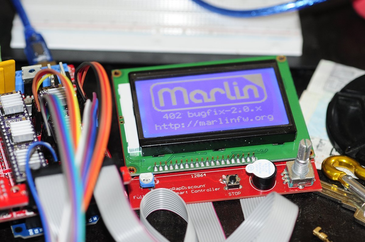

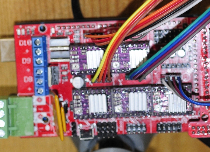

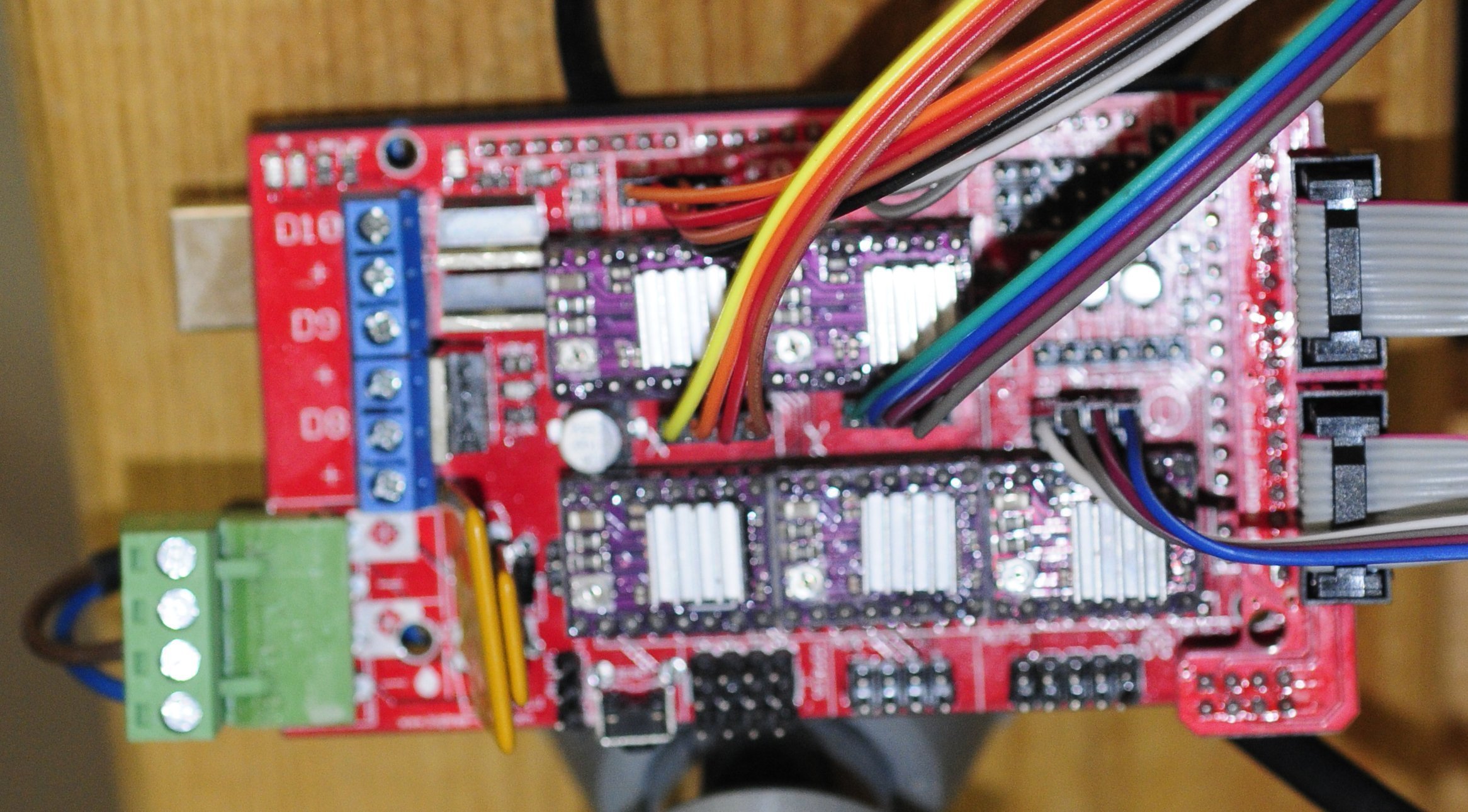

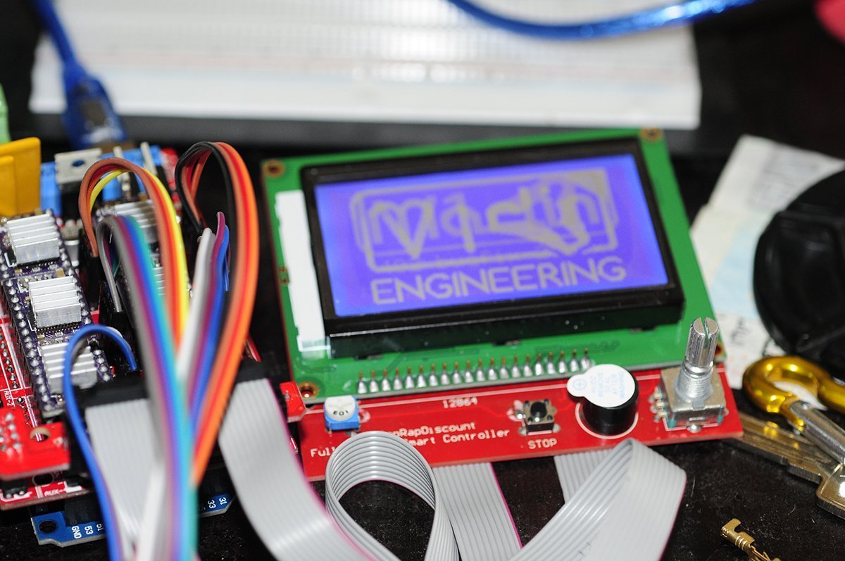

Getting there! Now electronics to sort out!
Electronics now!
Get it dirty!

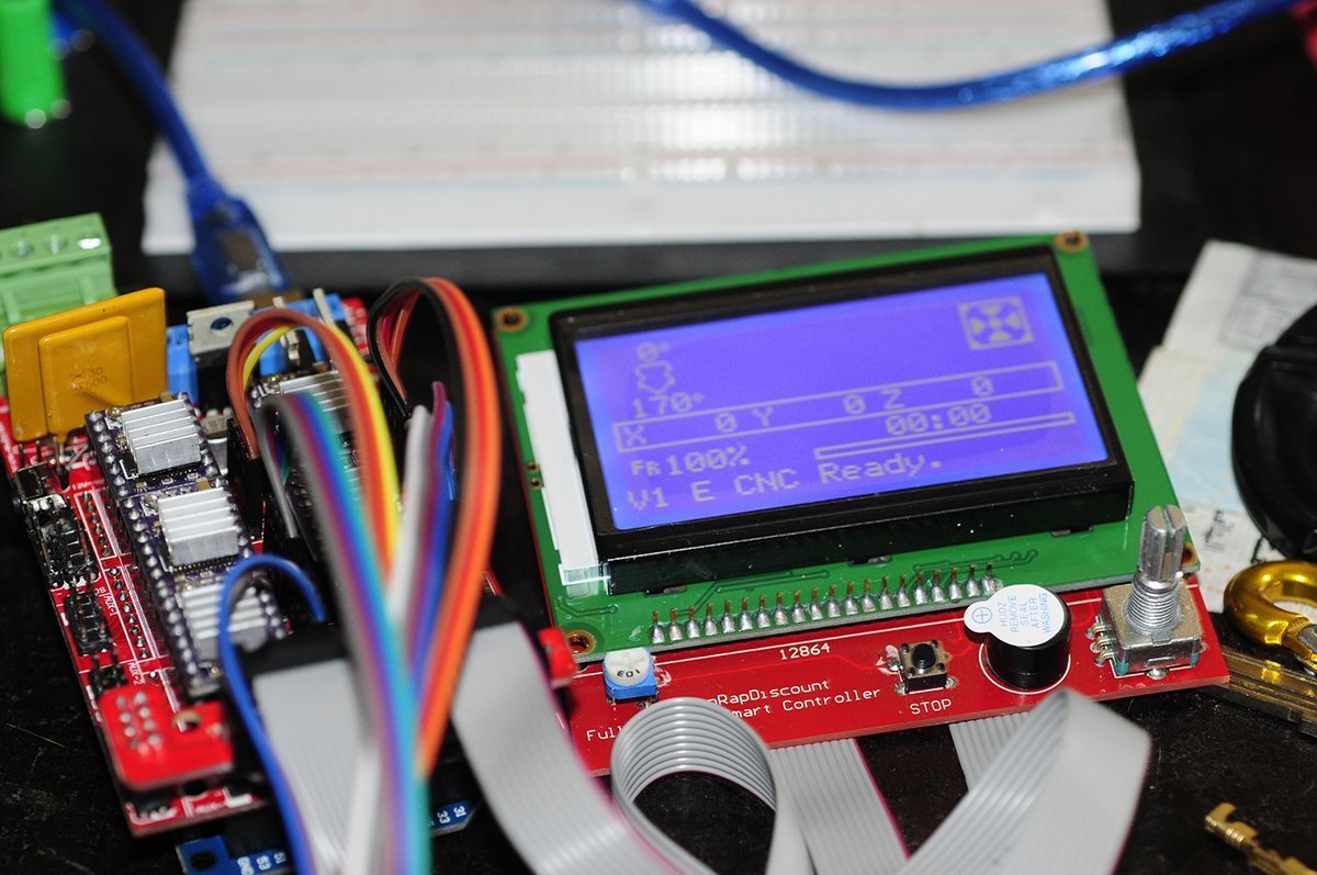

It’s Alive!
Thanks again to Ryan and all of you around there for your precious advises!
Now time for tuning, adjusting, etc…
I am not done with plenty of more questions to come!

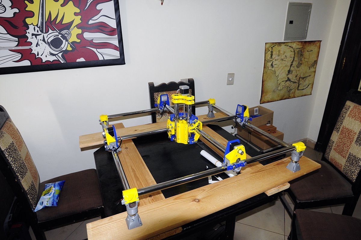

(Z motor getting very warm, very quick, X and Y motors getting warm as well, crown drawing half in the air…)
Here we go!

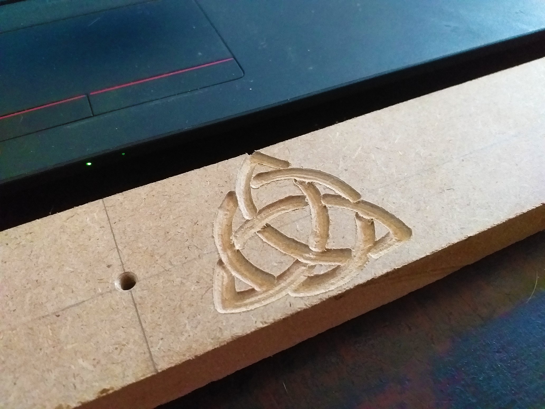

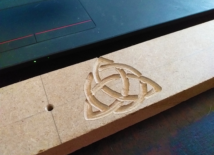

First cut with a cheap dremel copy (130W), cheap HSS ball end bit into MDF!
(5cm x 5cm, 2mm depth)
yes!
