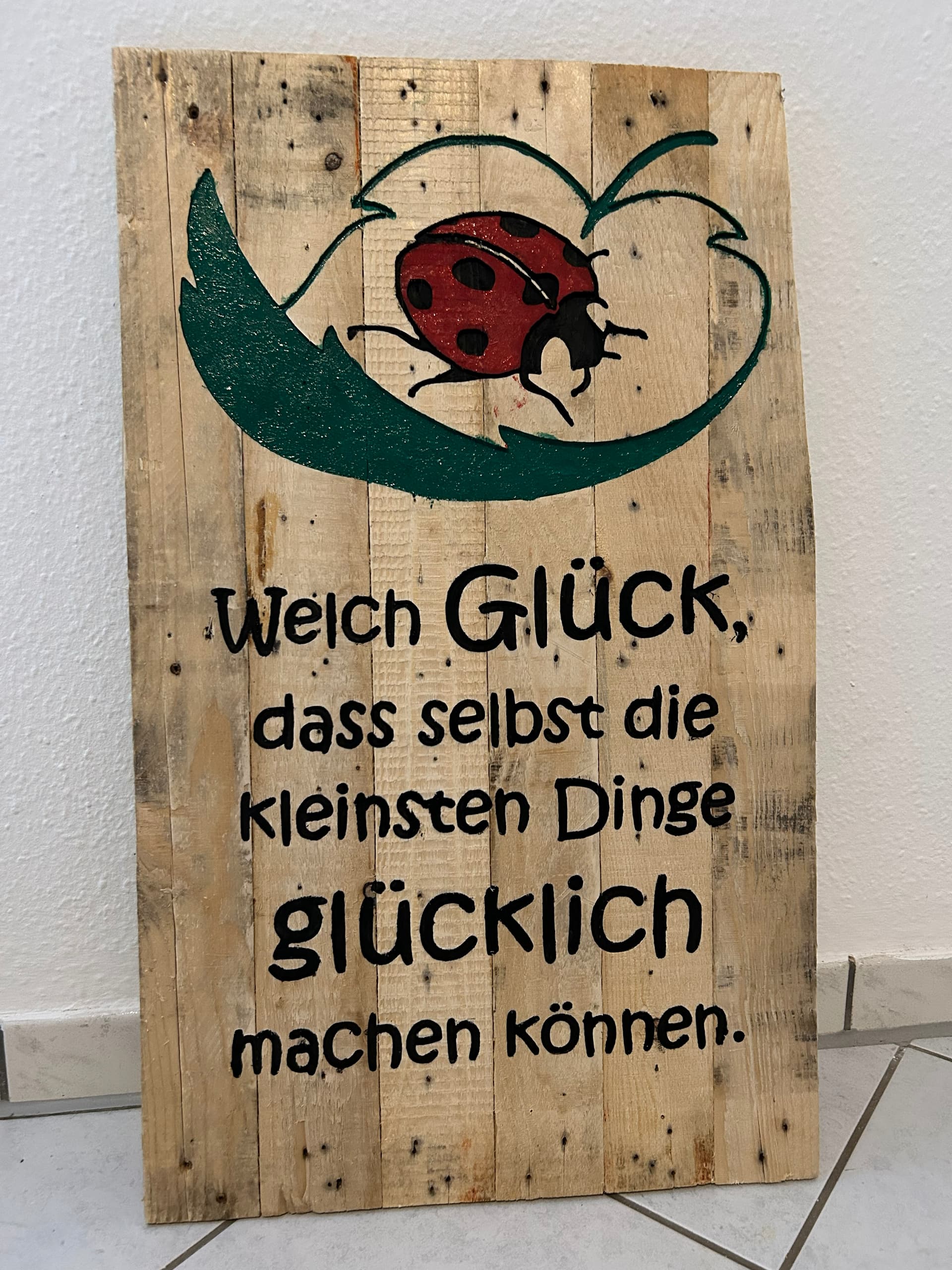

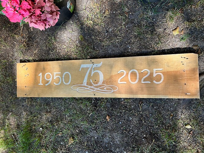

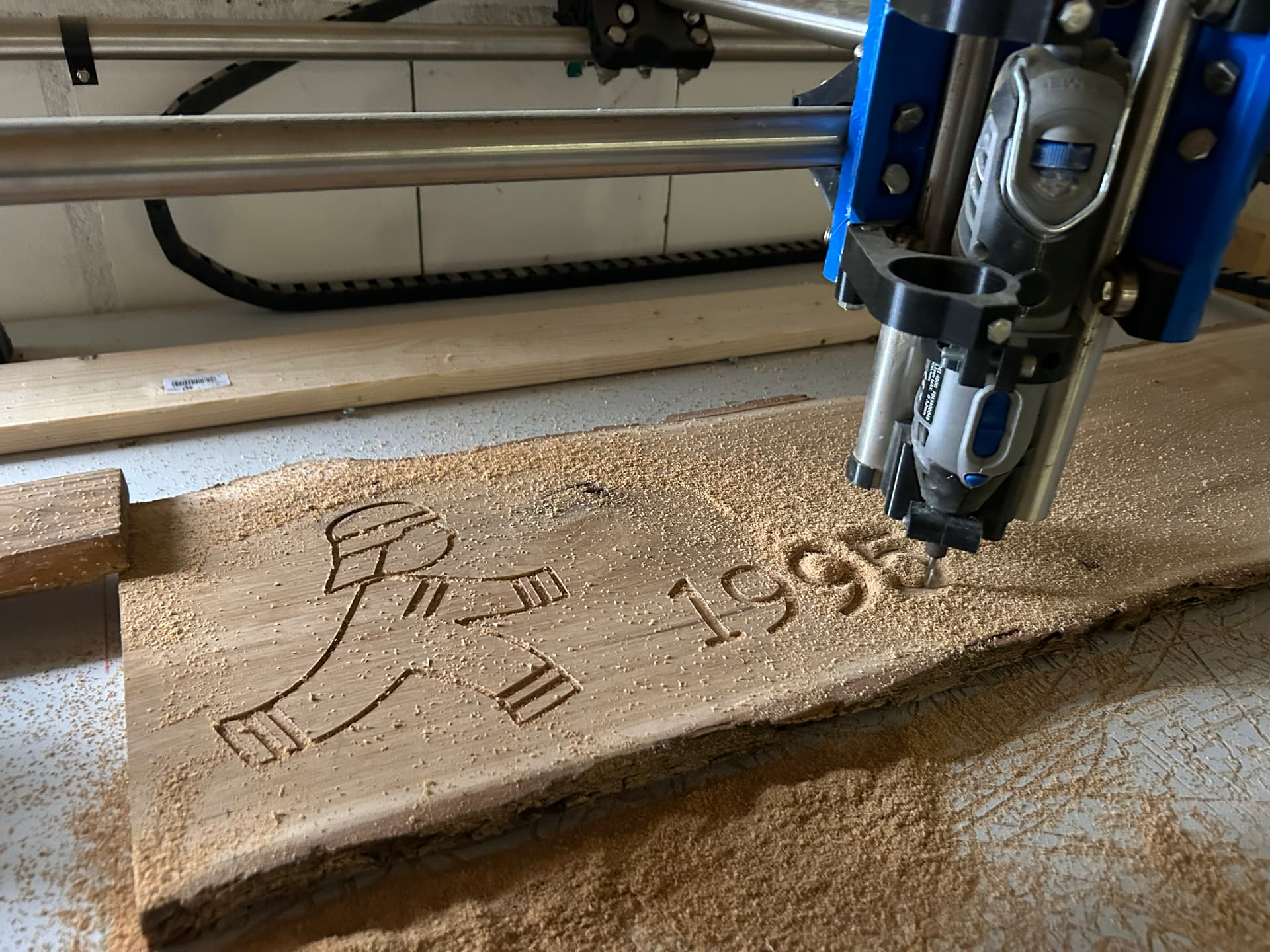

I mostly used my MPCNC for gifts for birthdays or other occasions.
Super cool what you can do with a Dremel even. :tada:
Very nice! how did you do the clean and neat painting?
Thank you!
With patience, a steady hand and a thin brush. It’s simple acrylic paint.
Then the surface was sanded to remove any excess paint.

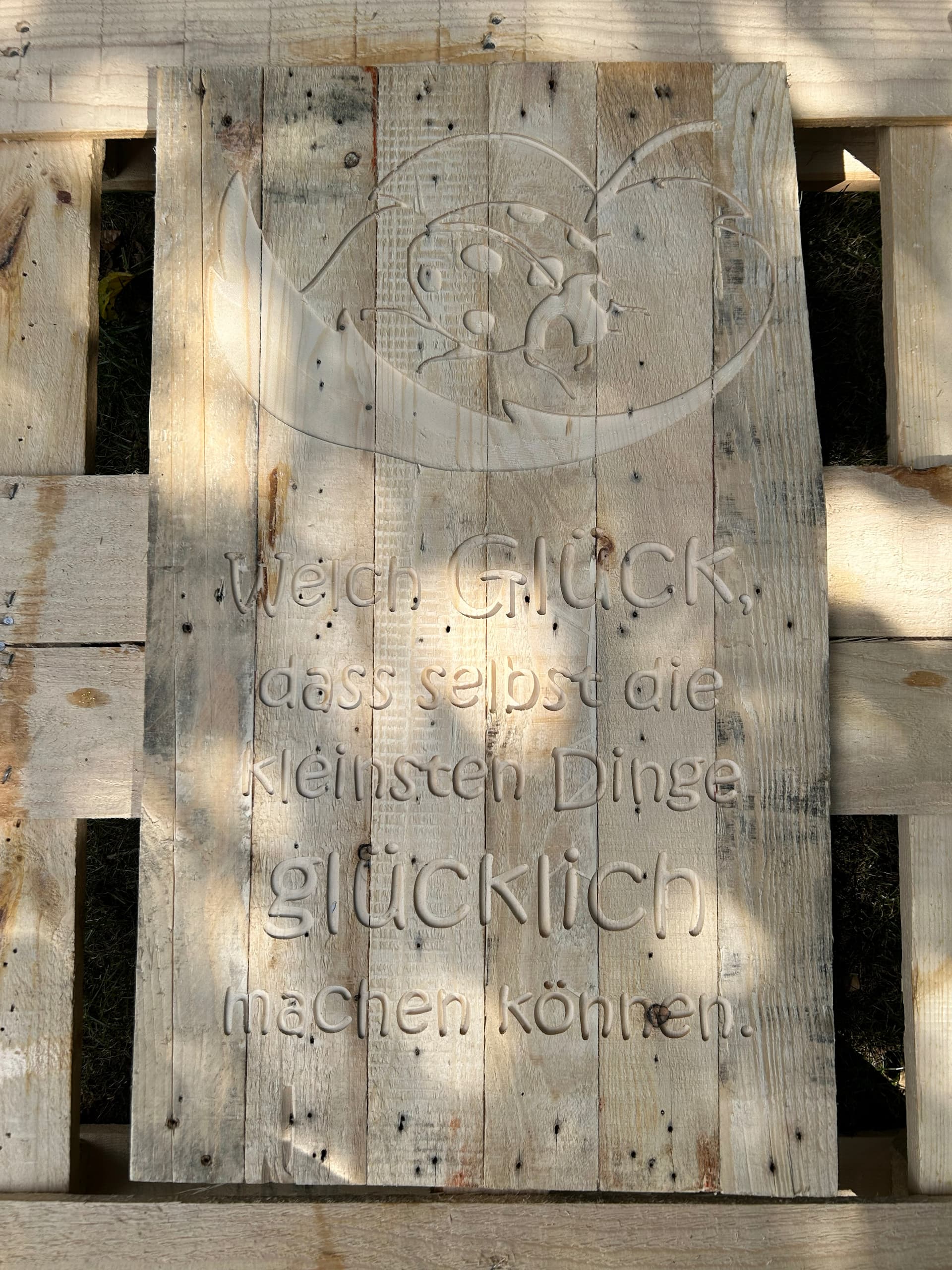

Thanks I mentioned I used Frisket a very thin sticky film but I was mistaken. I realized it only for airbrushing after tracing the desired art. Tried on my CNC and it just tore up. I think the secret is a sanding sealer on the top to stop the bleeding and then as you said careful hand.
I have used contact paper before on items where we wanted both the outside and the carve/cut painted but in 2 different colors. It works well just make sure to use a tack rag or something on the wood before you put the contact paper on.
