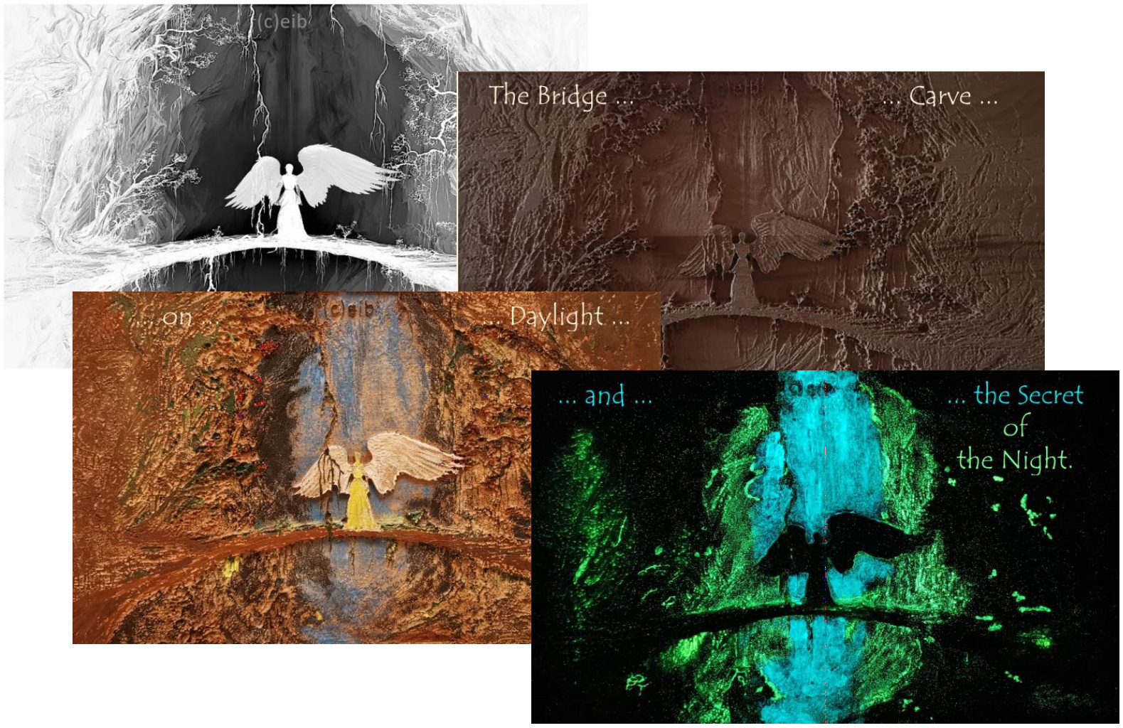

Hello. I’ve done some similar carve.
here some diffrent finish
Color- DayNightPic - NightKing Game of Thrones
Color - DayNightPic - Angel on Bridge
Finish with Oil: Present for Marriage and new House
Gold leaf and Color: Phönix VS Dragon
Have fun with your carves.
