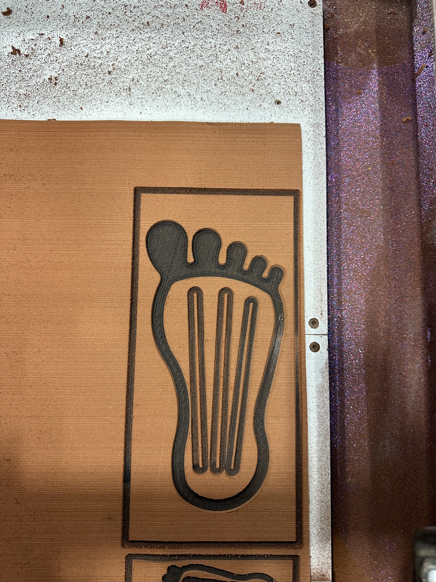

Well after some help from the ppl in here I have successfully made a foot kind of lol
This was a ball 1/4” router bit cheapo.

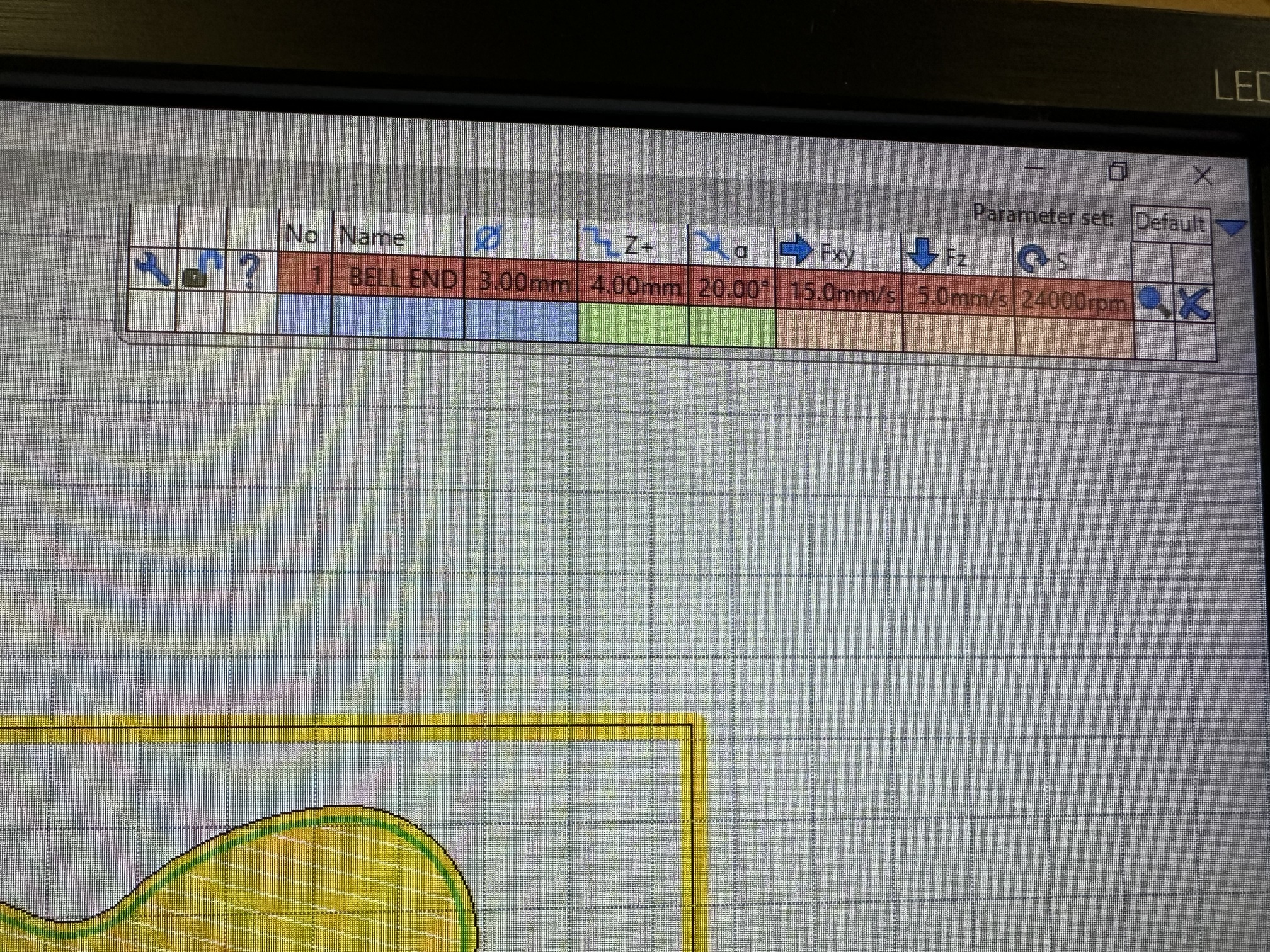

Was full depth cut of 4mm and full speed on the router.

Haha nope too squishy. After doing my boat floor some of the guys at work want some of theirs done as well.
One guy is restoring a 1970’s hondo drag boat. It’s got a really low draft and it’s all epoxy floor so he wants to put in some grip pads for ppl to get in. And to show where is safe to step. I will see if I can get a pic of it.
I did originally make the stl file I made the dxf from, for my arcade gas pedals. For 4x4 off road
