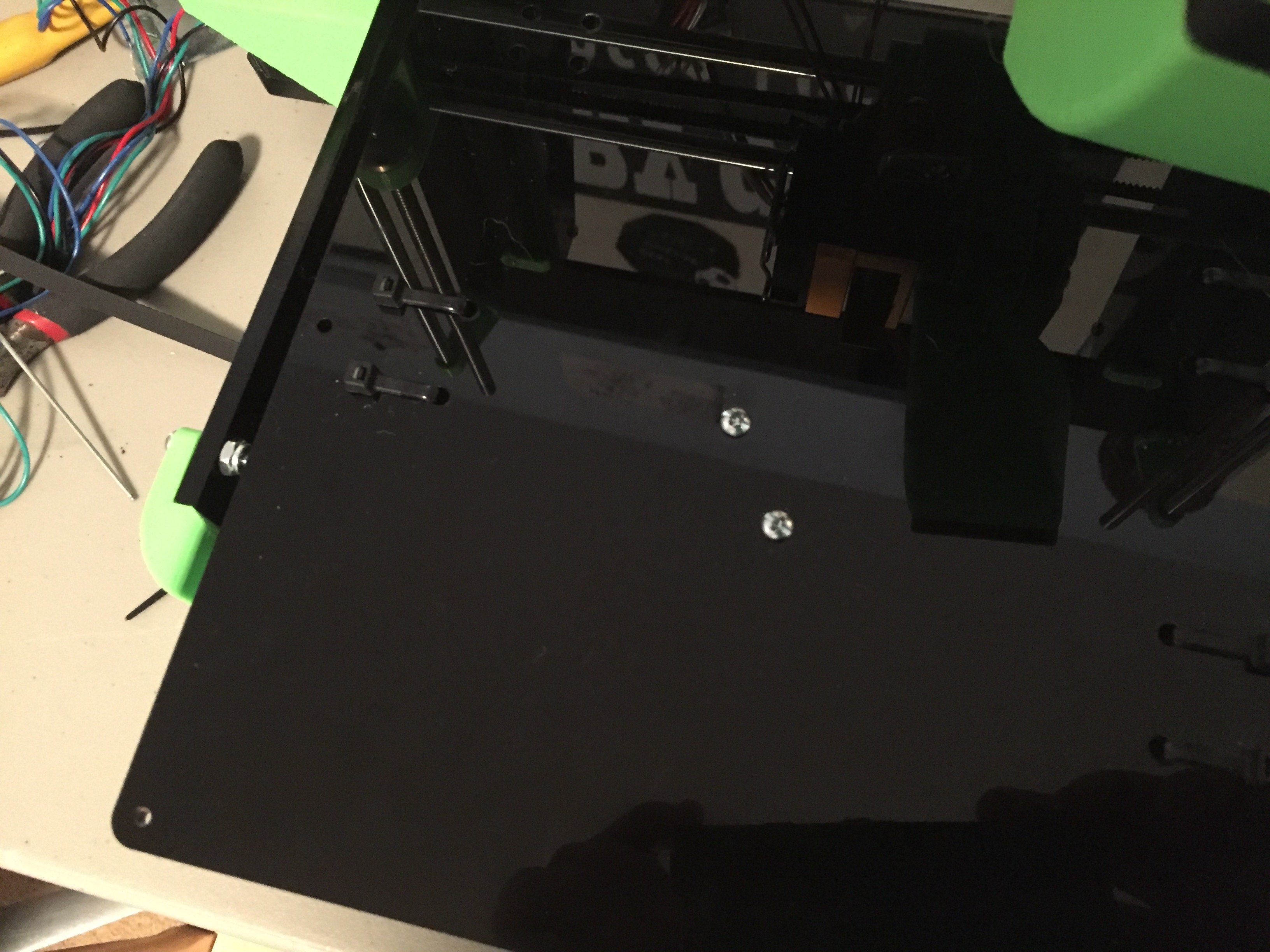

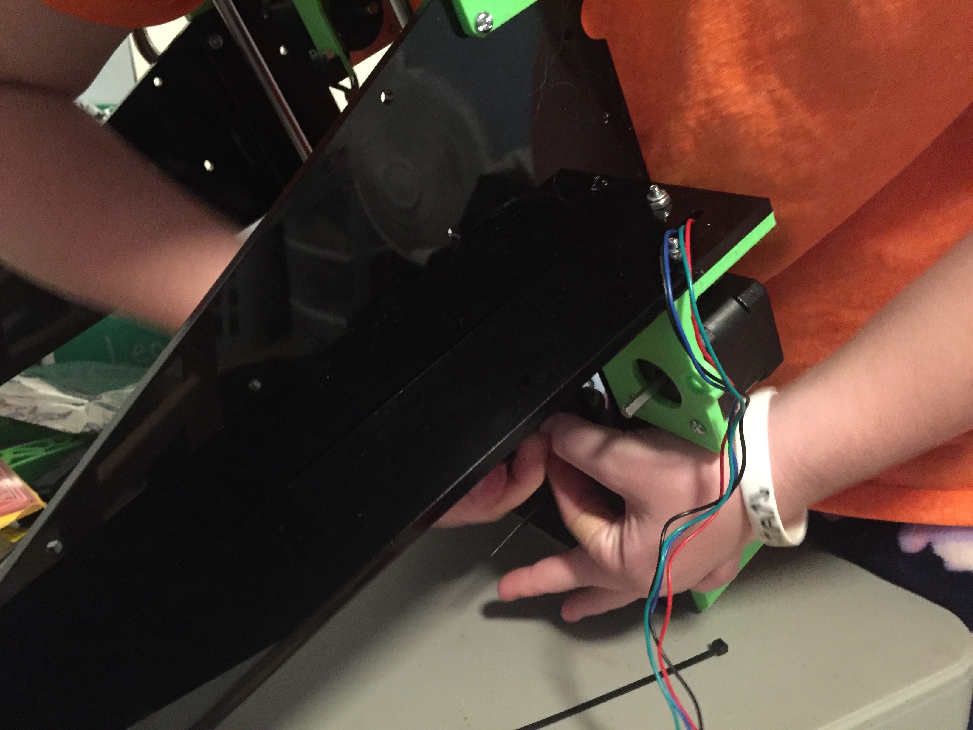

Ran into a a couple of problems last night that really slowed down our progress. First we felt that the RIGHT Z axis lead screw was binding up. While we could still rotate it, it was not as free as the LEFT side. After loosing all nuts and bolts, it was still binding. I replaced the lead screw NUT with a spare (I ordered two sets) and the issue went away. Weird! I think it was just something with the way the nut was seated. As there does not appear to be any issues with the original nut and turned freely in a different lead screw. Once we tightened everything back up, it turned as freely as we expected and equal to the LEFT side. The other issue we have we have not found a solution. We ordered out acrylic kit from TWELVEPRO. The build PLATE appears to be slightly different than the build plate that Ryan originally posted. WE will we have an issue with Y range. Check out the pictures and give us your opinion please… Jon
Looking at the above pics, we feel we have enough -Y range, but as you can see from the pic, we don’t have enough +Y to get to the edge of the build plate.
Is the zip tie hitting the bearing?
No, it is the front bearing (on the double side) that is hitting the front panel that is restricting the build plate from moving far enough. We did a mock up tonight with the heat bed in place. I think we are going to be Ok, but it is really close. Looks like we might be looking a couple of mm of build area. Not gonna worry too much about it for this first printer.
