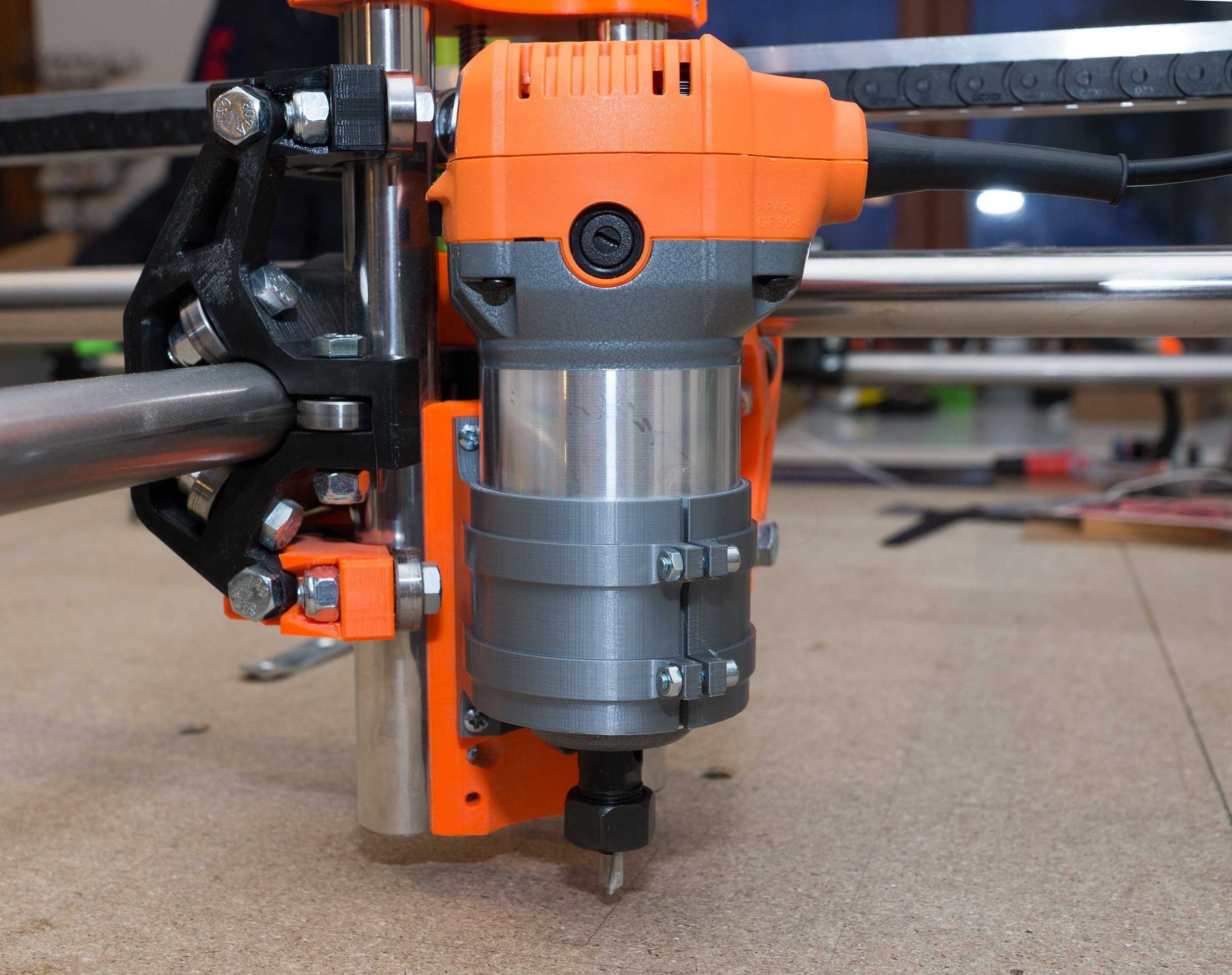

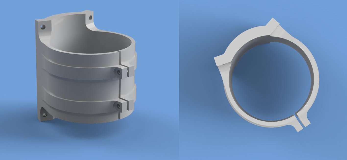

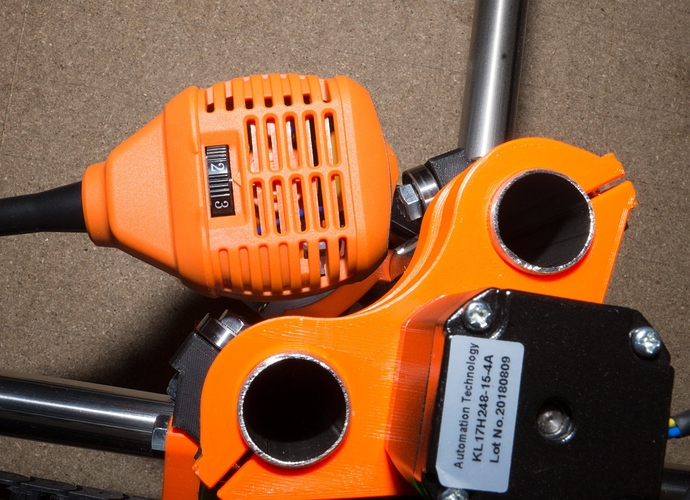

As I can not order the dewalt dw660 in France I use for the moment a cheap model (55$) of standard diameter 65mm while waiting to buy a Kress much more expensive.
It weighs the same weight as the dw660 but it is a bit more bulky that’s why I drew a tool holder where the spindle is the closest to the MPCNC tool mount part.
[attachment file=88139]
[attachment file=88140]
[attachment file=88141]
As you can see, it’s very close to bolts.
and I see that this is also the case for the one Barry told you
If you need I can do something similar for 80mm tool
