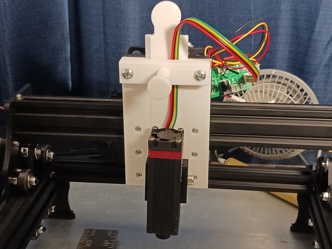

As many/most of you know I bought two of these machines… and I’m now setting up the second one. All is going well… flashing and configuring GRBL, wiring mods for different laser, etc. One thing I’m doing different, however, is adding a newer, thinner, Z-lift to minimize futher reduction of an already small workarea.
This machine really presents a nice big, flat, metal, carriage plate to work with and enough convenient pre-drilled/threaded holes to make it a “snap” to bolt stuff on…
Removing the included laser and red cross-LED module, I used Onshape to create and set up a relatively thin three-piece dovetail slide using the 3-hole “stack” down each side…
The central slide provides ample room for different laser module hole patterns. But I’ve got several Neje laser modules that came with a high quality metal clamping mechanism so I just added holes to mount one…
Setting the laser on it’s feet a simple clamp holds things quite securely for testing…
Noting the two large holes at top, I envisioned a bar with threaded bolt through it to clamp the slide in place. I found a printed C-clamp and a knurled thumbscrew out on Printables… and then used TinkerCad to cut, stretch, combine, and add the bits I needed to make a suitable clamp mechanism…
I’ll probably need to lengthen the central slide to insure I have enough “reach” to get down to the work surface but otherwise all this seems very workable. I usually set all my lasers to focus at 50mm below the bottom edge of the laser housing, so using a 50mm gauge block I can easily set the focus for varying material thickness…

Not being able to leave well enough alone, I decided to redraw @dkj4linux design in fusion 360 so I can adjust it some. It is supposed to be here tomorrow, so will wait until then to adjust the design any. I will print a couple of test prints first to see if tolerances work for me. Here is what I have so far. I used the coil in fusion 360 to make the leadscrew. Think I have the assembly correctly.

I put “Another Z-lift mechanism for $79 Cenoz JL1 laser engraver from Amazon” on Printables for those interested. – David
I think I’ll be keeping the screw lift for now. Losing 20mm in the Y axis isn’t that big of deal for me.
