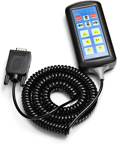

Going to be buying one of the Sainsmart MX3 Boards. It uses Mach3 CNC software and has a rs232 Controller which makes it a more versitile machine just due to the software… I get by with Estlcam and repetier host, but truely the MPCNC lacks the Beefy software and tweaks like Mach 3 uses, Customization and Settings. Think Ill quick change mount it to fit dual Laser/ Spindle on the Burgly so i can use either.
