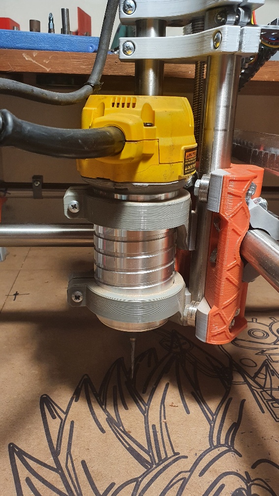

Hey Lara, thank you for the mount. I was initually worried it may need some tweaking since you stated in thingiverse that you had not tested it. Well I am happy to report that it works like a charm. The only thing I did was that I used only the lower part of the mount for both top and bottom. I printed both rings and tried them out, felt that by using the lower mount also on top, the router was more stable.
As shown in the picture, the top mount would fit lower on the router so I assumed that by spreading them apart I would have a better grip.
