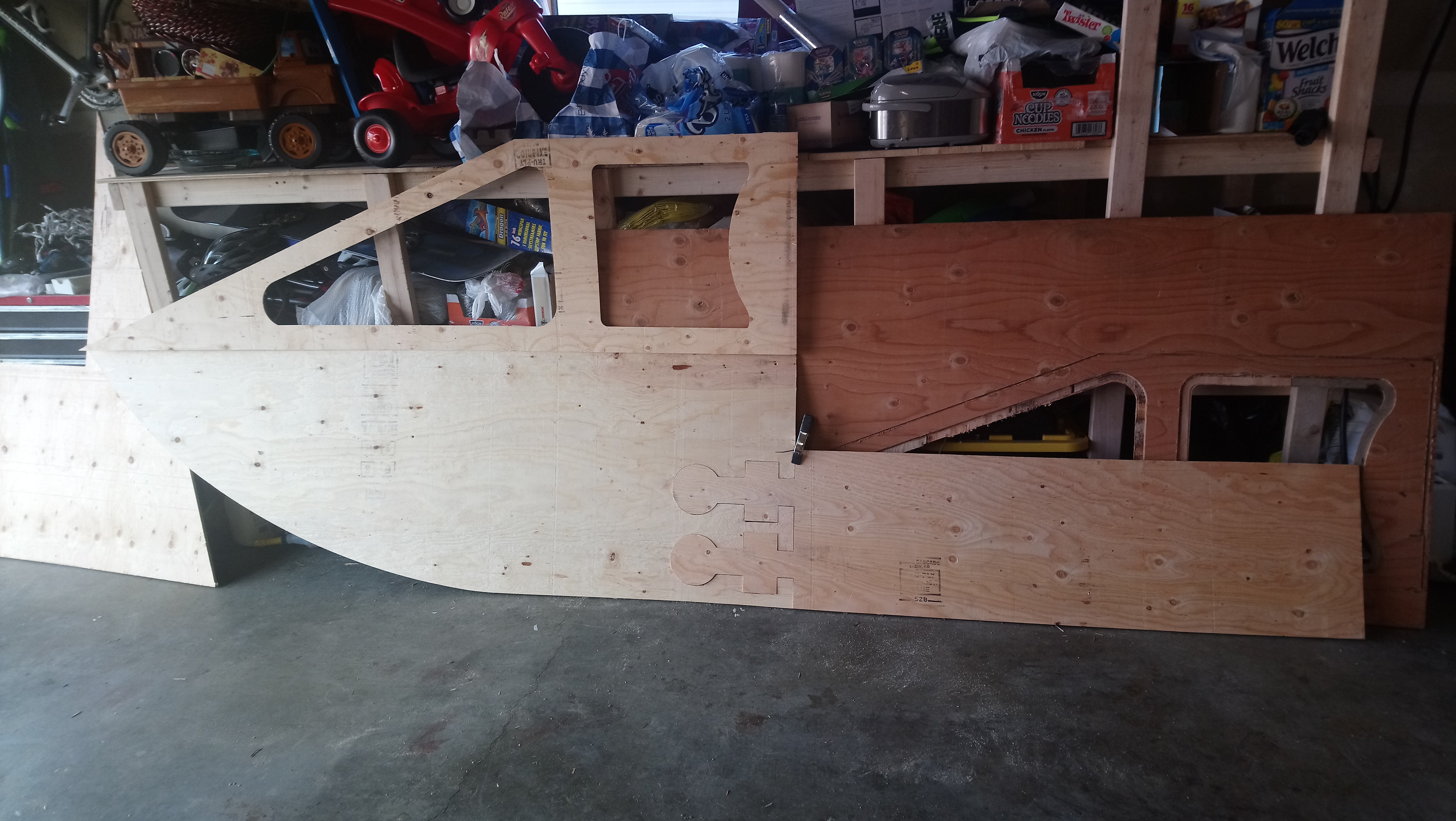

I built the LR2 to cut out my boat parts. I am using 1/2" plywood and its have not problem cutting the first .25" layer at 1mm per minute, but it starts to have issues when going deeper into the contour cuts. Its struggle to cut the rest of the parts out without going haywire or misaligned each time. Any sight stress on the cutting path makes it off target…its get really frustrating trying to figure out what wrong.

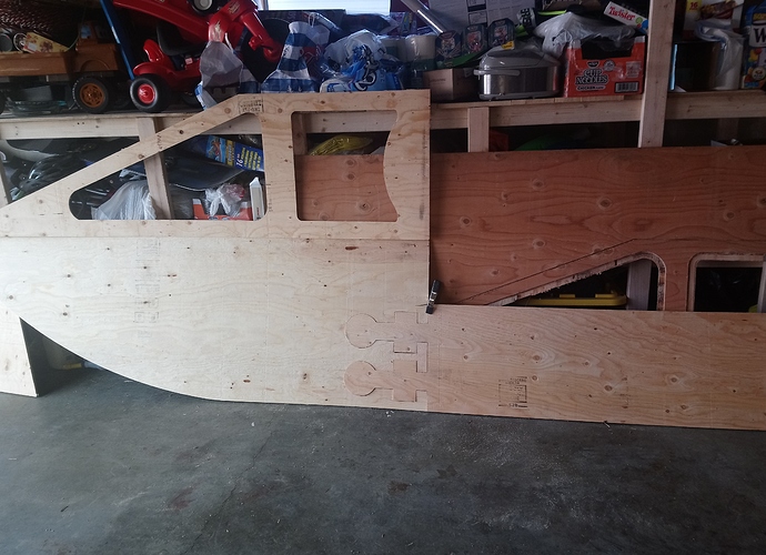

Here are my parts, I have to cut each parts out with my router after it goes .25" deep!!!
I designed and building this PowerKat.
Peter
Where is your thread? Plywood should be no big deal and I suspect something pretty major to be wrong, I cut MDF deeper and 8x faster than you are cutting. We need to get you sorted out.

More important are some pictures of the build, your endmill, and your gcode.
Interesting PowerKat design. I’m looking forward to hopefully seeing a rendering of what it will look like finished. I hope you get your LR2 dialed in, but cutting out the parts is like 10% of the total build. Where will you be splashing her when she’s done?
