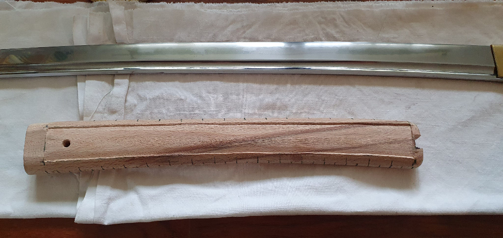

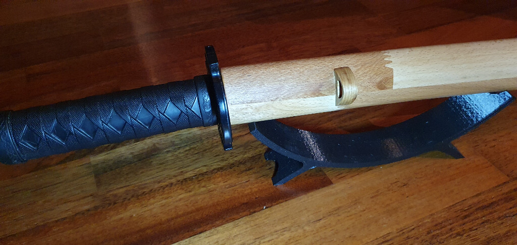

I am trying to realize some parts for my training sword ( so called Bokken). Therefore I started to create some 3D-parts.
Here my first results.

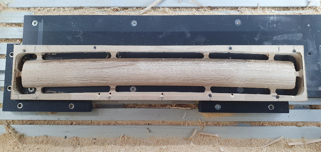

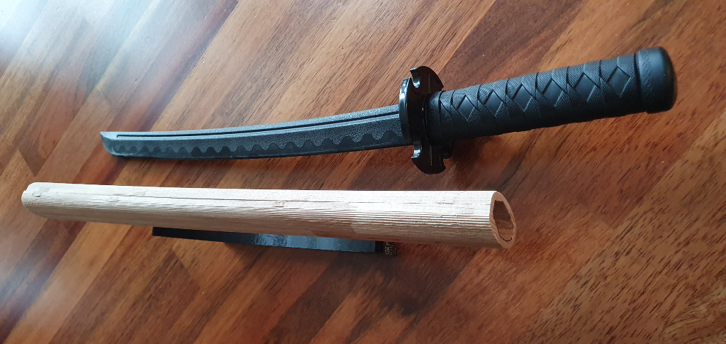

Target is to create a scabbard (saya) for a wakizashi bokken (small japanese sword). For these initial tests I used European beech.

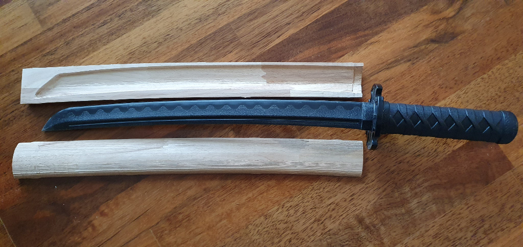

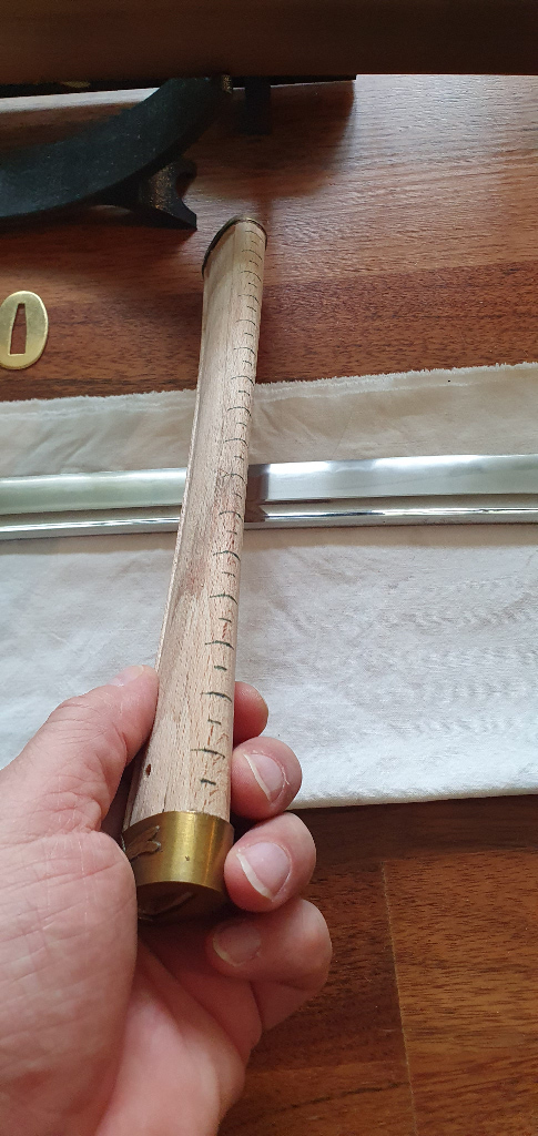

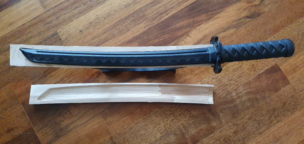

1st side, which will be the inner side of the scabbard.
2nd side, which will be the outer side.
I have to say, that for this test I used a normal 8mm miller so the structure is not very fine but the result is really cool. Of course there is the need to do some manual finish.
The opening of the scabbard (Saya) is called Koiguchi (mouth of the koi carp) :wink:
Bevore glueing it together there need to be done some works.
Also the outside part needs to be revised and at the end to be coloured.
For the Katana specialists: I know, currently the kurigata is still missing, but it is planned to create one :wink:
As mentioned before, this was only the first test. For the next 3D-parts it is planned to use some exotic woods.

  • Normally I can mill (with my MPCNC) only parts up to 50cm (ca. 20 inches)
  • I would like to create some 3D parts up to 100 cm (40 inches). Therfore I need to mill every side in multiple steps because I have to move the wood after each step over the board.
  • Has anyone experiences with 3D-milling, 2 sides in multiple steps?
  • Problem e.g. in EstlCAM is, that you have to turn the parts in x-direction. Much easier would be to turn in y-direction (in my opinion)

Yeah, very nice. I really love those! :slightly_smiling_face::heart:
We do not see all that much two-sided milling here. That is such a great example, Great job. Please keep posting updates as you go.
Unfortunately, I am not sure about estlcam for that. I have three suggestions though, you can make you MPCNC into a longer rectangle (couple new tubes and belts) and skip the multiple flips, swap out to a LR4, or fusion CAM might make all those flips easier.

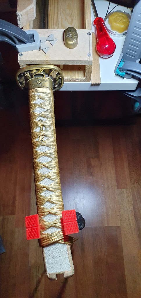

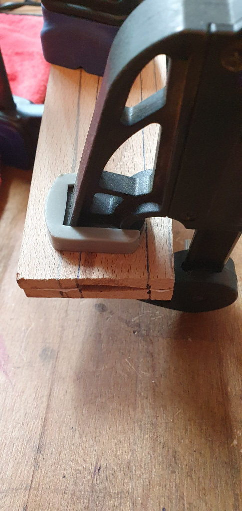

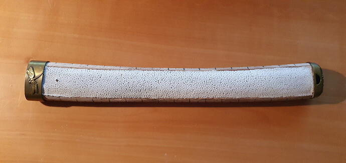

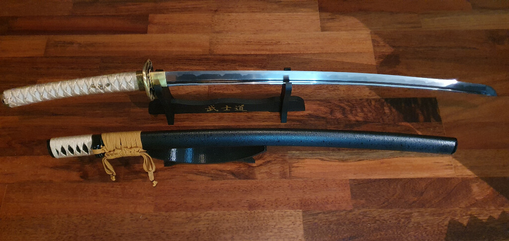

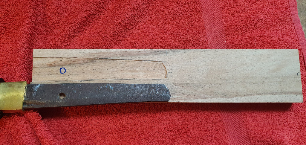

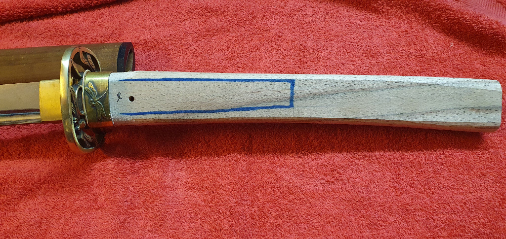

These are some examples of the manual works :wink:
I use this (sharp) Katana below also for (single, standalone) training. The blade is from Edo period (so round about 350-400 years old). Only the Koshirae is new.
The old Tsuka and the new parts

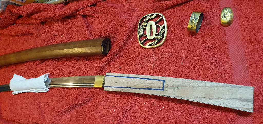

First step for adaption
Glueing but also with modern glue
Getting the form of the Tsuka based on the form of the sword
Details of the Tsuka form
Ready for the ray skin, Fuchi, Kashira and the Tsuka Ito
The form is very important to have a good feeling for the sword
Tsuka with ray skin
Last step the Tsuka Ito with Hishigami, Menuki etc.
And so it looks after putting a new Saya, Habaki, Tsuba, Tsuka etc. to a beautiful blade :heart_eyes:

That scabbard’s slick. Flip y-axis—x-axis is asking for trouble.

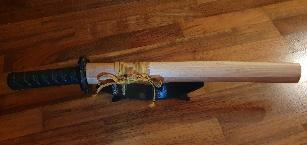

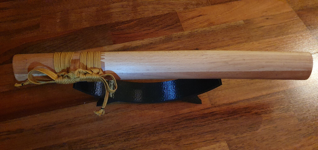

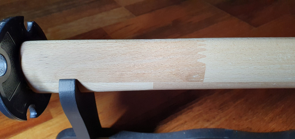

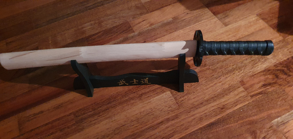

OK, next working step.
Starting with:

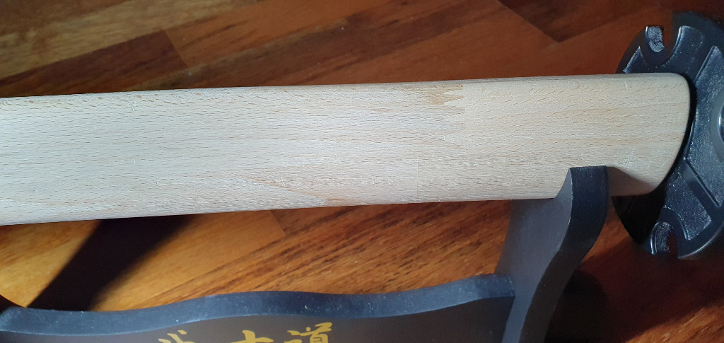

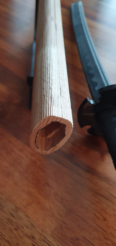

First I have burnished the outside with a planner and I have adapted the opening so that the thicker part of the sword (Habaki) fits into the scabbard. This part is locking the sword in the scabbard
2nd step: sandpaper (80), 3rd step: sandpaper (180), 4th step: sandpaper (800)
Currently missing:
  • Kurigata, the “knob” at the scabbard where the Sageo (cord) will be attached at the scabbard
  • the scabbard needs to be oiled
Last steps

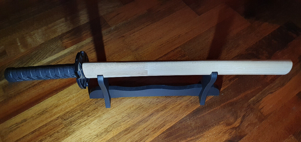

Built a Kurigata (knob at the outer part of the scabbard) and oiled the wood.
The Kurigata has different functions at the scabbard but I will not explain for not getting boring :wink:
OK, ready for using the Wakizashi Bokken with Saya for training :heart_eyes: :heart_eyes: :heart_eyes:
