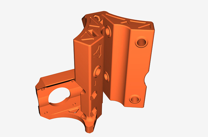

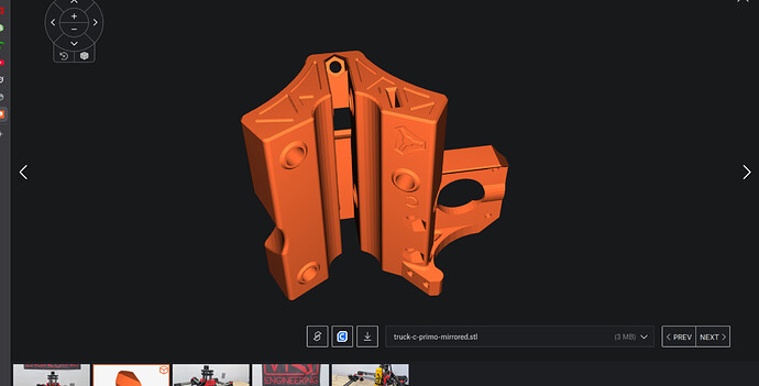

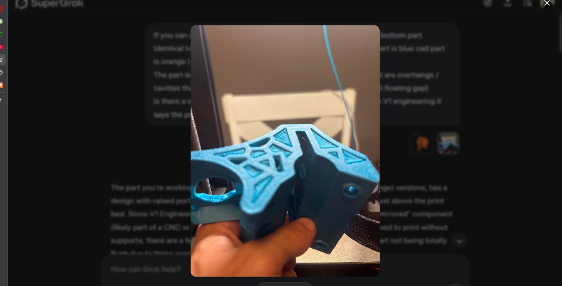

Printing my parts for the MPCNC- working on print quality, having the following issues:
the docs say no support but I’m afraid I’ve never encountered this issue before.

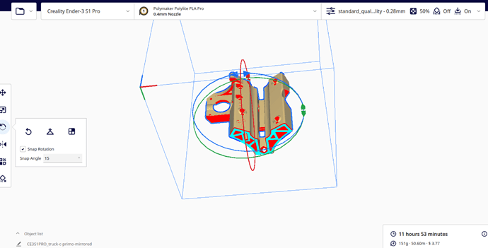

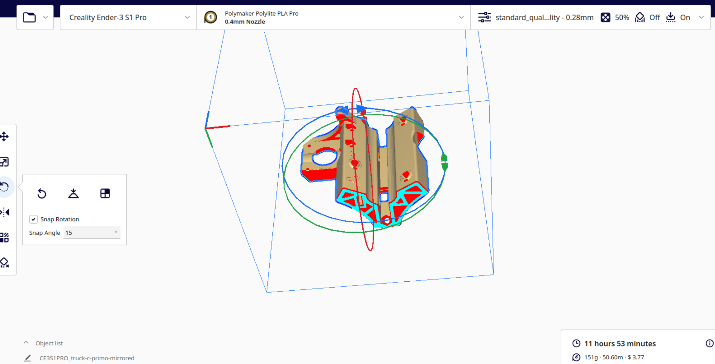

In the slicer it shows the negative recessions or cavities that from a gap between the part and the print bed.
Is this a bridging issue or do i have the wrong orientation on the print bed ?
When i printed the first one, that lower bridging ended up sagging on the bottom of my part. I am fixing to print the 2nd one and want to solve it if I can. What is the solution to this ?
Part is 23.5 mm model MPCNC, Truck_MIrrored-C-Primo.stl .
i can list out my print settings and profile configurations if necessary.
Printint on an Ender 3 S1 Pro. Filament is Polymaker PLA PRO.
Thanks. Humbly looking to learn here. enjoying the process.
Tim
What are you print settings for temp and layer height? Do you have cooling turned all the way up for bridging?
You might also give Orca Slicer a try and see if you get the same results. Switching from Cura to Orca helped me out a ton.
nozzle diameter: .4 mm
print settings:
bed temp: 60 C
nozzle temp: 215 C
print speed: 50 mm/s
layer height .28
line width .44
discovery: i dont even have any bridge settings enabled…
Might try bringing that .28 layer height down a touch. Assuming you are printing with a .4mm nozzle. Might try a .2-.24 and see if the little thinner layer helps your bridging at all. Also make sure your fan is hitting 100% on bridging.
ok ill try that thank you. i like to operate on the upper ends of my nozzles limits, to shorten print times if i can . was thinking about going to a .6mm . I havent tried any other nozzle sizes.
.6mm is what I print with for V1 parts. It works well if you have a decent hot end that can move the plastic. I run a .3mm layer height with that and it does real well.
Just remember if you try and make the prints faster and end up with parts that aren’t right or don’t have good layer adhesion, you’ll waste a LOT more time reprinting the parts than having the first print take a little longer.

Just checking - your second image looks like the part is printing with the widest part at the top. You are printing it this way up aren’t you?
Core One. Don’t waste it on an MK4.
sorry just now seeing this, so i printed it in the orientation of rail hole closest to the build plate. the 3rd image i posted is the bottom of the print. it printed in an identical orientation to the image you posted.
