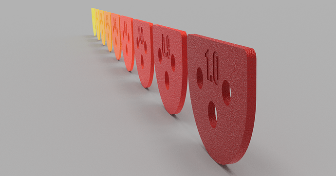

My bed was tilted very slightly (~1mm front to back, not terrible over 300mm) but the mesh leveling dealt with that with no issue. I decided I wanted to try improve it slightly so there’s a Creality standard bed leveling process I followed. It’s basically loosening the Z drive belt, screwing the bed down with the shipping screws, re-tensioning the belt and re-doing the bed mesh leveling. Mine didn’t really change much after doing that so I printed some shims that go between the Z ‘trucks’ and the bed frame attachments. I think I used a 0.6mm in one corner and a 0.2mm under the back and that brought the whole thing to within 0.5mm at all points on the bed, which I’m plenty happy with.

Bed shims:
