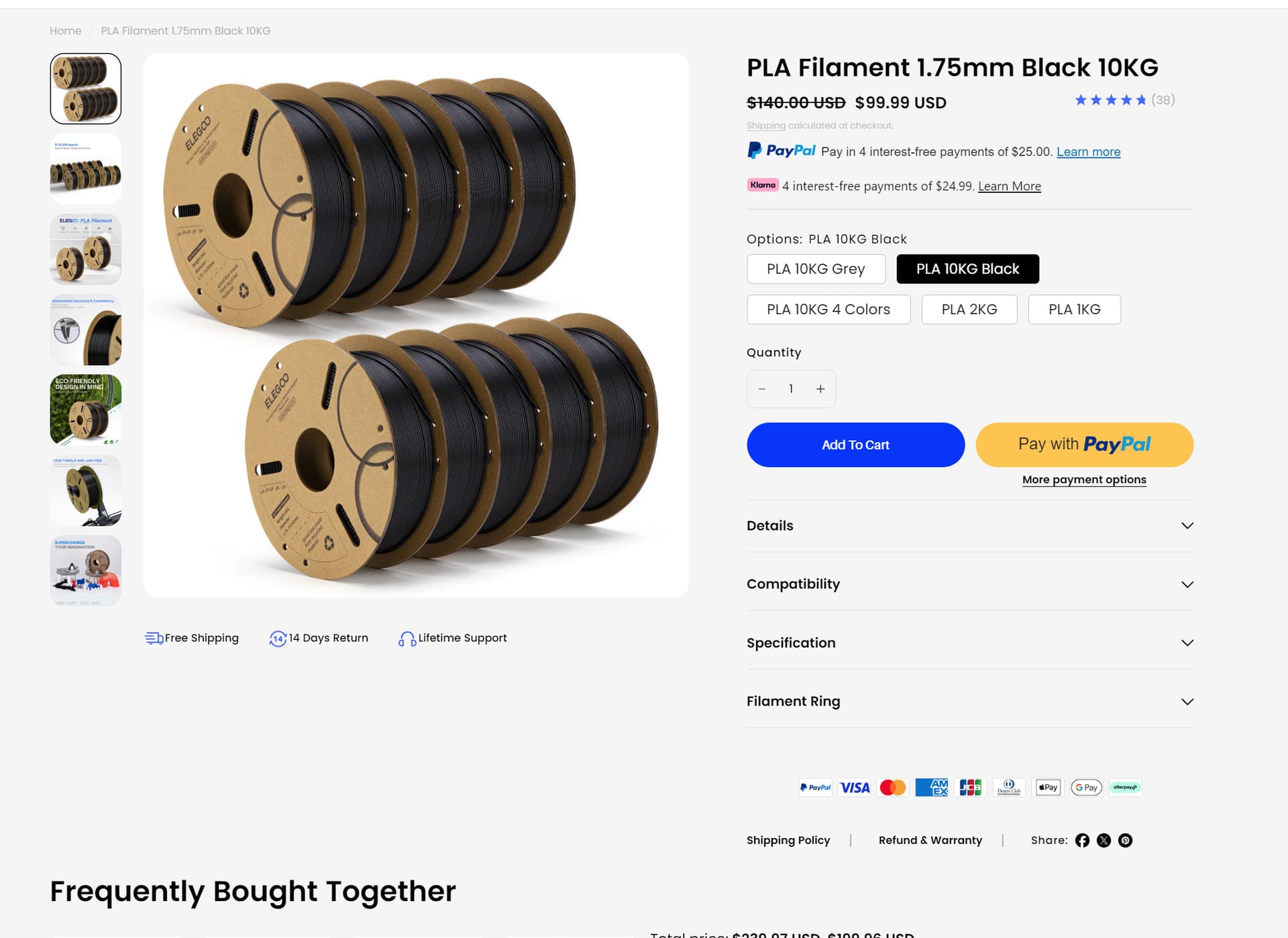

No clue if this is what Doug is using. But I have used this a BUNCH and it works great!
I second this stuff. I buy a lot of it as well and it prints quite well. Certainly for the cost!
you can get it on amazon right now 4 spools for $40
