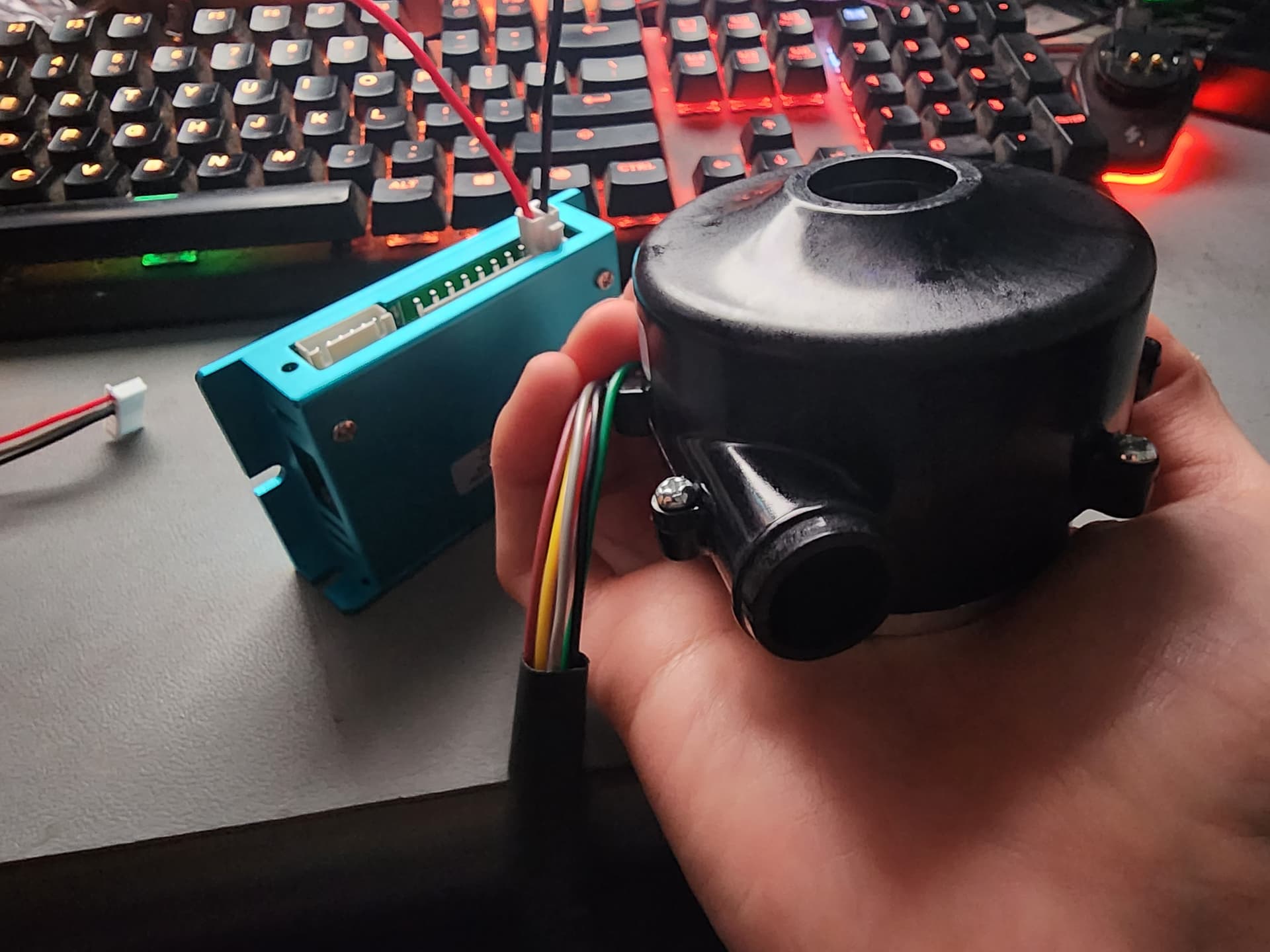

One of the guys that has my printer is using one of these.
What is it?
cpap blower

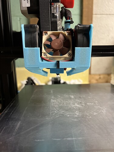

I tried the fan ducts last night, it was very wobbly. I found the satsana for my microswiss that someone modified to have a 5015 fan. I am trying it right now.
