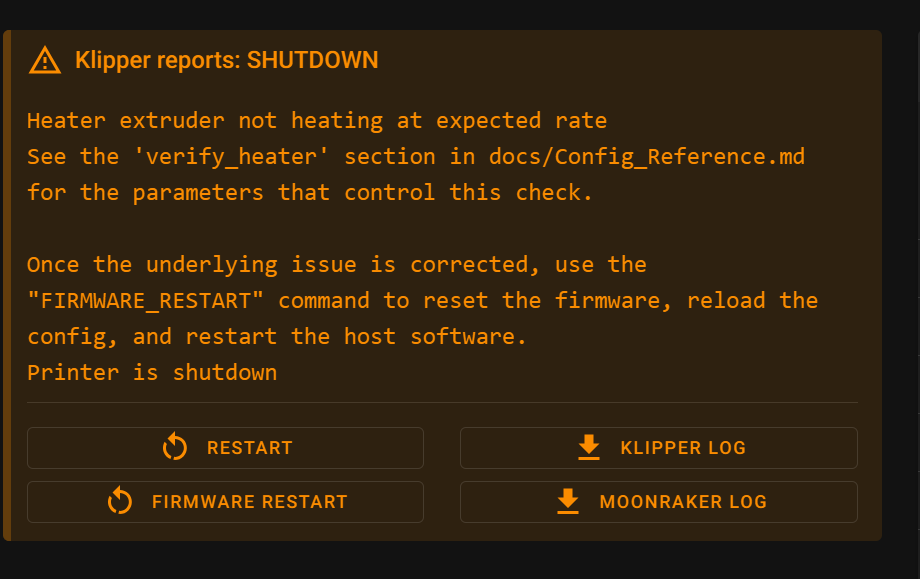

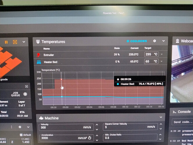

In fact it works and can create good quality prints but from time to time I get the “Extruder not heating at expected rate” error/shutdown and this costs me time and wasted filament. You can see in the attached photo that the heated bed sensor shows up in Mainsail as solid blue line and reports a current reading of 75.4/75.0oC [49%] but the extruder sensor does not show up in the same way. It functions and shows a red zone but not a solid line or current reading. I don’t believe this is a wiring or electrical connection issue as the sensor does function as it should. Has anyone else seen this problem or something similar. I can’t find a solution within the Klipper Documentation.
Have you run a new PID tune since the modifications? Might help. Also it can help to simulate the printing environment like having the build plate close and running part cooling fan at a baseline level.
Is it s mechanical issue with the wire pulling the sensor away at certain locations on the bed? Could be the heater or the sensor shifting in the hot end. Everything is still electrically connected. But thermal contact changes… Something to check.
I have done a new PID tune and the temperatures at the extruder look to be consistent.

Just tried another small print that failed with this error.

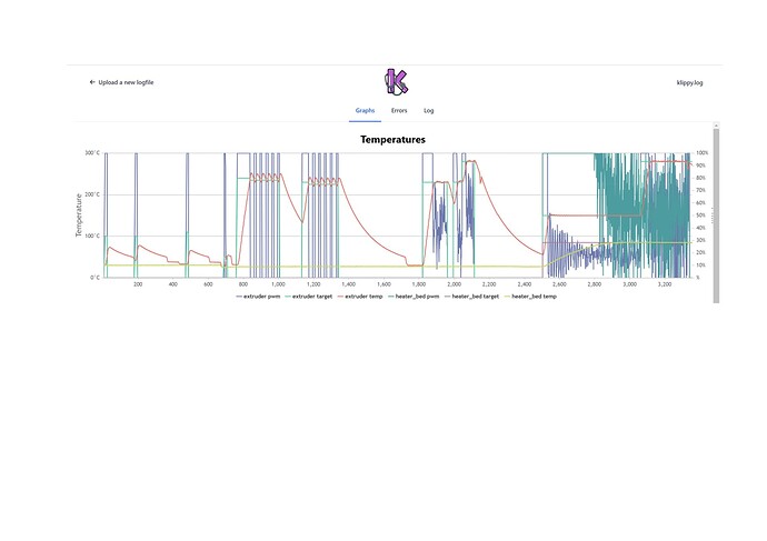

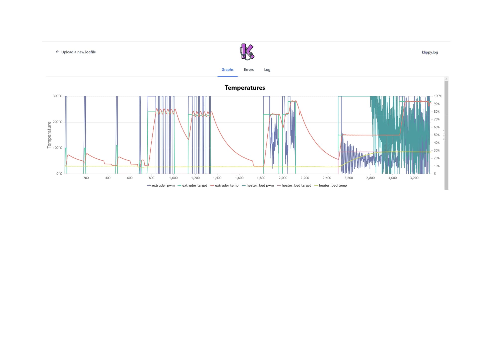

Used the online Doctor-Klipper to read my Klippy.log file and can see there is an extruder temperature fluctuation before the shutdown. Drops to 262C with a set temperature = 280C.
Still lost as what to do next?

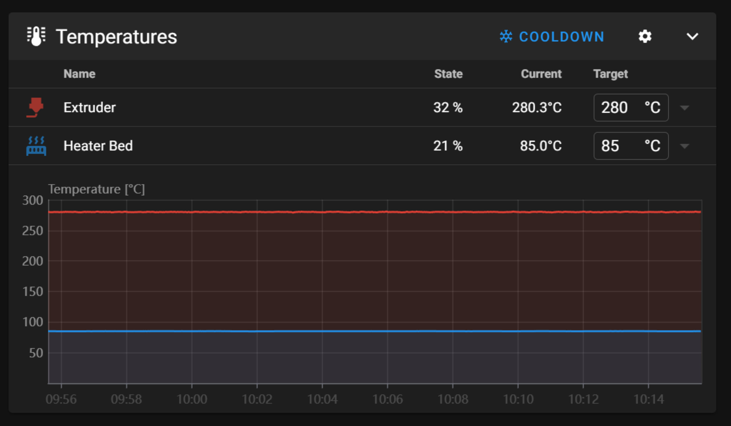

I have got my printer working reliably by doing a “soft recovery” of the various programs. i.e. Klipper, Mainsail, Moonraker, etc. As you can see in this image the extruder temperature line is showing as it should and I have managed to print all my X-beam braces from PET-CF.
