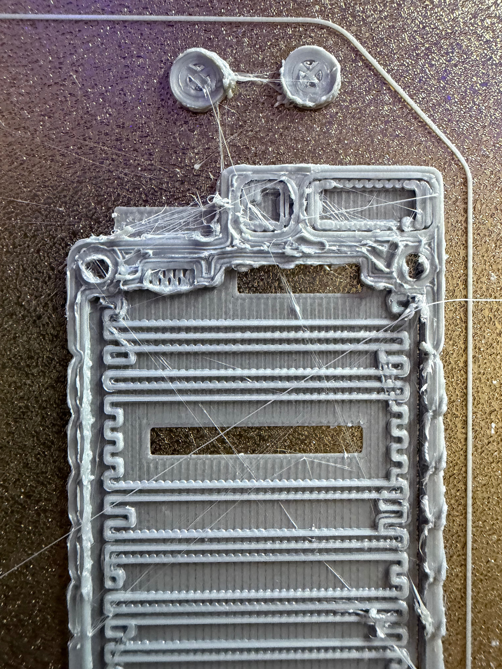

Folks, any ideas why my printers are so bad? I cannot get anything to print well. I have tried everything!
I just cannot get good prints anymore!!! I set my e steps, oh btw
Klipper, microswiss dd, I have ran and reran z calibration.
I have checked everything, I just cannot get this thing stable. You can see it prints great, but then at the top it went haywire again.
has a new nozzle, I went back to .4. I have tried Orcaslicer, prusaslicer both. Prusa gives me better prints right now.
i have tried 3 different filaments. This last one is my Esun pla+ that has always printed awesome!
I really am at my wits end. I hope this is something simple. I also checked for ohhh, bummer, my memory. over extrusion, cannot think of it. I am running at .95 right now.
If anyone can help me it would be greatly appreciated, oh and this is happening on 2 printers. This is the better of the 2. I have done something, When I went to Prusa I even had to create a default profile.
I appreciate any help.

It looks like over extrusion but with the stringing and blobbing also could be wet filament, nozzle temp too high, too low retraction length and/or speed, and maybe part cooling fan settings. It sounds like it was working fine before? Did you lose your printer profile in your slicer?

This is happening on two printers?
That’s got to be significant. Has it come on for both of them together, or did one go and then the other? If it’s common to two printers and has started on both at approximately the same time, it’s quite unlikely to be a mechanical issue. It should be either software or environment.
If you were to re-run this print (or print it on the other printer), would it fail in the same place or randomly?
It looks as though the first layer goes down fine, but the second layer is bad everywhere that there’s more than one line extruded adjacent to the next. The more lines you’ve got adjacent, the more the nozzle is ploughing through filament instead of passing over it. That does sound like overextrusion.
  • Is the Z axis moving correctly? If it’s extruding enough to build a layer of height A, but only moving up by distance B, then the nozzle will start to crash into the filament. You might be getting away with it on the first layer due to the z offset but then running out of margin as you stack up layers.
  • If you left it running for another layer after this, would the bits that are still OK in the picture above be OK, or would they collide too?

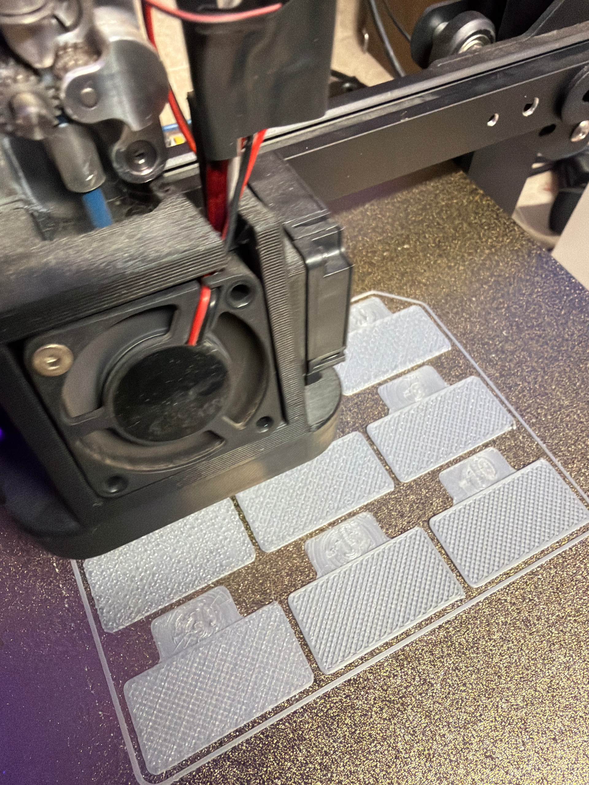

So I just took about 30 minutes in orcaslicer, and now it seems sorted! Ugh!
Intriguing. For the benefit of anyone searching later, do you know what fixed it?
I was just looking at the original picture along with this comment:
…and I started to wonder if you didn’t have the slicer set for 0.6 nozzle when you actually had 0.4 in the printer. That would explain all of it, if it was the case.
Do you have an idea of what fixed it?
So right now, no. I have a meshtastic project running right now. We will see how it comes out.
I know orca had fw retract on. I know that Prusa did not. But that would not do this. I still have to check my other printer yet as well.
I do know that everything was set to .4 as I had went to .6 a while ago, but went back. I double checked before posting. I probably should not have done a shotgun approach. I really hope it is good again. I doubt that 60 mins in the dryer could have done it, not long enough.
so after the successful cal test of the the flow rate, I put to .9. Retract at .2 and my parts came out swell. A lil stringy yet, but good.
Now I know how the people at work feel when I just show up and they say that all their computer problems go away. I just had to get frustrated enough to post here and then bang, my problems are gone. Sorry and thank you!
