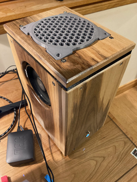

I saw an earlier thread about building computers and wanted to have these closer to finished so I had pictures to show. Two are for my sons and 1 is for me. We’ve been running them since February but just got the panels on tonight.
Specs
Operating System: Elementary OS 6.1
Motherboard: Gigabyte B550I
CPU: AMD 5600X
RAM: 32GB
1TB PCIe hard drives.
GPU: ASUS Nvidia RTX 2060
wood: Walnut and Ash
IMG_7774

Is there a fan on top, or is it just the exhaust for the air coming drom the psu and cpu fans?

There is a 120mm fan embedded under the top cover.
I altered the step files mostly to move screw positions from Free CAD Designs, Files & 3D Models | The GrabCAD Community Library
