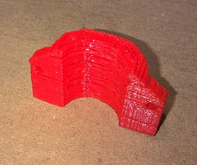

Just finished mine. having the same issues. only I’m using cura. I hate slic3r so i never even installed it. only other difference is they didn’t have anymore extruders in stock when I bought my kit so I got the same mk8 from China. maybe I’ll try bumping up the stepper voltage to see if that helps. im also seeing quite a bit of z wobble. after this print is finished I’ll take some pics.

Everything checked out from our tests… I get absolutely crap prints… nothing is right.

Same print outs… almost exact actually
It now may be the steppers and RAMPS as my culprit at this point…

Here are the prints … as you can see same issues Mark, myself have been having (as well as now Walter).
Okay a little summary.
1)Print my test file/s - if they work you have software/slicer issues.
2)If those don’t work do the 100mm extrusion test multiple times. Heat up the extruder, mark 100mm on the cold/raw side of the extruder, use the software to extrude 100mm. It should be within 1mm. If it is close this probably is not the issue.
3)If it isn’t extruding 100mm. Check for pulley tension using the little screw on the extruder to give in more grip. If it is going 200mm you are missing a jumper under the driver. if the filament is feeding weakly into the extruder, you can turn up the driver to give it more power, watch the heat.
4)Check the print size to verify x,y, and z steps are correct. These should be fine.

I’m not sure what my issue was. so I scrapped cura and did all the settings in slic3r and repetier. Slowed down my print and it got a lot better. thought about it and I figured maybe when I was fussing with things after the first duino blowout I might have swapped a driver board…well I did. got the voltages squared back up. so the next test print went really well and slow. except for some horrible z wobble on the X-axis. figured that out, I was using a piece of acrylic on top of the mdf. well it wasn’t taped down enough so that’s where that wobble came from. so I blasted out all my installs of cura and started over porting over the settings from slic3r one by one. next print was a glaring successs. Aside from all the crazy vibration of this thing eating away the zinc coating it’s printing just fine. now to dial up the speed little by little until I find a happy medium i can live with. its nice at 30mm/s but if I am actually going to be using the 440mm build platform, it’s going to have to speed up just a littles. We’re talking week long prints right now for anything substantial.
Bigger nozzle is the only way to easily decrease build time and still maintain part integrity. You can print nice things fast but they usually lose layer adhesion.
Glad you are up and running!
That texture you see on the side may or may not be the conduit surface. Mine was actually from a power hungry extruder stepper. For some reason one of my steppers runs at .9v and it is smaller than the 2 steppers that power the x and y. Crazy but once I gave it more power, smoother prints. Make sure you cool the driver with a fan at that high of voltage and feel the stepper to make sure it isn’t too hot.
