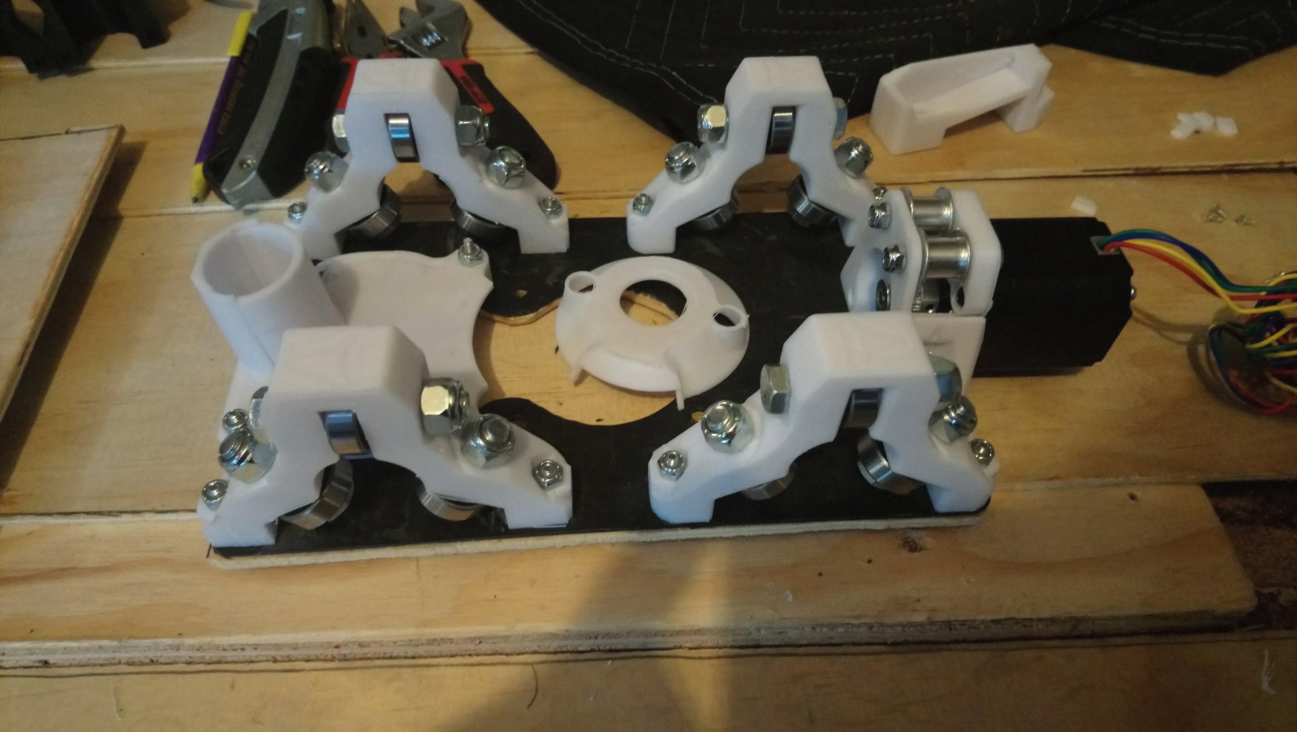

OK…here are the 3D printed flat parts…I made them all but reinforced them with 1/8" plywood. I glued them together with gorilla glue…These are my temporary flat parts until I can cut out the real one…might keep them on longer if they hold up to the stress or not.
What size are each of the parts? I could have sworn I looked at it and at least the router mount would have been able to fit on that size bed and the side pieces would have been pretty close if you rotated them 45 degrees.
