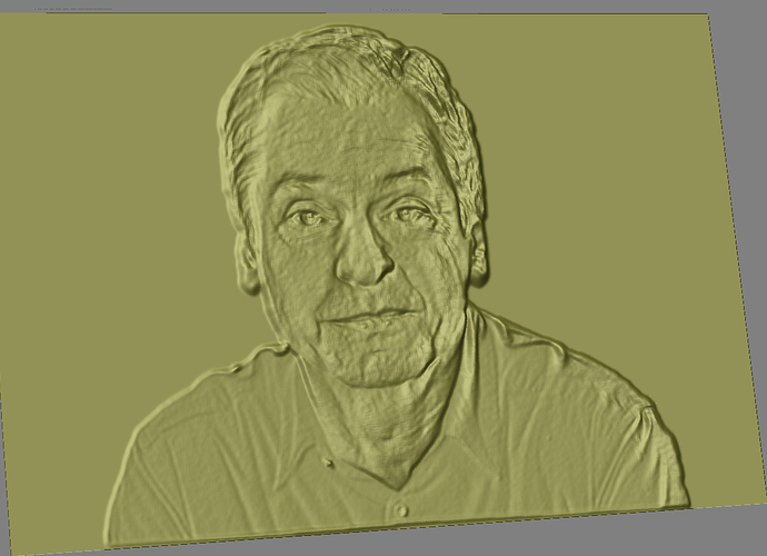

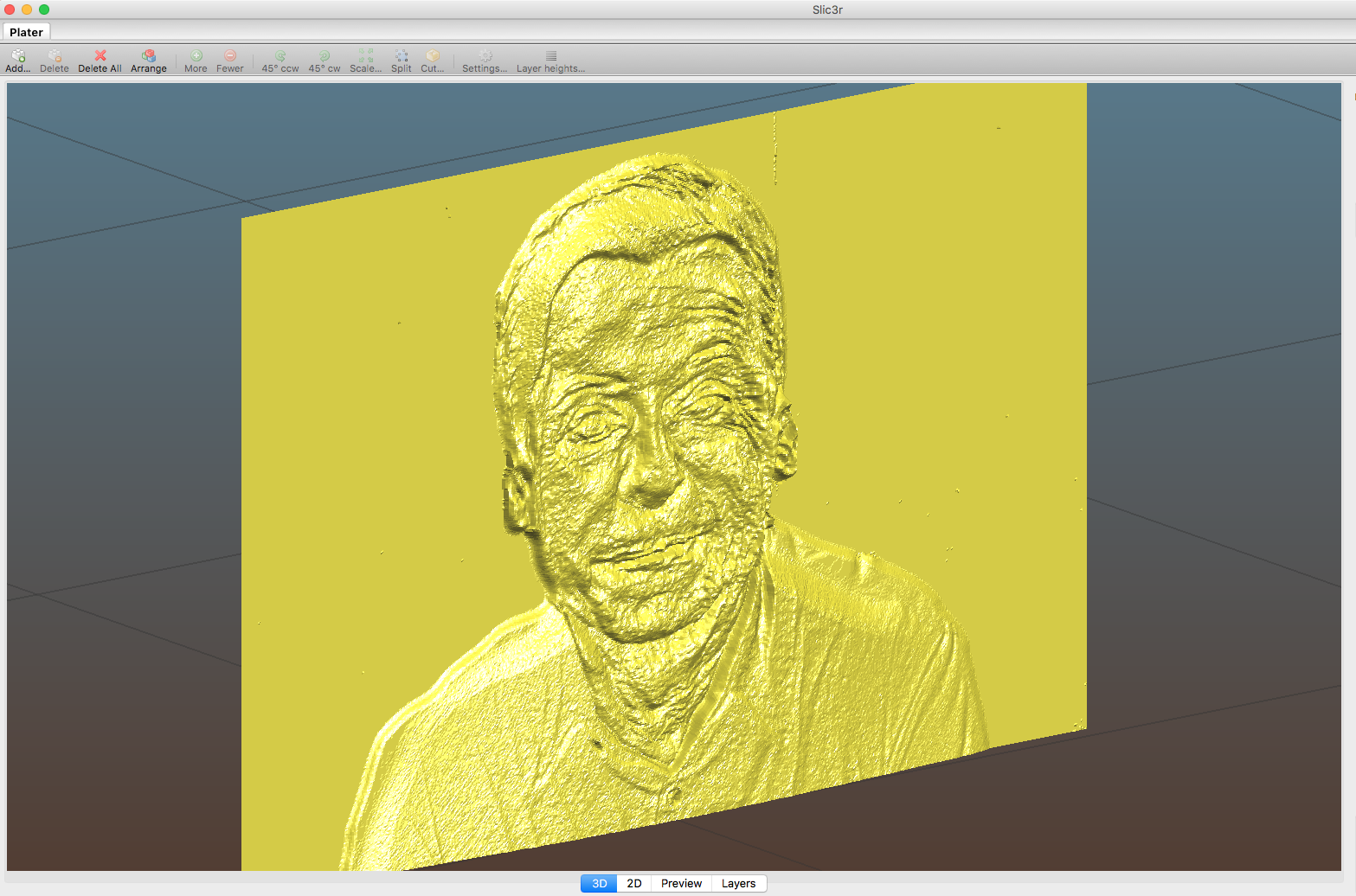

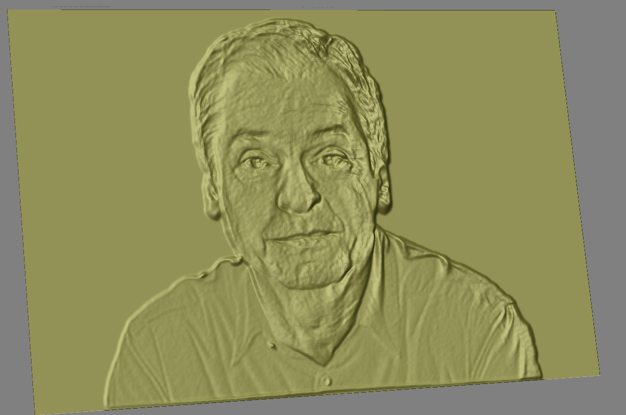

I DID however find one solution that is getting me darn close to where I want to be and I think if I keep at it I just might have it. It’s so, so close, I’m just losing a little too much detail in the process - but I think I can recover some of it post-process. This involves using the 3D mesh tools in Photoshop. The nice thing (for me anyway) is that I can watch in almost real-time as I make changes to the height map, how much farther I need to bring things forward or back.
Not sure who the dude is, hope he’s not some freak serial killer…it was just a random “portrait” I grabbed from the inter webs. This image is after about an hour of massaging through layer upon layer of adjustments. I think I’ll be able to streamline the process a bit once I fully wrap my head around this. I’m going to switch to a photo of my kids though - might as well have the effort going to something I actually want to unleash on the MPCNC.

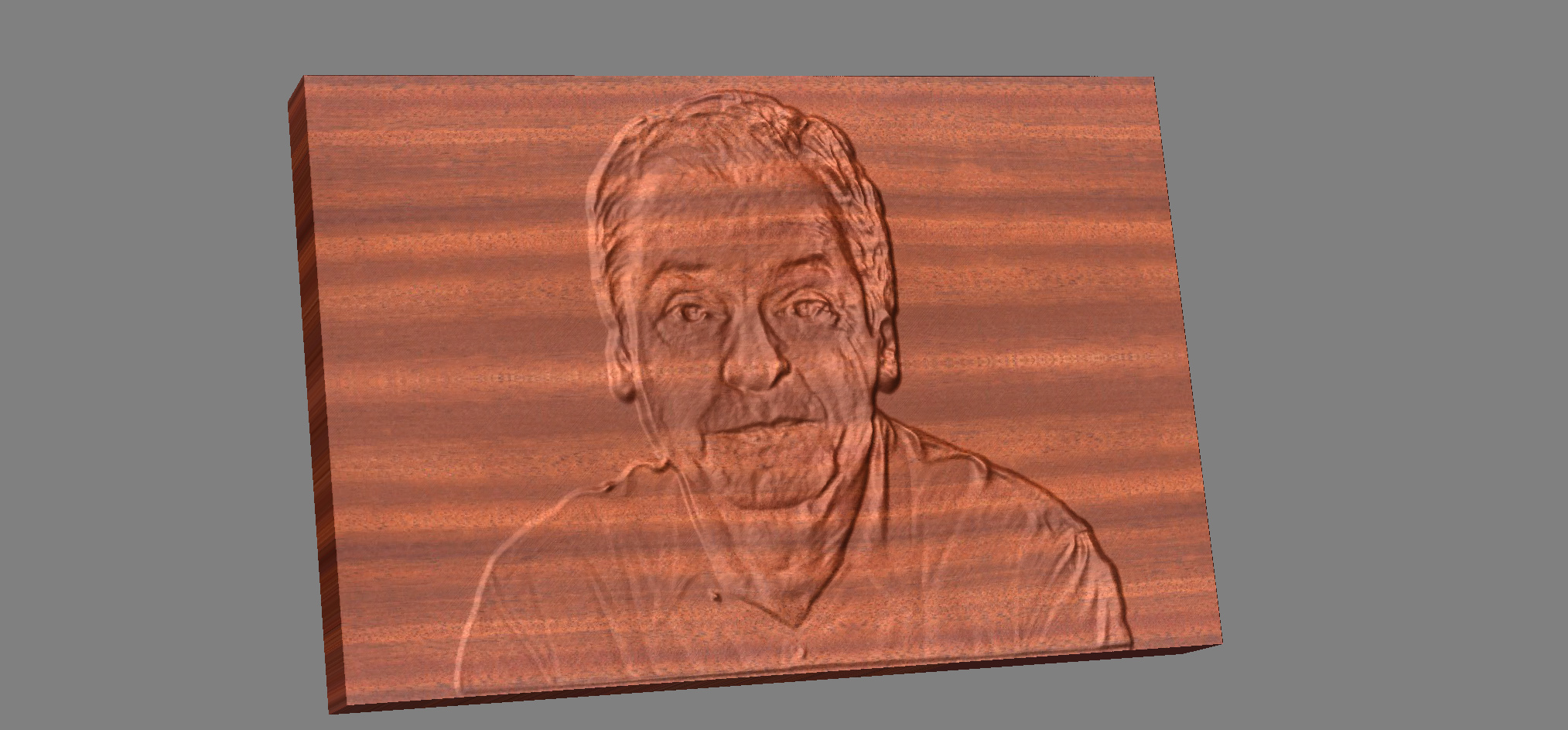

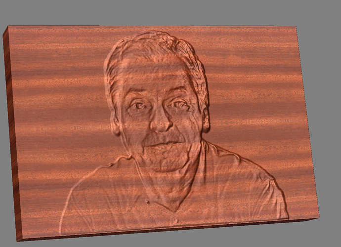

Carveco is bringing back something that looks very similar to artcam. Details on the 28th I think. This version might have what you’re looking for, hopefully they do a free version like artcam express.
here’s a quick experiment at work, never used that function of the modeling side, but works well enough. if I played more with the contrast and added a bit more smoothing, he probably won’t look like a 20+ year older version of himself, haha.
got a cloudflare error and the attachments look like they’re just showing the same thing so I’ll reupload just in case.
