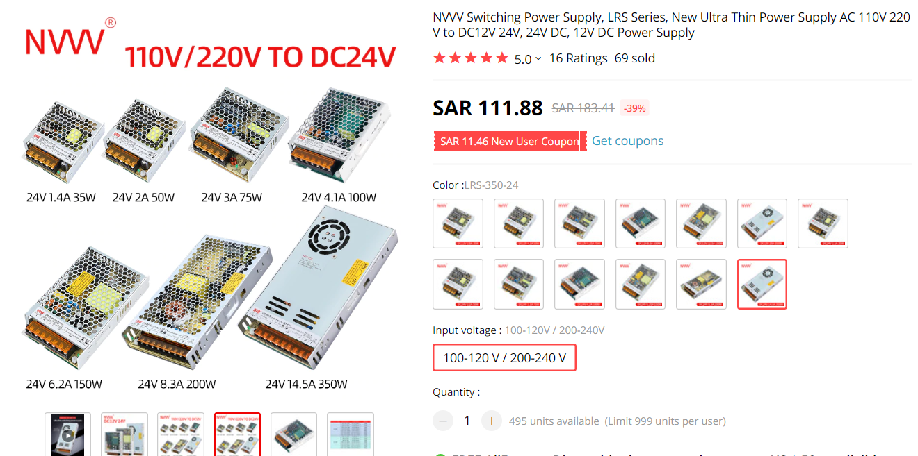

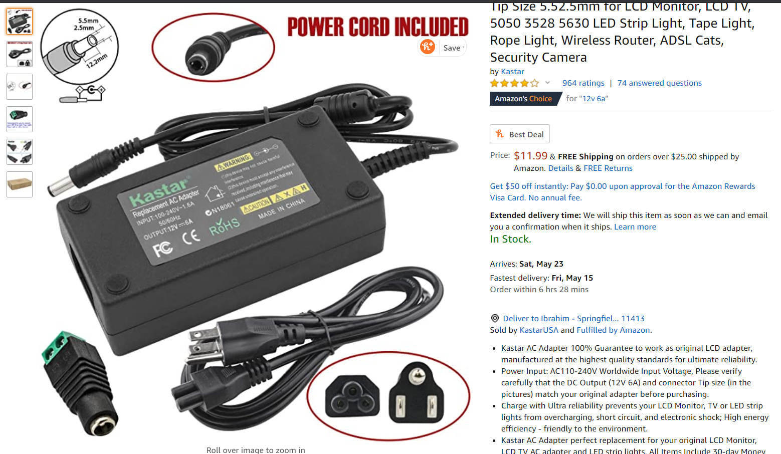

The Power supply.
Here in the parts page the power supply link looks like a Laptop charger and I don’t know if that’s strong enough to run a cnc machine, because none of the YouTube videos used it.
They use the metal box like the one below
What should I use ? And does the one above comes with wires ?

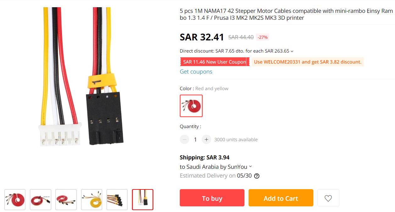

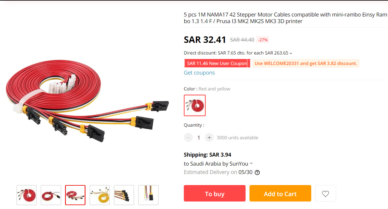

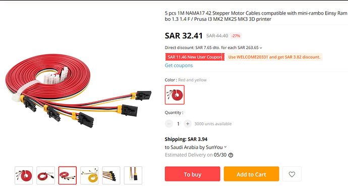

Second, the wires. Actually I don’t have an electrical back ground, so I searched for the one in this website but I couldn’t find it.
Is this good ?

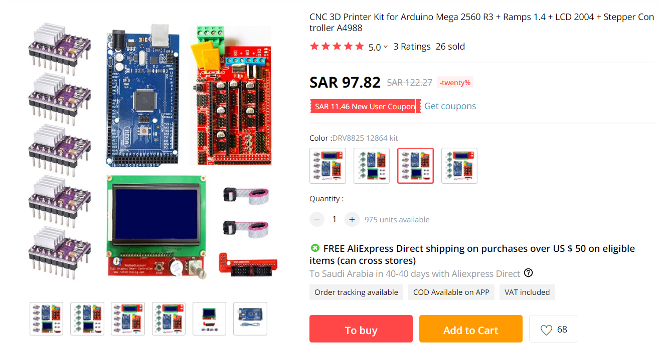

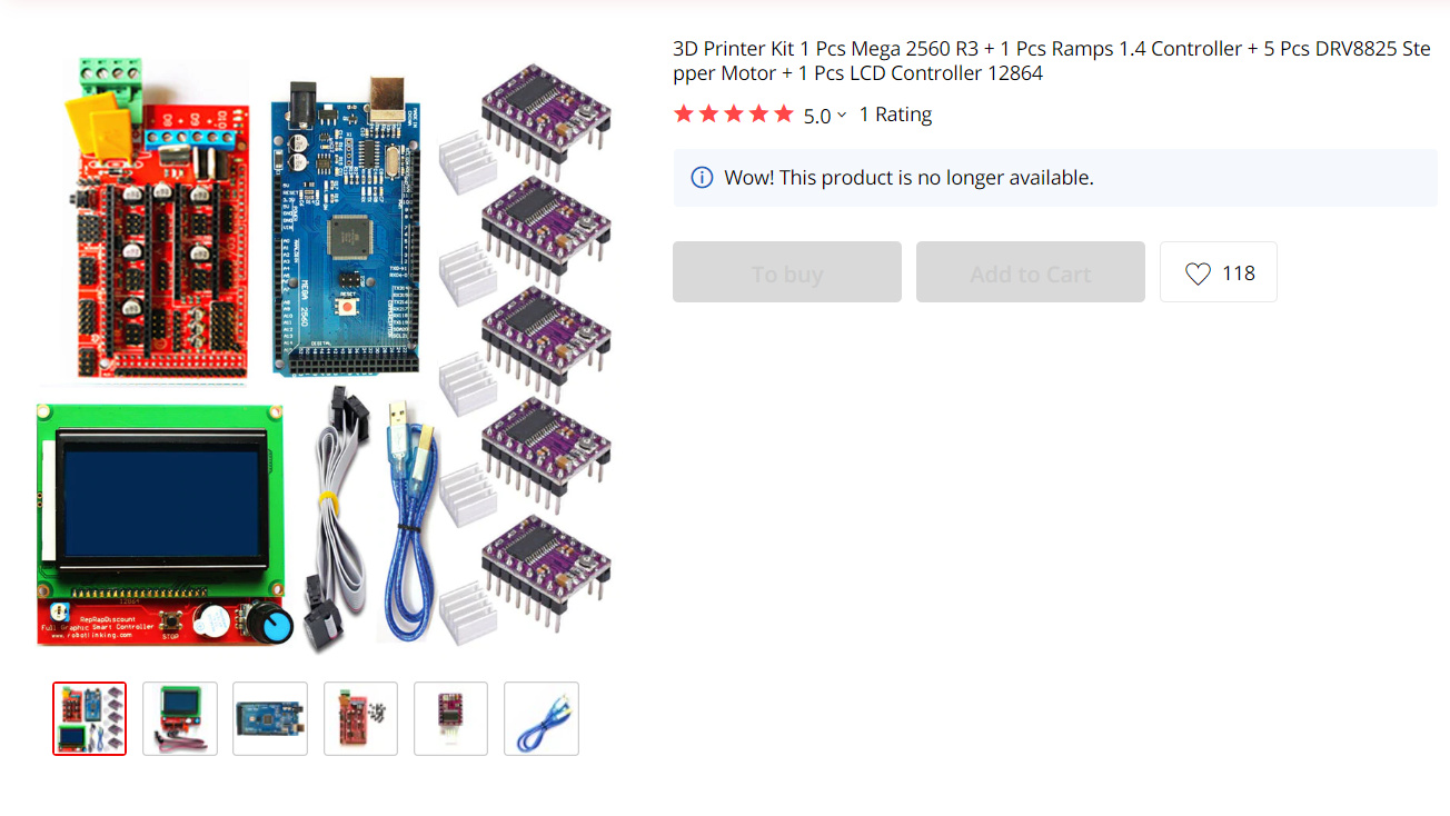

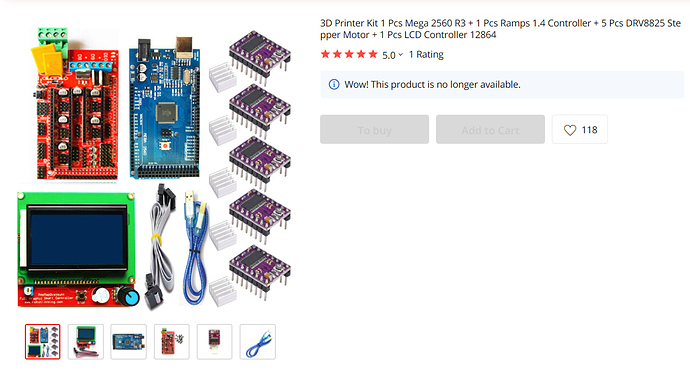

Lastly and most importantly the board. So I was planing to buy the kit but it is sold out sadly, so I saw an assembling video and the person used Arduino mega i think or something like that. The point is the put for the kit was also sold out.
This is it

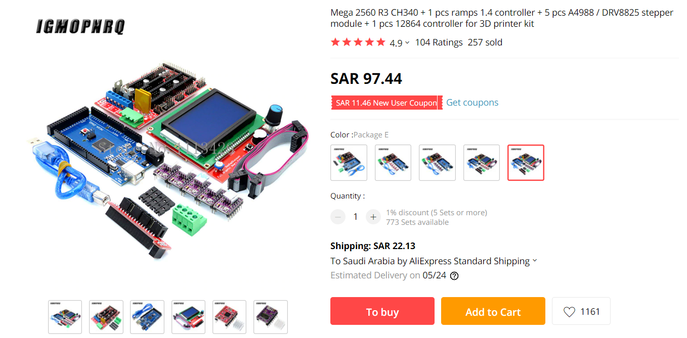

And these are the similar two kit I found. I need to make sure it is the same before buying it

The laptop style power supply is fine. It takes quite a lot of current to run a laptop, and surprisingly little to move these motors.
I’m not sure what you are asking for about the stepper motor cables. The important thing is the ends, and if you are wiring them in series or dual endstops (dual motor).
That is the RAMPS combo. They work fine. They are fragile though. The rambos Ryan sells are tougher to break, and they come flashed with his tested firmware. If there was one thing I would suggest buying from the store, it is the rambo. There are instructions for the ramps in the docs though, and there is information on flashing the arduino. It isn’t rocket surgery.

What do you mean by fragile? … Will I have to replace it sometime? … If yes, due to what?
My working space area is 1x1m do you think the wires comes with the Nema17 are enough?
If you go with the laptop power supply, throw that little adapter in the corner in the trash, cut the end off the DC supply cable, and use the bare wires directly.
The ramps board itself is fairly bullet proof, it’s the cloned arduino under it that’s the weak point. It’s fairly easy to cook the little 5v voltage regulator on it. It’s an easy fix if you can solder, but annoying. They’re also cheap, cheap parts, usually no qa, so sometimes you get them dead on arrival. I have a couple spairs now, just in case.
No, you’ll probably need longer wires.
