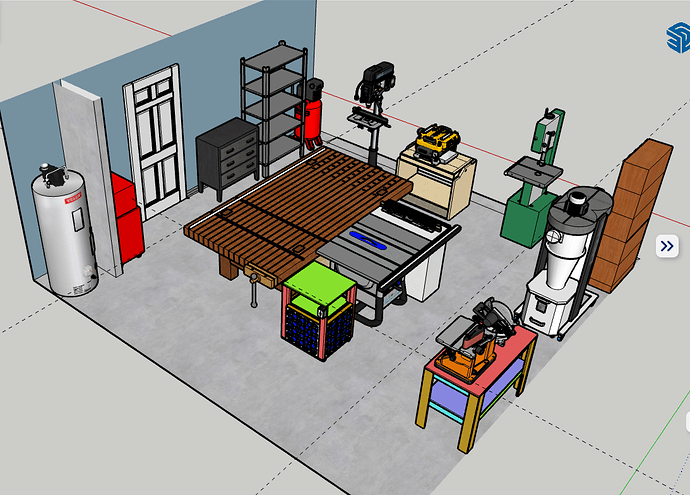

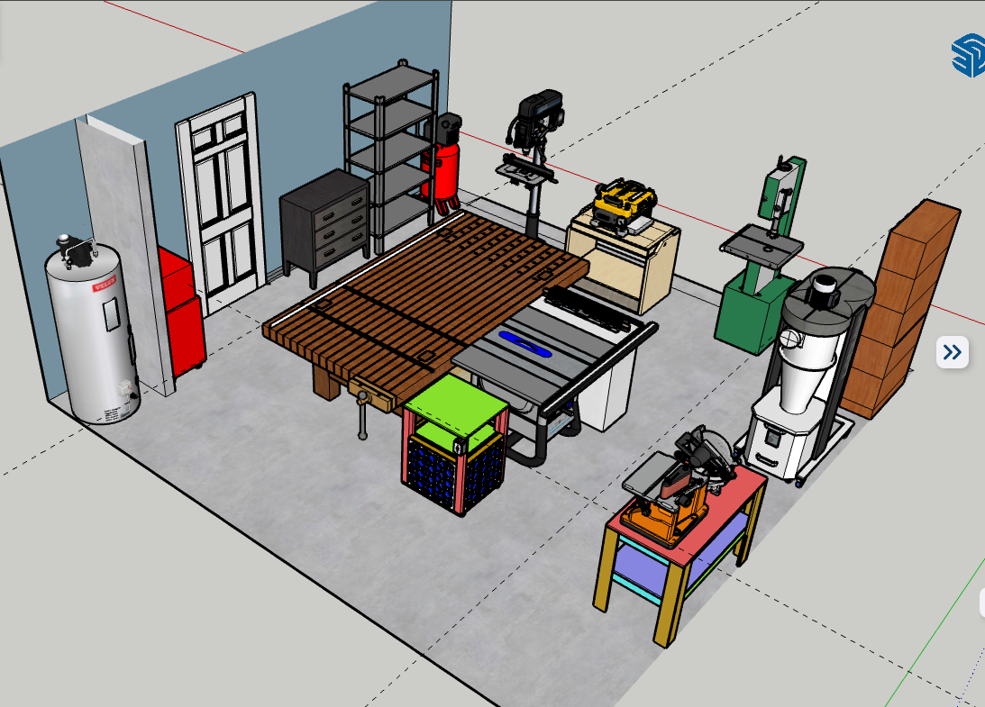

Here is a model of how my garage shop will be after I build the 9x5 workbench.

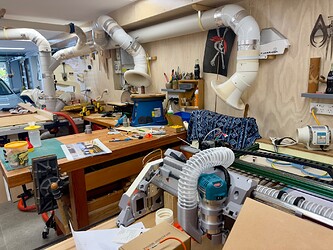

I have a 2.5HP dust collector - ducted with 6"PVC and drop down to 4" at all the gadgets and a secondary 90mm dropper to bandsaw and top of tablesaw.
Dust collection is good for collecting dust, if it’s set up well, particularly the nasty fine bits that do you harm.
This is why the machine is not visible - it’s in it’s own little lean-to cupboard OUTSIDE - where all the fine unfiltered bits don’t matter quite so much.
If you can manage a proper overhead setup and your system is working well through very short duct runs, a 4" system will work.
There are too many vagaries for me in that - so things like my LR, my sanders and hand tools are directly fed into the vac setup (the LR with a 2" system), and fine dust is mostly eliminated by 6" belmouths above the machine.
Not visible in the pic are two exhaust fans (8" from memory) which enable enough airchanges to more than meet any OH&S standard, and take care of all (most of) the microfine residual stuff. Yes it sounds excessive, but with a father and two brothers in law who have died from dust related lung illnesses and a wife who has her sewing setup separated by a two metre wide sliding door - it works for me! :wink:
