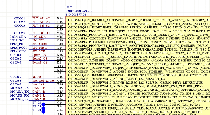

GPIO (general purpose input/output pins) is a term used usually with microcontrollers pins to provide distinction vs special purpose pins. In older microcontrollers it was common to have quite a few pins that were specific purpose such as ADC inputs only, DAC only, address and data lines for a parallel data bus, UART/SPI/I2C hardware, that kind of thing. In those cases the purposes of those pins are specific and defined entirely by the hardware that’s behind them. With the address/data lines you couldn’t tell the firmware ‘make A3 high’, or ‘pull D7 low’, that was all just done by the hardware controlling accessing external RAM. The GPIO pins on the other hand are general purpose in that they entirely rely on firmware to provide their functionality, not any kind of underlying hardware. The only way to change their state is have the firmware change a bit in a register somewhere.
As silicon has gotten cheaper and more complex, we’ve ended up with micros where every pin that isn’t a power pin is fed into a multiplexer such that we can switch the function of each pin between various bits of hardware peripheral or just keep it controlled via GPIO. In that example, if we leave the pin set to GPIO then its state is controlled by firmware via bits in the registers the same as before, but we can also reconfigure the multiplexer to instead say that this pin is being controlled by a hardware UART. We can then no longer just set that pin high or low but instead control it via the UART hardware. We put a byte into the UART input register and it then clocks it out the pin bit-by-bit at the correct rate etc.
So while the pin functionality can be exactly the same (capable of digital inputs between 0V and Vcc, capable of digital outputs between 0V and Vcc while both sourcing/sinking current), the GPIO label vs whatever its special purpose would denote how it’s being controlled. In a schematic, I typically label things at the microcontroller according to how the MUX is set. Something that’s GPIO will get a note saying GPIO27 or whatever then the netlabel describing the function. Something that’s using specific hardware will get a note saying EPWM8B or whatever then the netlabel describing the function. This is an example from a design I’ve been working on recently:
The nFault signals are all just GPIO with their states being read by software. Separately there is a global fault signal that isn’t GPIO controls the PWM hardware and triggers an interrupt. The I2C and SPI pins aren’t GPIO because they’re being controlled by that specific hardware. As you can see from the truly appalling pin names, the multiplexer in this case can connect the pin to a LOT of different peripherals, sometimes even connecting to things like a cross-bar (OUTPUTXBARx) which is basically just another multiplexer…
There are a few cases where this exact situation occurs on the chip itself. Some TI microcontrollers have pins that aren’t true GPIO, instead having an output that is open-drain and rated to a higher current than other pins. I can’t remember offhand what they’re called but it’s something like ODIO so rather than being general purpose IO it’s open-drain IO, signifying that it can’t be used the same way as GPIO because it’s an open-drain output. That open-drain nature means that it doesn’t have a switch to pull the pin high, only one to pull it low. Both GPIO and ODIO have the same inputs but in terms of output states the GPIO can be high impedance, low impedance Vcc or low impedance 0V. The ODIO can only be high impedance or low impedance Vcc, the lack of a high side switch means it can’t output a high voltage directly and needs an external pull-up. The advantage there being that for a 3.3V chip, that output can be used up to 5.5V because there’s no high-side switch with its corresponding body diode.
So typically I’d only use GPIO as a term when it comes to the chip itself and maybe to buffered/filtered GPIO that I was routing out to the wider world. If I were doing something like changing them to be an open-drain output, as above, I would no longer consider them GPIO because they’re not inputs anymore, so GPO at best, and they’re not general purpose because that could be misleading. They’re open-drain outputs.
In terms of that specific documentation, I don’t like ‘line level’ as a terminology. It’s not really well defined and would be confusing. I would call out a specific voltage range instead.
Fundamentally some of this is just an argument about nomenclature and whether ‘common usage’ trumps ‘literal meaning’. I generally try to not to be a purist about this and think about the goal of the language we use. The goal is to convey a certain meaning and sometimes the most literal approach doesn’t do that without adding ambiguity. Calling it GPIO isn’t fine under any circumstances because it’s factually incorrect, there is no input capability. Calling it a GPO is fine in the literal sense in that it’s an output that is intended to be general purpose in the CNC machine context, but I would say that’s not correct in the microcontroller/electronic context in that it’s not general purpose, it’s specific purpose (high current, open drain) compared to other situations where we would call something general purpose (low to moderate current, tri-state).
