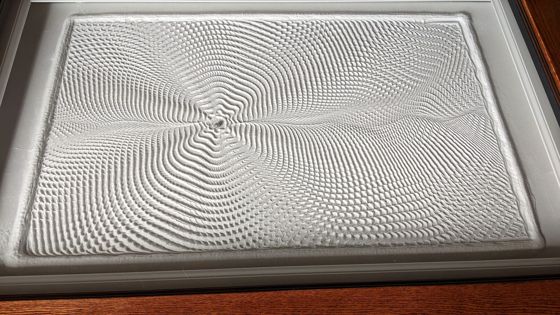

220831_01
; Created by Sandify
; https://sandify.org
; Version: 0.2.6
; Machine type: Rectangular
; Min X (mm): 0
; Max X (mm): 590
; Min Y (mm): 0
; Max Y (mm): 980
; Content type: shape
; Layer:
; Shape: Web
; Name: polygon
; Large circle radius: 14
; Small circle radius: 21
; Visible: true
; Initial width: 2000
; Initial height: 2000
; X offset: 8
; Y offset: -135
; Rotate (degrees): 90
; Reverse path: false
; Number of loops: 125
; When transforming shape: smear
; Scale: true
; Scale (+/-): -0.8
; Scale by: constant
; Spin: true
; Spin (+/-): 2.7
; Spin by: function
; Spin function (i): sin(i/5)*sin(i/10)
; Track: true
; Track size: 12
; Track length: 2999.9
; Number of loops at each track position: 1
; Scale track: false
; Fine tuning:
; Connect to next layer: line
; Draw portion of path (%): 100
; Backtrack at end (%): 0
; Rotate starting point (%): 0
; Reverse export path: false
; File name: ‘220831_01’
; File type: gcode
