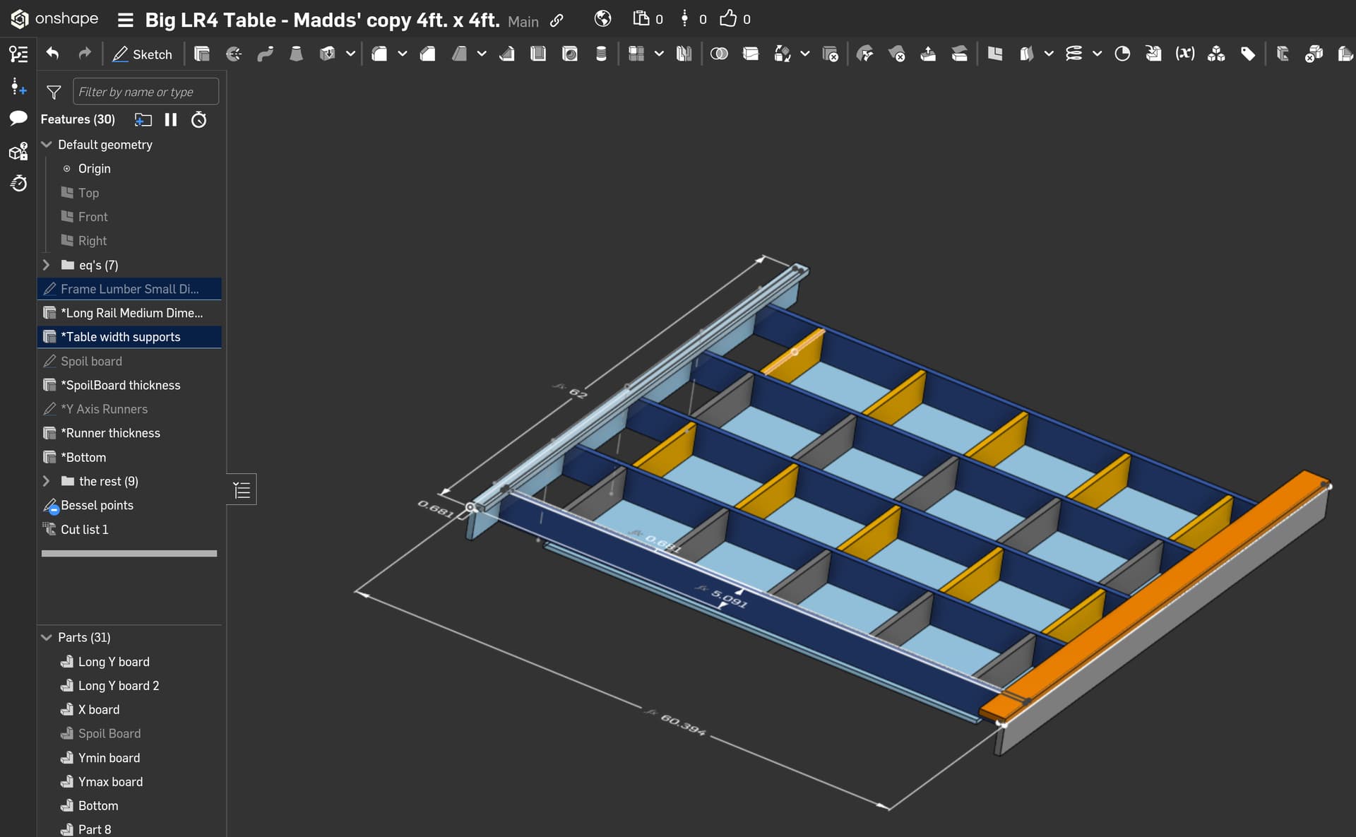

I opened the CAD file, and the top sheet is reading 49x98 inches. Is the file scale off, or did I do something wrong?
If you go to the hardware store and measure a full sheet, it’s usually around this size.
Sheets of MDF are typically 49x97.

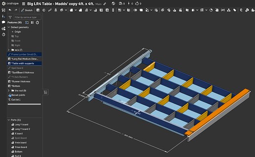

I know this is more of an Onshape question than a table question, but since I’m referring to the design above…does anyone have any tips on actually getting the measurements or a BOM out of this thing? I have modified the table to be 4 ft. x 4 ft. in my copy of the drawing, but I can’t seem to get dimensions anywhere.
What I’ve tried so far:
  1. If I do Rclick+show dimensions (or select all and double-Lclick) it only shows some of the broad dimensions for the table, not all. Like overall width and length but not height, for instance. I don’t even care about in. vs. mm, I’d just take “units” or whatever.

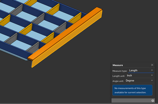

  2. If I click on an individual part and use the measuring tape in the bottom-right I can only see surface area, not dimensions like Length (says “No measurements of this type available for current selection”).

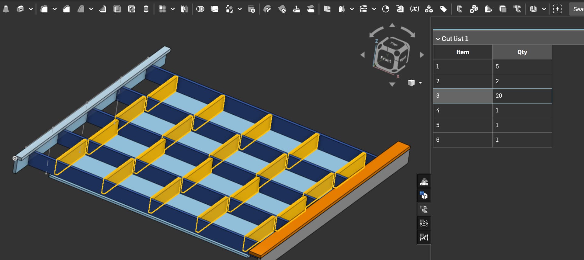

  3. If I use the Cut List tool I get a listing of the repeated parts (i.e. qty. 20 vertical torsion box braces and qty. 5 horizontal braces) but not their dimensions.
I feel like I must be doing something wrong? Figured here someone might know. Onshape is pretty neat and I imagine this won’t be my last time using it since it makes designs so easy to share.

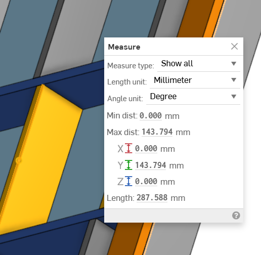

I had some of the same issues. For me it was the layers. This is the measuring tool I was using on the display,
But when I clicked the item it often got the layer above it. I had to figure out how to Display or Hide some items to get the measurements of others. ‘the rest’ folder had most of the parts I needed to show or hide to get this.

To use the cutlist, you have to use the ‘frame’ generator tool in Onshape, which is not super-intuitive.

  1. use the measure tool, and make sure you click edges or points.

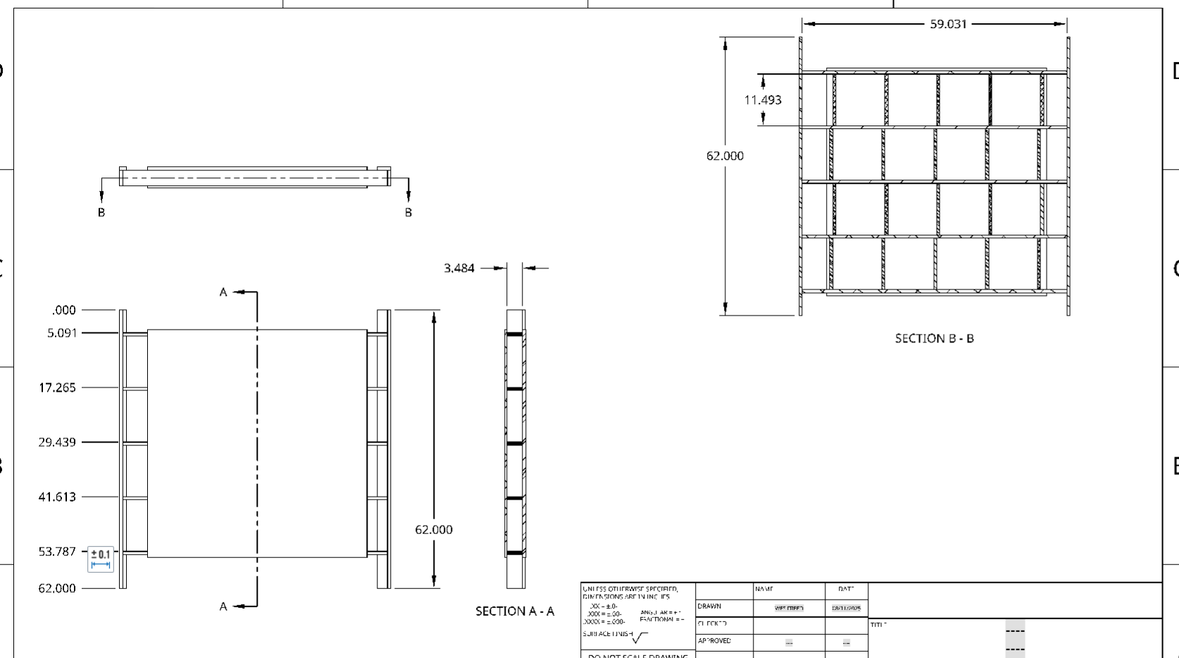

  3. Make a drawing. This is usually what I will do. Make a top level drawing and pull whatever dimensions you need. See below (this is a terrible drawing which is quick and dirty, but for this purpose it works)
