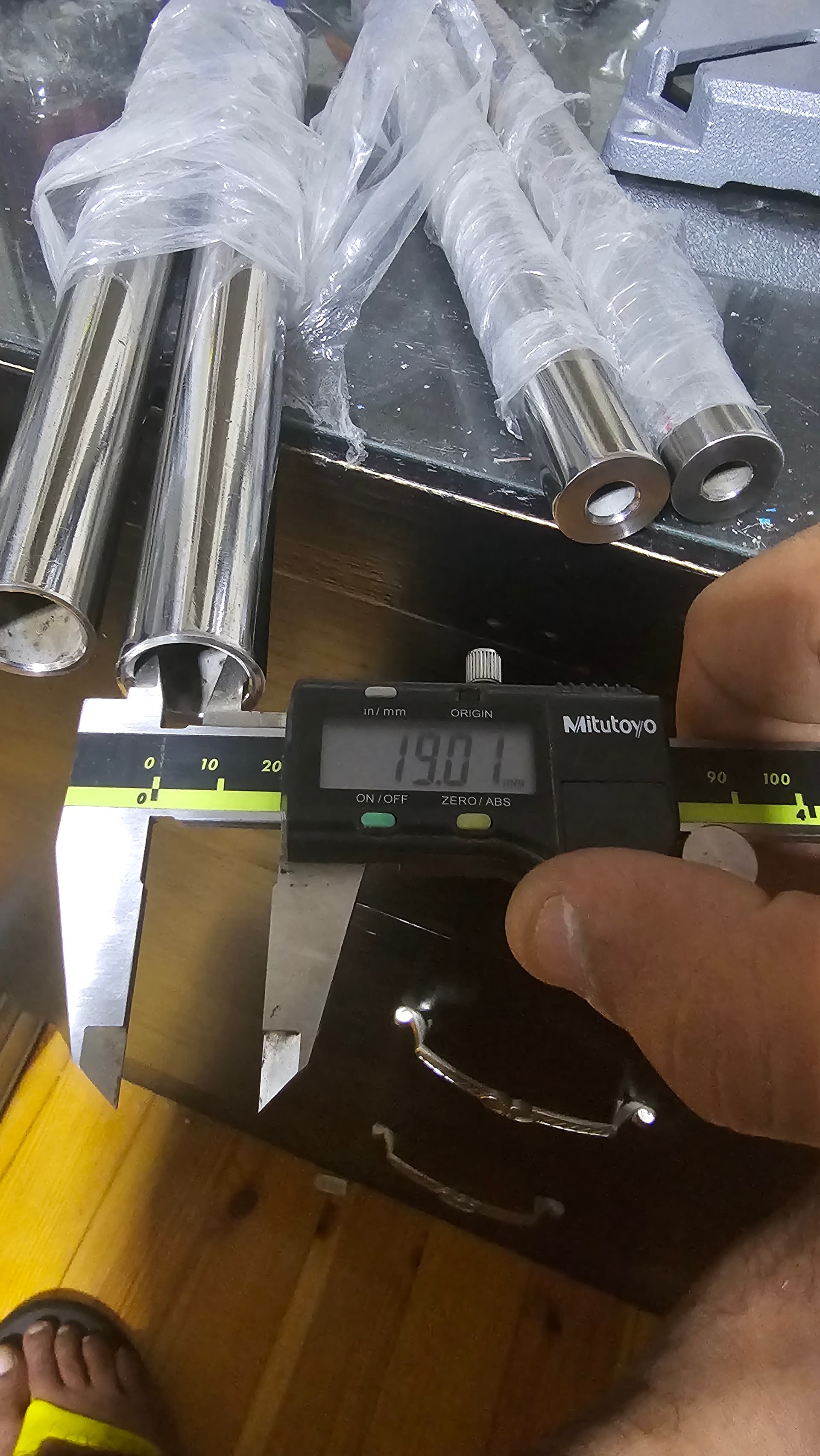

For almost the last 2 years i have been hording parts for my MPCNC build , and the last of them is tubing and i have sourced stainless steel from a friends company and it was cut and polished to perfection, the current problem is in regards to the printend parts since my stainless steel (od 24 mm) so i dont know which in the 3 sizes of printed parts will be suitable, secondly after going through the build manual i have found the the z tubes need more id for the nut trap printed part so i had my friend to cut me 2 extra tubes for z but this time its 25 od and 19mm id , so what size of printed parts fits snuggle the 24mm tubing and should i print the core in 25mm size to accommodate the z tubes and the rest for the heavy duty 24 od tubes, sorry for the long post but im really lost ,
That is the 24 od , 10mm id tubing
The is the z tubes od 25 id 19

Thanks for your reply, and i have figured it out in regards to z so thats why i have those 2 tubes cut off 25mm od 19mm id (also for the nut trap print) and lower Wight (around 1.5kg) including a 52m spindle , but the rest of the 6 tubes i would have to figure out an appropriate 3d printed size to accommodate them since the stainless steel costed me little more than i can easily recut , so what size would work with the 24mm tubing , and also i think the Wight for the structural 6 tubes will help in the rigidity of the frame
