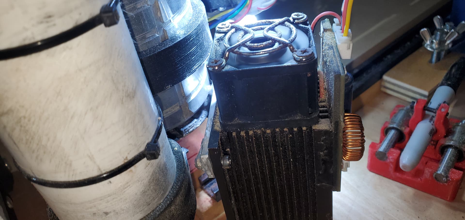

Need some help with laser setup
Before I jump down the rabbit hole of the electronics, is there any reason you want to use the 12V fan pin to drive your laser? There are quality issues with using fan pins and M106/M107 to control the laser, and there are better ways for most uses. It looks like you are using a Rambo board. Assuming you are using a later version of V1 maintained, Marlin firmware, laser support is enabled. Pin 45 is the 5V PWM pin used for that support:

On to the fan pins. Most PWM pins work by turning VCC on and off. The fan pins are set up so that the ground connection is turned on and off. On the forum it is referred to as ground-side switching. A high percentage of laser modules, regardless of the voltage, just won’t work with a ground-side switching signal. In order for it to even have a chance of working, your control board and your laser module would need separate power supplies.
If you want to try and use the fan pin, there is a simpler way than a voltage divider circuit. Since the fan pins use ground-side switching, you can pull the power from any 5V pin on the board and just connect the ground connection to the ground pin of the fan connection. The ground connection to the fan ground must be the only ground connection between the two boards.
I was unaware of the M03 I I tried with voltmeter on pin 45 was getting nothing. so I figure I would try and do it the way I did before. Truthfully little intimidated on editing firmware as everything else is working awesome. I tried asking if anyone had the firmware with Laser already enable but did not see any responses. I will test pin 45 with the M03 I now .

I only have a moment for a reply, but try testing some pins (44, 45, and 46) with M42. M42 is not laser dependent, so you should be able to set the PWM and see the “correct” voltage. This will test the wiring, pins, hookup, etc.
As time permits, I’ll gladly stay with this topic until you get it figured out. Lots of people have used unmodified, V1 firmware and pin 45 to drive their laser, so there is something different in your configuration. And if you happen to figure out the issue, I’d love to know the root of the problem.
LOOKS LIKE ITS WORKING PIN 46 !!!
Using M42 P46 S0 to S255
was even able to set some emergency Codes in my REPEATER-SERVER to set laser to M42 P46 S5 on Reset / Pause / Startup just to make sure laser dos not burn anything up on startup or FULL stop command.
Thank you for your Help !!!
I plan on eventually getting new Laser this one is pretty beat up has a lot of hours on it :frowning:
If you want your laser to work with the Marlin laser code, you need to either 1) get pin 45 working, or you need to change the pin assigned to the laser to 46. I just tested M42 on my laser pin (45), and it worked, so you should be able to see if you have a bad pin 45. If you need to reassign laser support to pin 46, I can show you where to make the firmware change.

I have new NJE E40 LASER SETUP on pin 45… when I try to cut out something it dos fine if it’s a nice e long outline but center pieces the laser turns off… I tried running light burn bridge on my PI but it looks like it wants a eithernet connection to Rambo board witch of course dos not exist. Not sure what I am doing wrong generating Gcode.
I would love to use light burn I may just have to break down and use a USB cable
I’m not sure where you are having a problem. Please upload your g-code file, or if it is too big, just the first 100 lines. So, are you running Lightburn off an SD card? If so, I doubt using a USB cable will fix the problem. I run Lightburn files off a SD card using my Rambo board with no issues. Do you have Inline commands selected in Basic Settings?
Inline was not enabled I just found the settings I have a PI running connected to my Rambo Its just like octiprint I upload the job to the PI’s web server and run it. I do have the option of using SD may just go that route I just changed to thease settings testing now
