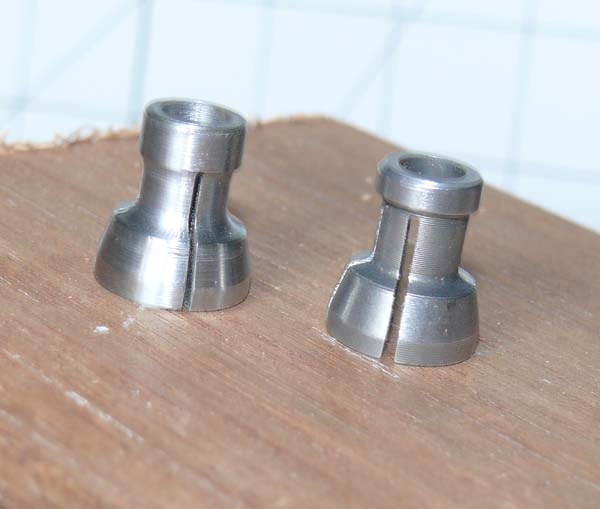

Do you know of anyone with a lathe and mill. (Model engineer maybe)
The one on the left I made.
Please note I would not like to supply anyone with one because ideally it should be hardened, although it is made of high carbon steel, the first one I made cracked on quenching so this is not hardened, my risk.

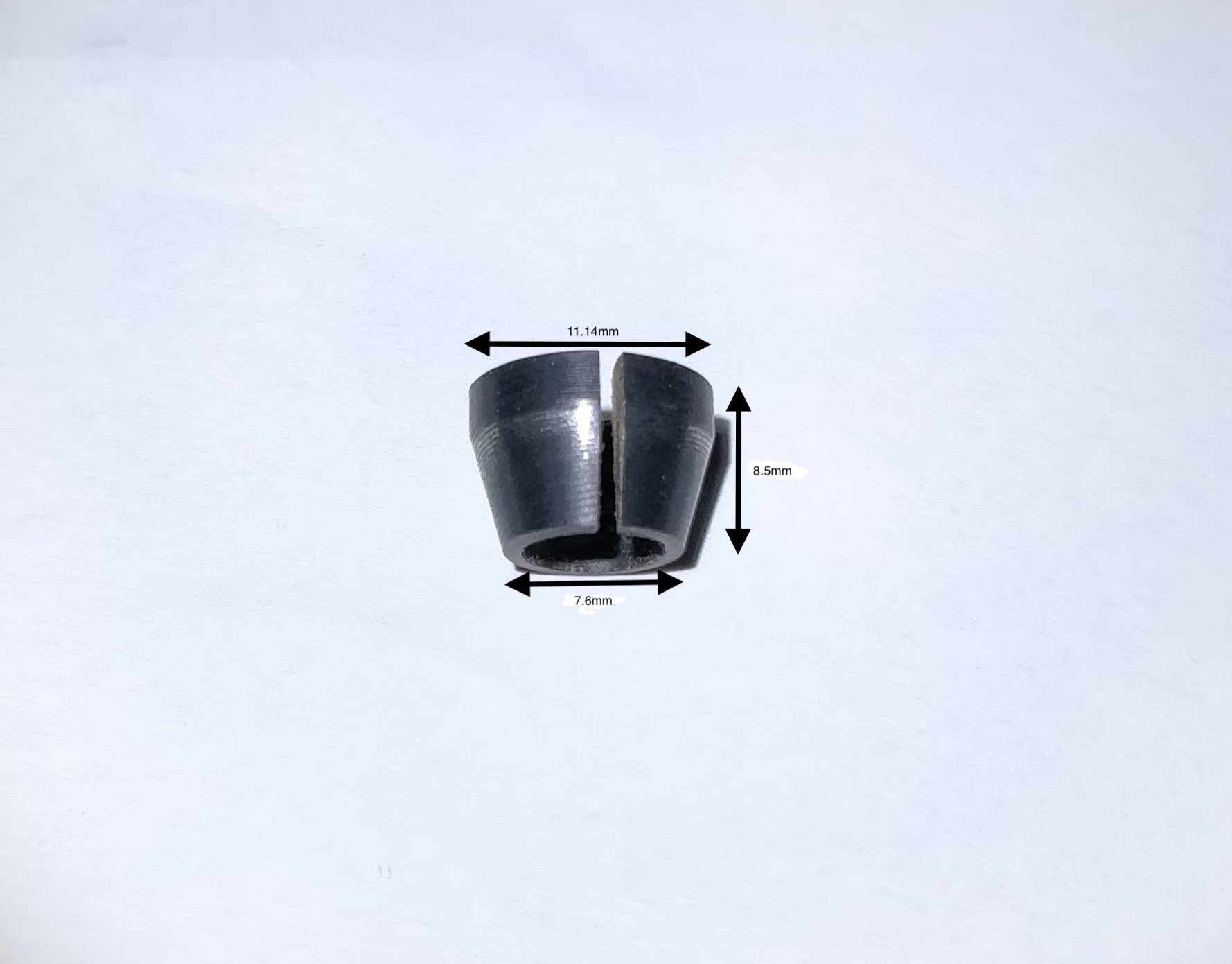

Just a thought, would the Makita collets fit ?
I am not sure, do you have a link to some examples or the dimensions?

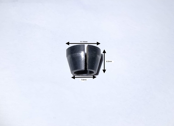

My collet is 11.14mm at the fattest point, 8.5mm at the thinest point and 7.6mm tall - [attachment file=71266]
We need someone with a Makita to measure their collets.
The angle of the taper is the most important factor, 16 degrees on the Katsu.
Measuring the best I can it looks to be 16 degrees.
Taking another crack at the search I found http://www2.aimtools.co.uk/3pcs-set-trimmer-collet-chuck.html which looks to provide the 6mm collet I want, will see what happens when I try to order it.
Collet only has one slit? I wonder what kind of TIR that manages.
it wont be as good and even slits but it should still centre on the taper.
