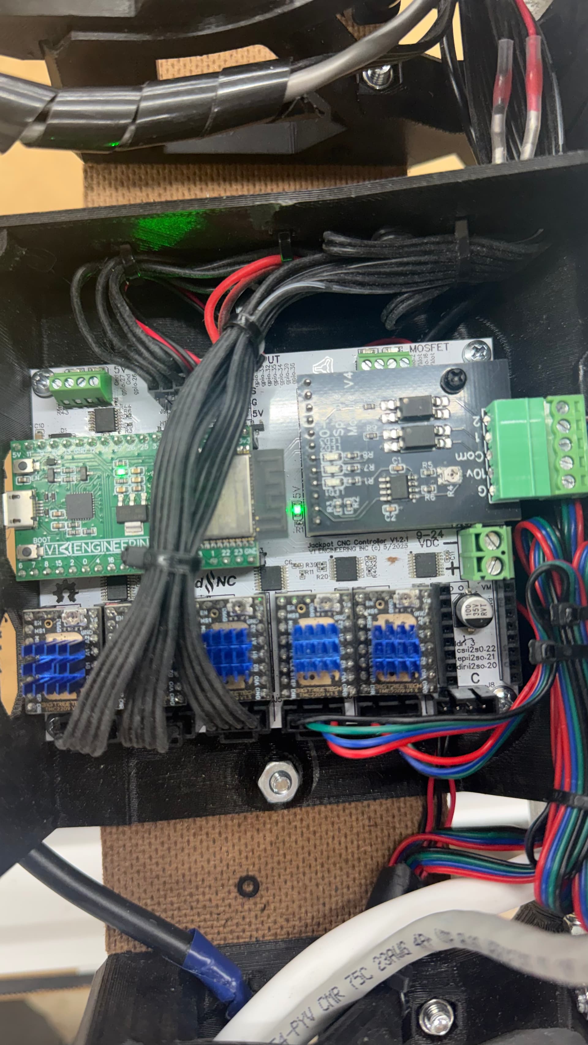

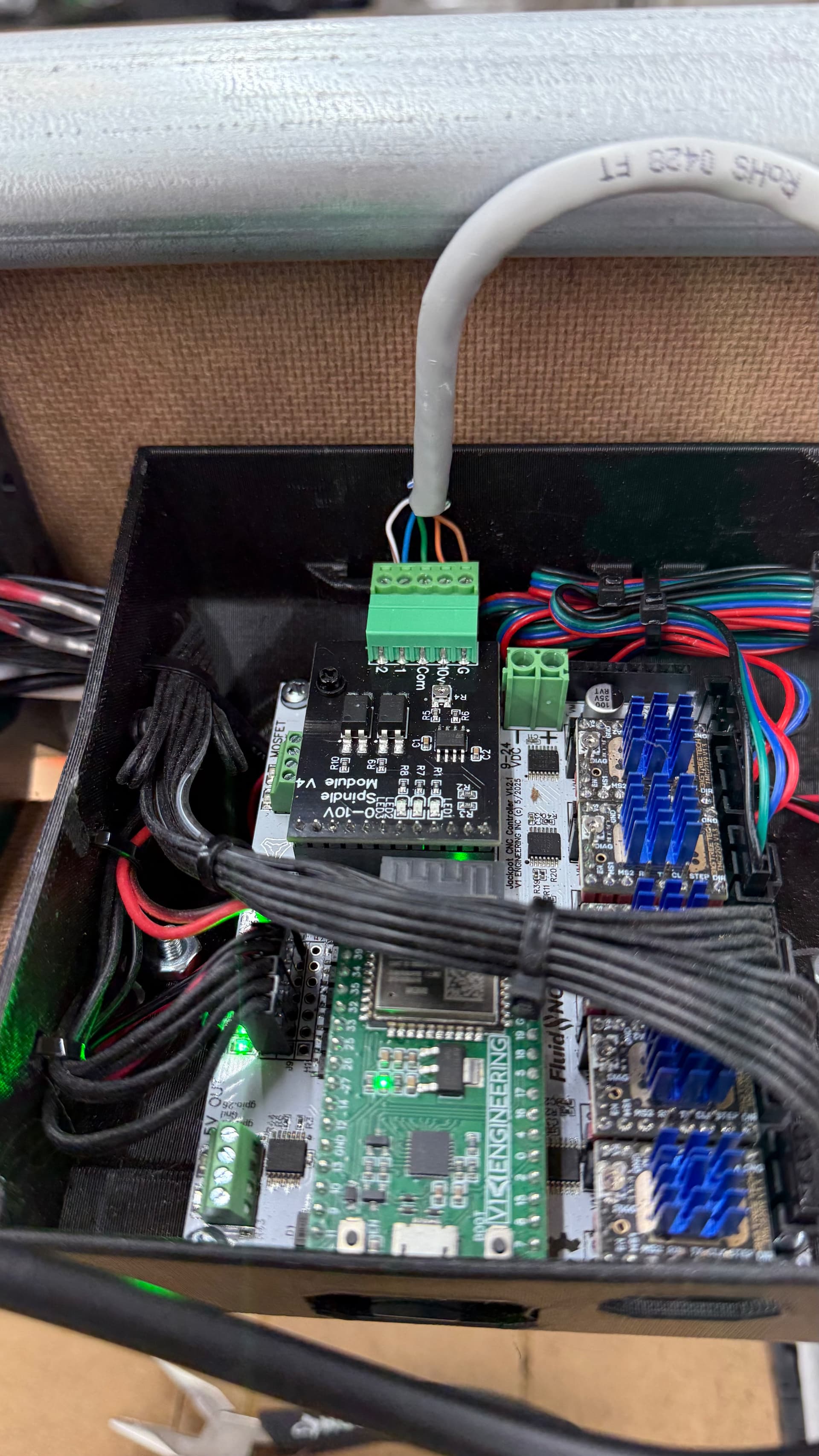

I recently finished my LR v4 build and things are great. I am using a spindle and it was working great when I have the VFD and Spindle controlled through the VFD.
After some reading, I decided to try and control the VFD and spindle by using the control board and a 0-10v I/O cnc module. I kind of got everything working, kinda. Unfortunately I am not getting full rpm when I am expecting it to.
Reading through ALOT of information regarding the wiring and VFD setup, I believe I have things correct, but obviously I am missing something.
My first question is, am I supposed to see 10v when measuring the 0-10v terminal on the i/o module? (I do see the voltage change as I change the requested rpm in FluidNC)
Here are some reference pictures.

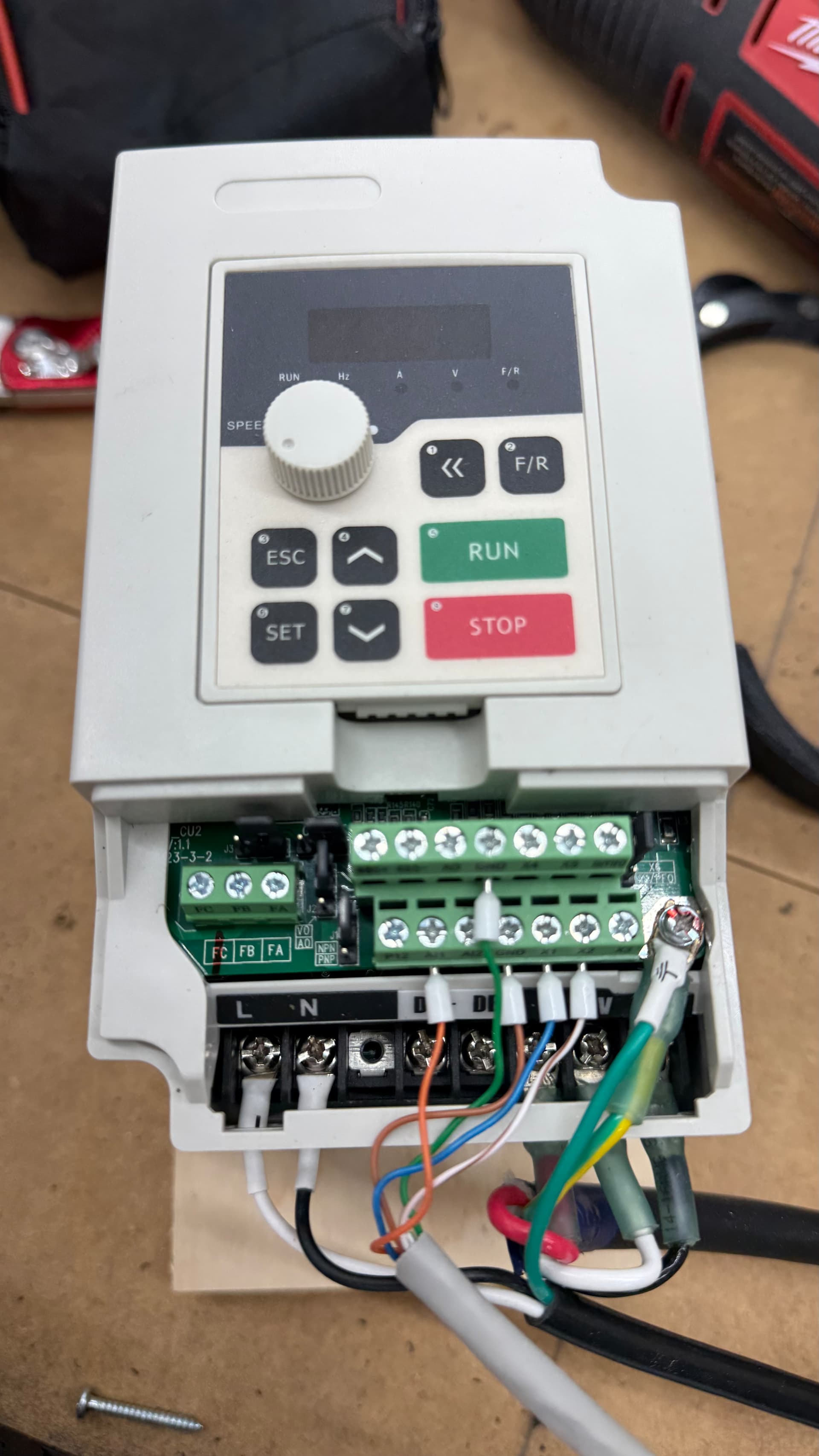

And this is my VFD and spindle.
good Job, did you fine tune the voltage on the pot meter on the i/o board?
I wish it was a good job. I am not able to get the full 10v out of the add on module. I have read a number of threads mentioning the “pot” at you did.
I have no idea what and where that is. Do you?
Never mind, I realized I have been looking at the “pot” the entire time. I was able to adjust it and now I am seeing the 10v and 24000 rpm. YEAH!

Ok so I am using the H100-1.5c2-1b.
When I command 12000 rpm I get 9649 on the VFD. The 01-10v terminal registers 3.49v
Also, should I be checking with my multimeter by connecting the negative to the negative on the jackpot board?
