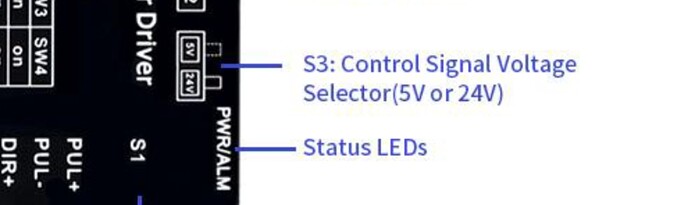

Oh, other question. Do you have the signal input set to 5V or 24V?
Proceed carefully with this switch. They put it at 24V by default because if you have a microcontroller that emits pulses and control signals (dir and ena) that are greater than 5V, this would blow the controller if it is set to 5V. I would measure the actual voltage of your control signals with an oscilloscope and set it accordingly. I am using a Teensy microcontroller that emits 3.3V signals which seem to work with the 5V setting.
Okay. I think the TB6600 are using 5V as well. If I set it to 24V but my controller is only sending 5V they just won’t move, right?
So I could start with that and flip the switch if it doesn’t move? :sweat_smile:

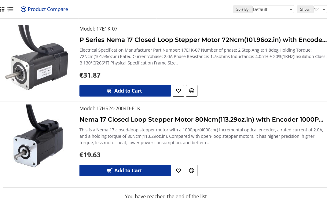

Okay, I have yet again another question: if I bought the kit above I’d pay a lot of shipping and taxes. I can buy nearly the same kit (a bit better) directly from stepperonline on Amazon but there are no extension cords. Can I just cut the connectors and crimp the cables normally, or would I destroy something doing that?
Cheers again! :slight_smile:
Also, I don’t understand the price difference, the one being the “P-Series”…
Those look like just the stepper motor. You need a matched CL controller. Amazon: BEWARE of fakes. It is worth getting from Stepperonline directly. I make all my own cables, using shielded cabling. Old VGA monitor cables are good for the encoder. You need 1mm copper for the stepper motor phases, though. If you are good at soldering and crimping, make your own.
I know, but the Nema 17 set (stepper driver and stepper motor) is not sold by Stepperonline in Germany, it only ships from China and with customs it would be really, really expensive. So I opted to buy the stepper and driver as single purchases. The drawback: it does not have the extension cords, hence the question whether I can just snip the plugs and use “normal” cables.
I am not good at soldering, I’d just crimp the wires after cutting them. :stuck_out_tongue: The VGA-cable tip is great, though, I still have lots of them. :slight_smile:
